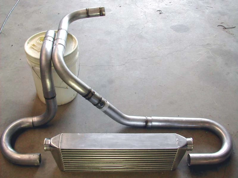

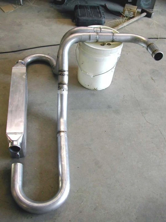

I'm gauging interest in a "bolt in" FMIC kit for Mustangs/TC's.
This kit would allow use of the stock Radiator and fan setup...that should save a fair amount of money and work over the NPR's and such...The intercooler will mount in front of the radiator support down low and be large enough to flow the air for 450+hp with a pressure drop of .5psi or less at 15psi. The core would be somewhere around 21x12x3.5" with a 2.5" inlet/outlet.
IC tubing would be 2.5" aluminized tubing that's mandrel bent. There would be no welds in the tubing. The ends of the tubing would have a rolled bead so they wouldn't blow apart under high pressures.
I would have kit for "stock" configurations, as well as one for my center mount header setup.
I could offer this kit three different ways, which would you prefer?
1) Intercooler and Tubing, no couplers or clamps
2) IC, Tubing, Couplers, no clamps
3) IC, Tubing, Couplers, & Clamps
I would like to use black rubber couplers with worm gear clamps as I've had great luck with them, I suppose I could offer silicone stuff with T-bolt clamps for an elevated price if there was enough demand. I'll need your opinions on this.
What do you guys think a fair price for this kit would be? The price you are willing to pay will decide whether I do this or not...
The kit would look similar to this one, only the IC would be ~30% larger and the tubing wouldn't have any welds:
As a second option, I'll have IC tubing for NPR and Volvo IC's in a few weeks...
