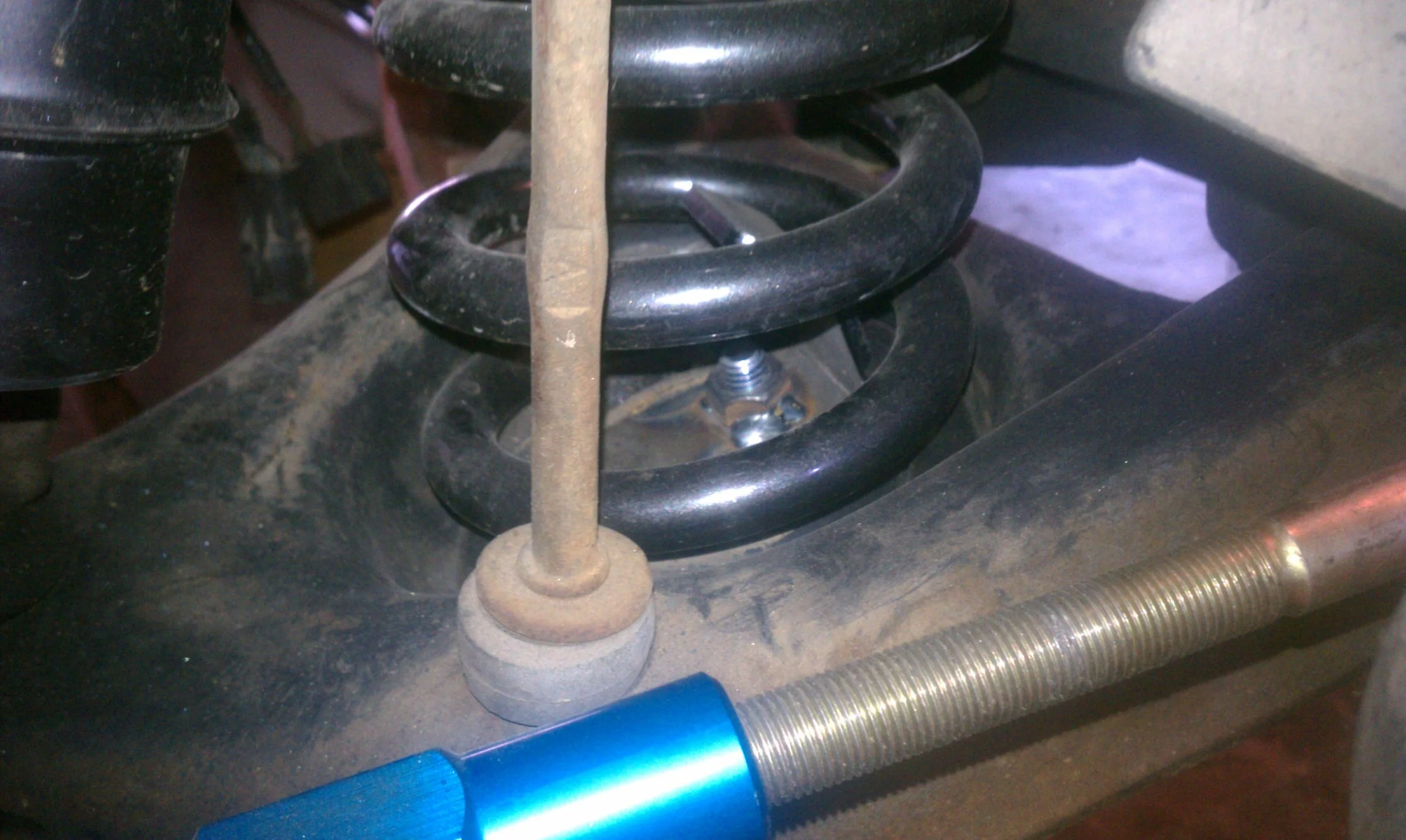

do yourself a favor and spend $20 and buy the max motorsports spring tool. It holds the spring in place in the A arm so you can jack it up and not have to worry about it popping out.

I have the MM spring tool too. It keeps the bottom of the spring in place because the bottom of the spring likes to pop out during install. You still want to use both the MM tool and a pair of spring compressors to make life easier. I've done it with only the MM tool and a 3ft pry bar on top of the spring which works too.
I've done this many many times and now I'm happy to say I have Maximum Motorsports coil overs and will never have to deal with those frickin springs again!!!

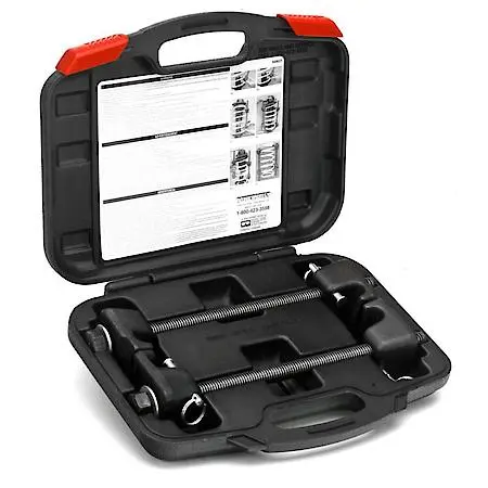

FoxMustangLvr, Which type of spring compressor do you recommend? I included a pic of the three types I can rent locally in Las Vegas.
The bottom pic is the one i'd use. I prefer to use the external type with locking pins. Honestly mine do not have the safety pins which is always a risk but I've used them dozens of times without issue. The only time I didn't feel safe with my spring compressors was when I tried to use them on my F-150 springs when I installed my adjustable Bilsteins. I ended up outsourcing that job to a shop.

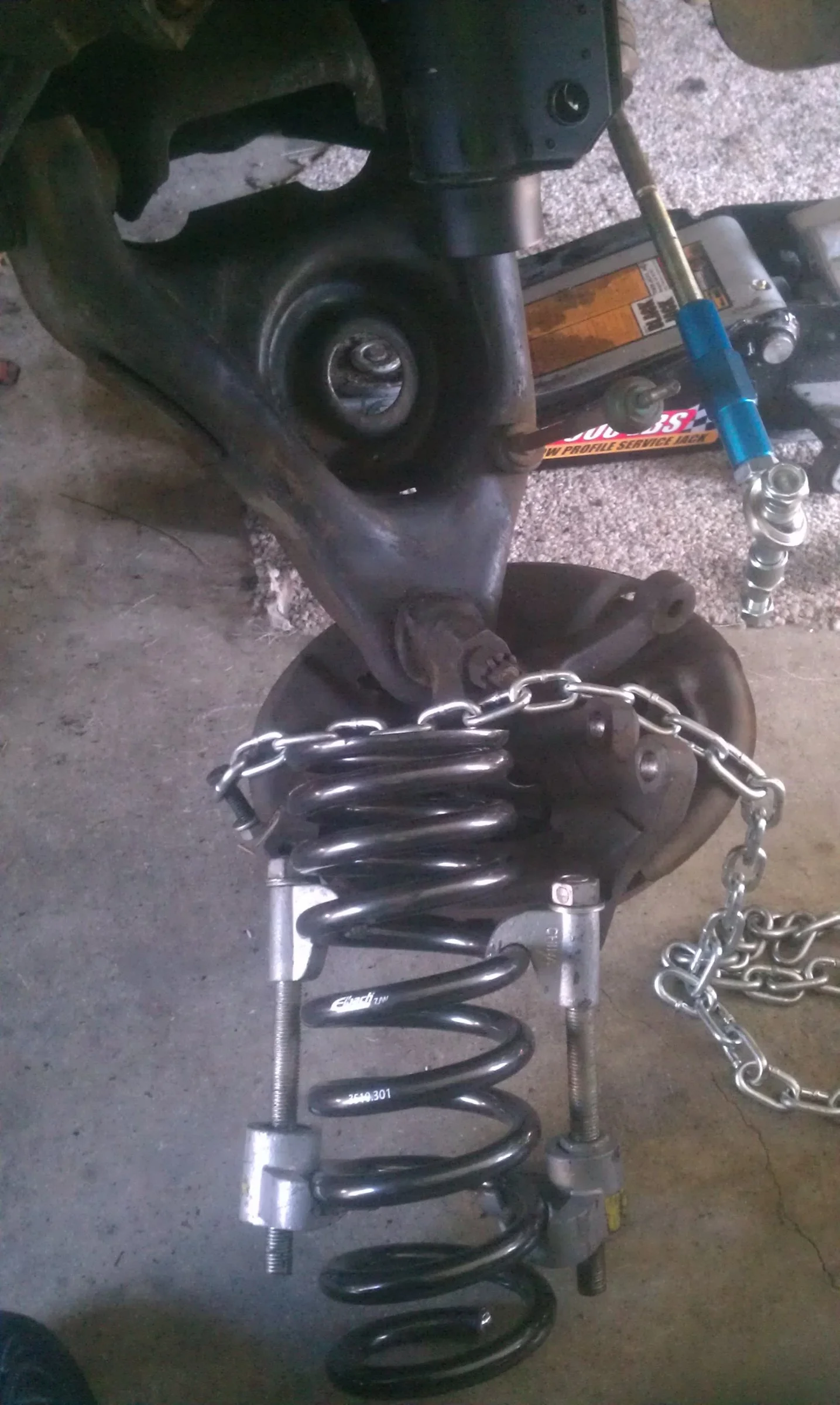

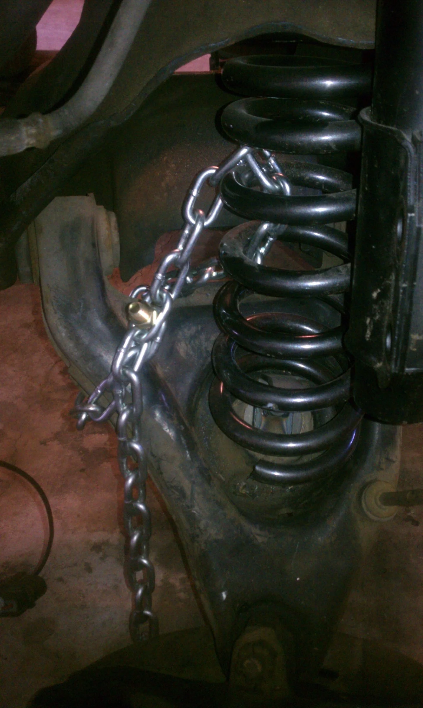

My way of doing this job. Yes, I prefer to wrap a chain around the spring in case it decides to pop out on me. Safety bro!
Thanks for the pics, big help. Chain is a good idea. I see that you separated the ball joint from the tie rod, in your opinion is this necessary?
Sent from my iPhone using Tapatalk
Absolutely. And you really need to jack the car up high enough to have the control arm hang free and able to push down with your foot all the way down to get the spring in/out. The steering tie rod will limit that if left connected.
