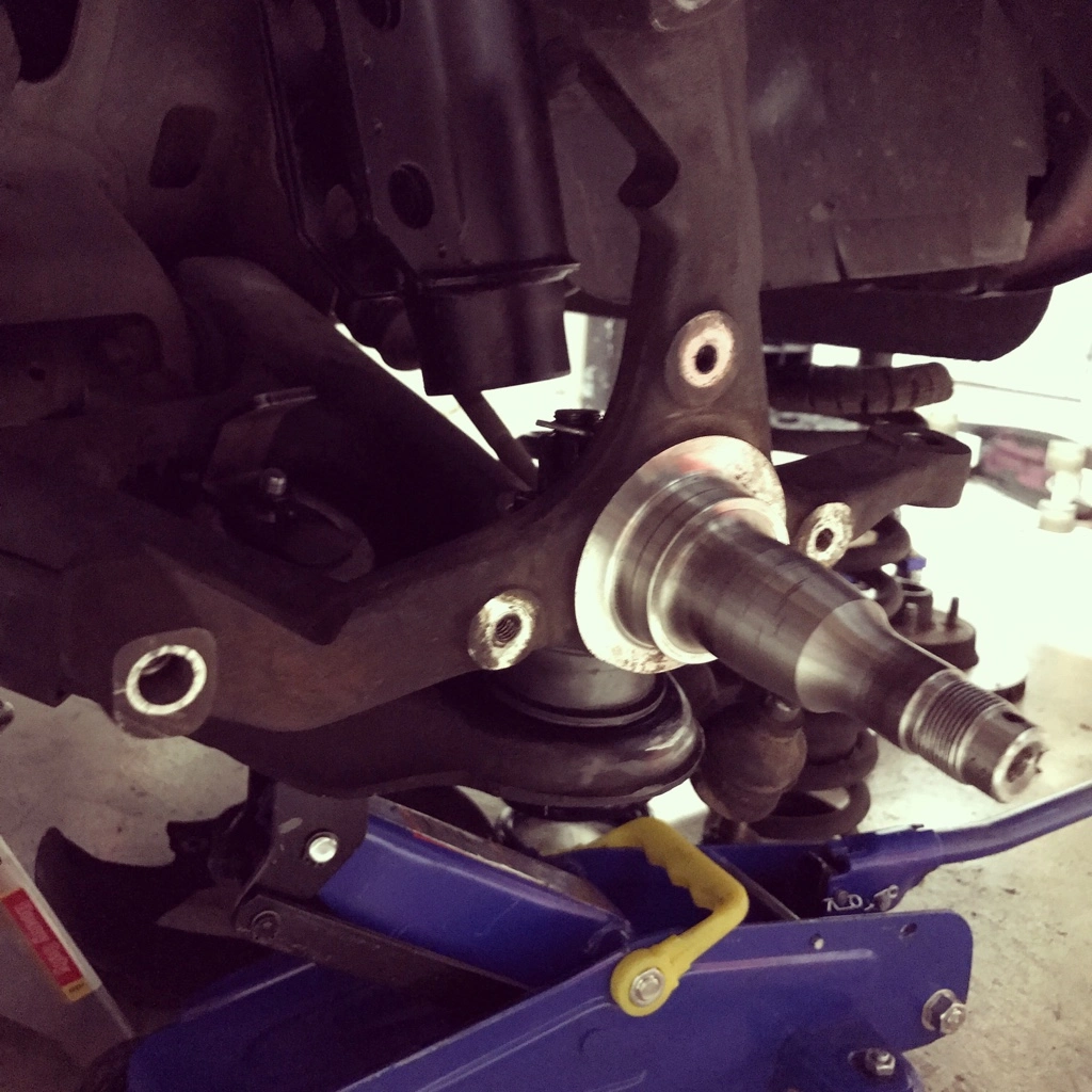

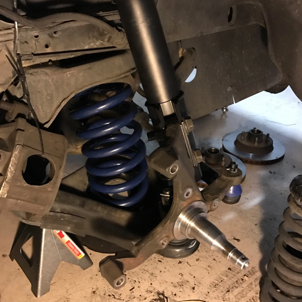

New ball joint pressed on and greased. Spindle reinstalled. Next is the tie rod lower.

Shiny new parts! Next up is rotor and bearings, then on to the drivers side.

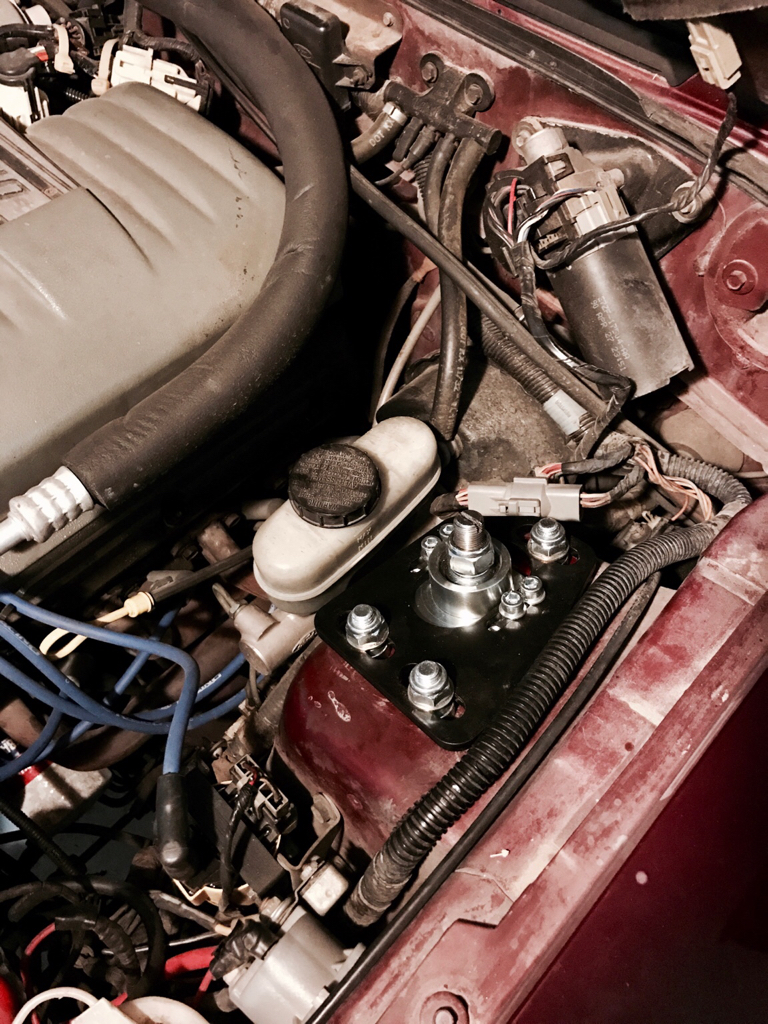

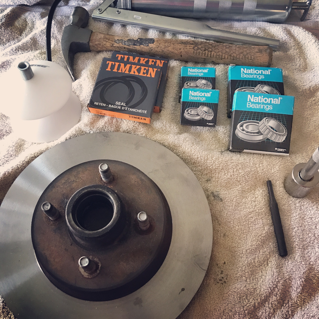

Installed Caster Camber Plates tonight. Also Installed new races and turned the rotors.

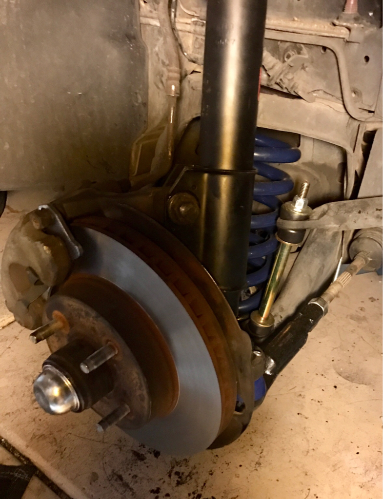

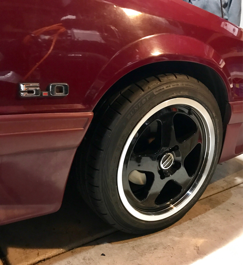

Bearings packed, rotors installed, new brake pads and calipers installed. Trying out the new wheels and tires! Love the new front end stance!
Now on to the rear.

Looks good. Give it a few days prob come down a tiny bit more

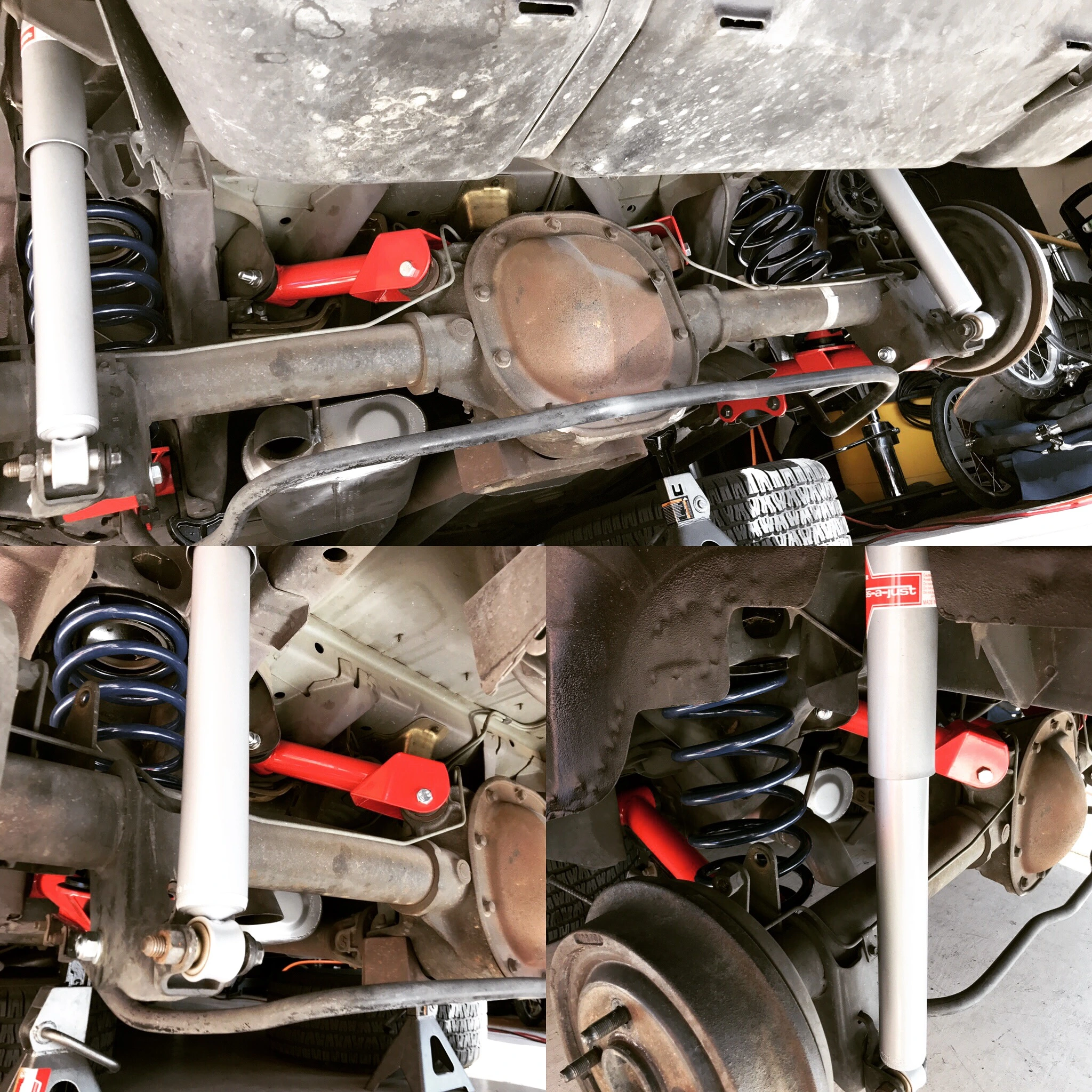

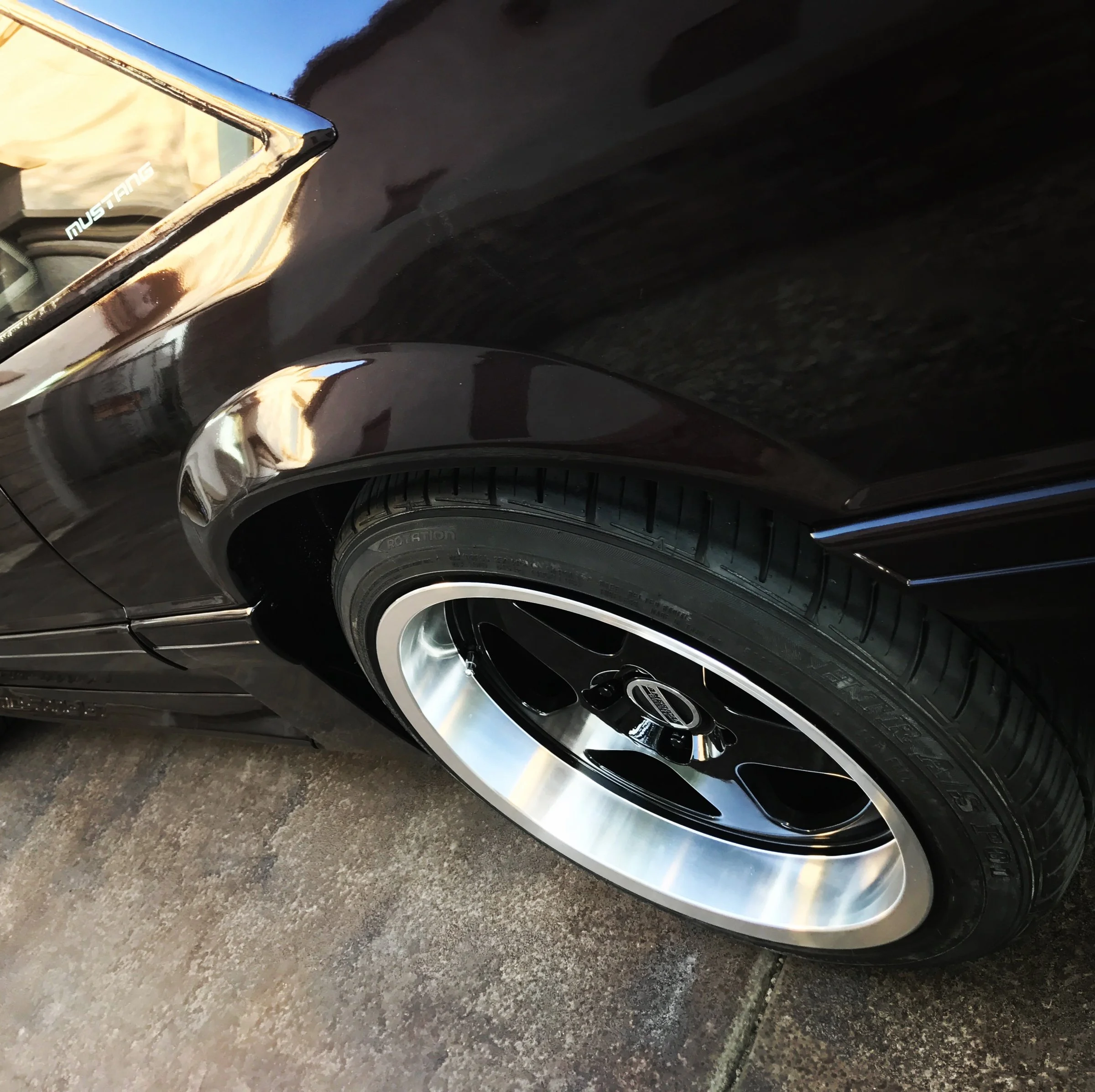

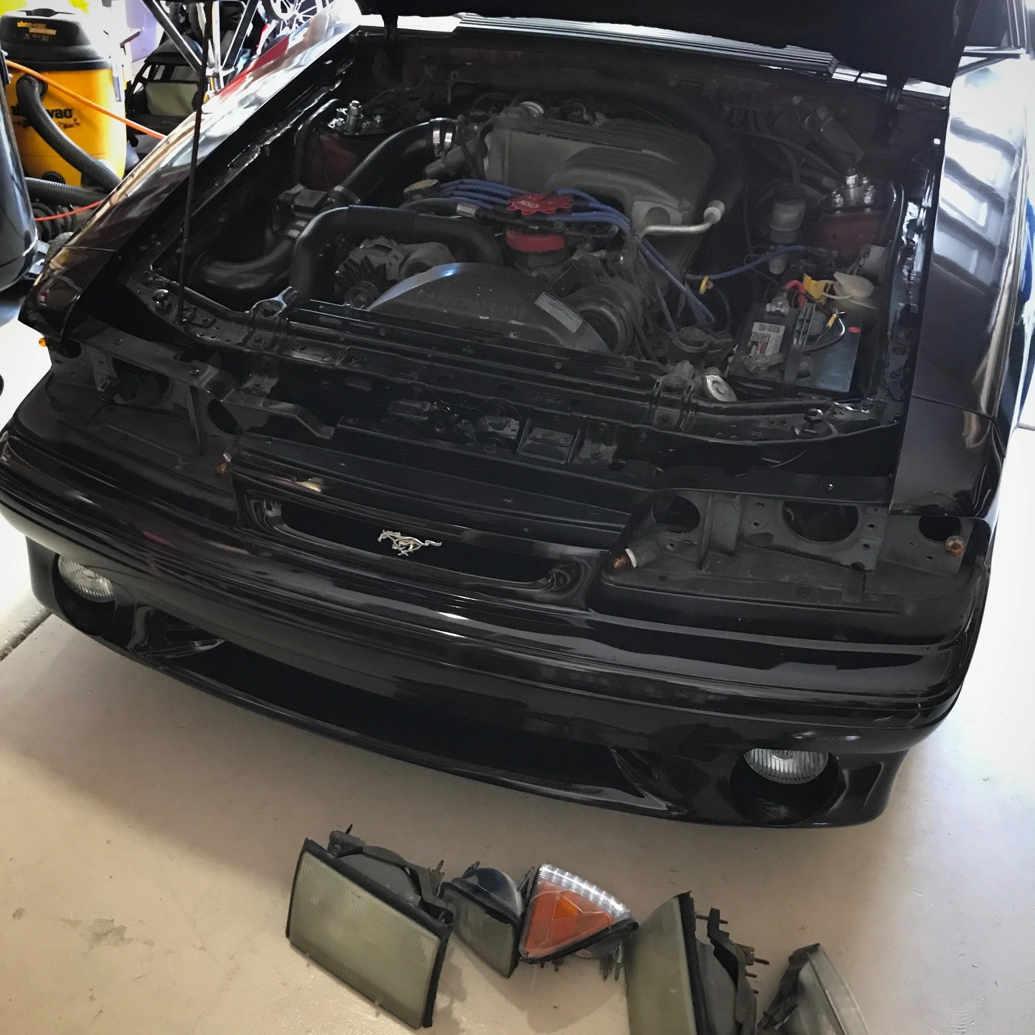

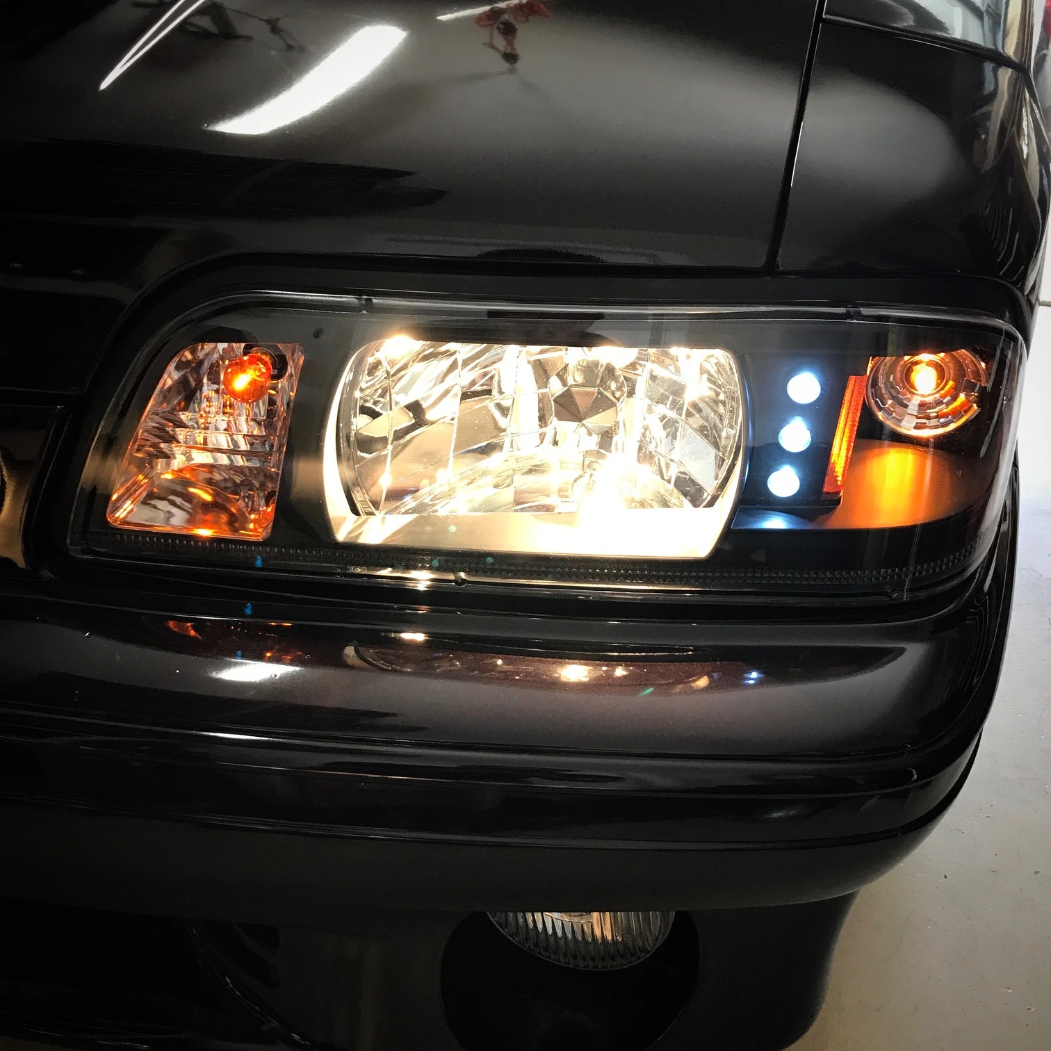

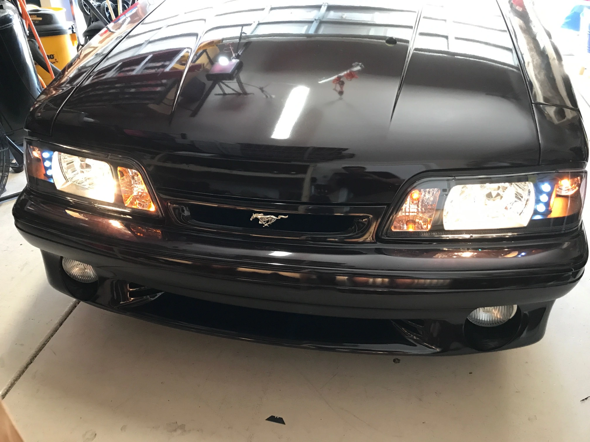

Wanted to post some pics of my progress. Rear rear suspension done. Exterior done for now. On to interior resto.

Looks good. What size tire do you have on the back wheels? Looks a bit stretched.
You've had a busy Winter... Looks good! Jealous of a heated garage...
