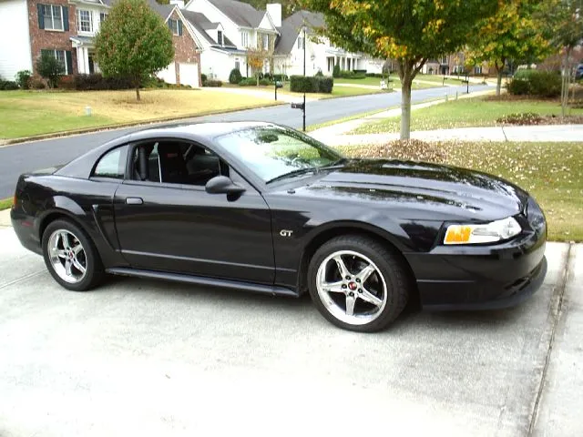

I have 17 X 9 Cobra R's. Up front I have 255/40/17's with 285/40/17's out back. I like the slight "rake" to the stance.
