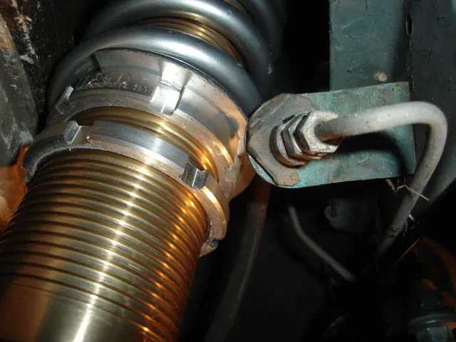

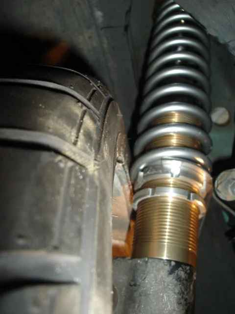

Im having the exact same issues with my Coilovers hitting my wheels. Here are some pics.....
Im runnin 17x8 2000 GT wheels with 245/40/17. I wasnt to worried about it since im gonna be running skinnies up front :shrug: I was also told that maybe an alignment would fix it, but i dont think it will.....
-AJ

Actually i never thought of this... My motor is not in the car right now, and the coilovers are all the way down. I might not even have a issue once i get weight on the springs and i have to screw the rings up to raise the front end up?????? Those rings might clear the motor is dropped in.
-AJ

I had to move my brake line mount when I did mine. It will hit when turning. I just drilled and retapped a hole further down the frame and carefully rebent the line a little.

Idk what the deal is, the driver side coilover is fine, but as you can see in the pics the passenger side almost hits, maybe like 1/16th of clearance, which is def not safe..... Im really not gonna worry about it, im gonna be running shinnies so w/e.
-AJ

Just remember an alignment isn't going to change anything, since the shock/spring are attached in a fixed position to the spindles.
So make sure you fix the problem completely before blowing money on an alignment.
