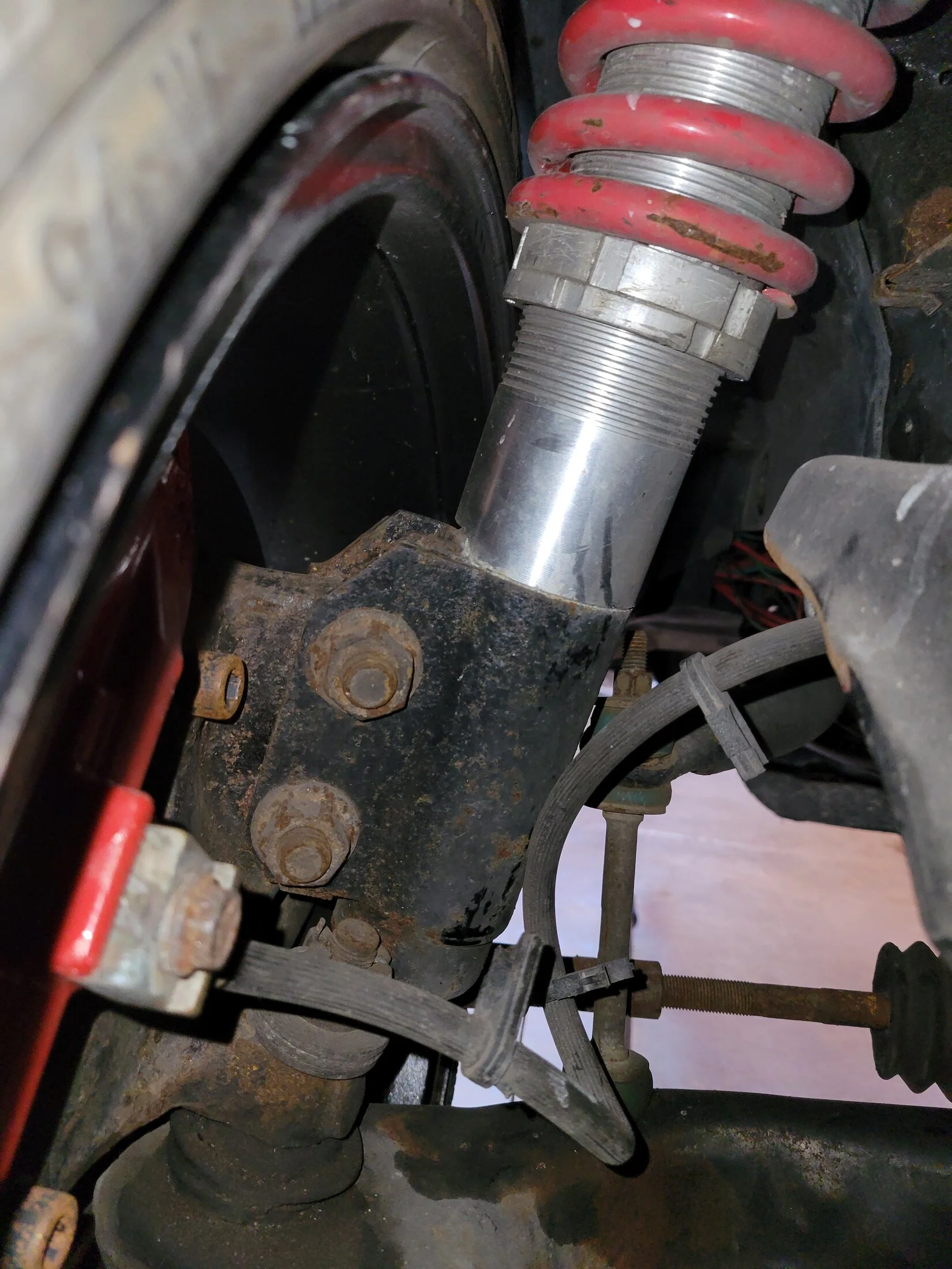

I have a 95 Cobra with MM Coilovers (Front = 400lb/in, 10", 2-1/2 diameter springs for Bilstein struts) and (rear = 250 lb/in 9", 2-1/4 diameter spring for Bilsten shocks). I have ARE Torque Thrust IIs, 17x11s (315/35) rear and 17x9.5(275/40)-Nitto 555s in the front. The rear tires are 12" wide and the front tire is 10.5" wide. These are deep dish wheels that you can put your head in them. The coilovers barely touched the front tires (don't think it touched the rims though from what I recall...been years). I used a 1/4" spacer to clear tire in the front. An 1/8" spacer would've work but I could not find an 1/8 spacer at that time (do they sell them now...uhmmmm). As you can see in the photos the 1/4" spacer was more than what was needed for clearance. No clearance issues at all with the rear tire.
Note: I'd highly suggest you really consider getting the rear coilovers also that way you can adjust the height the car sits at both ends.
Also, I don't know if needed for your year car but consider getting the caster/camber plates.

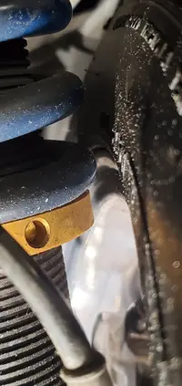

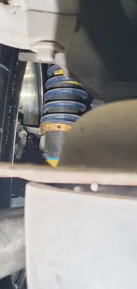

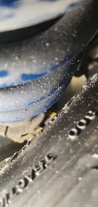

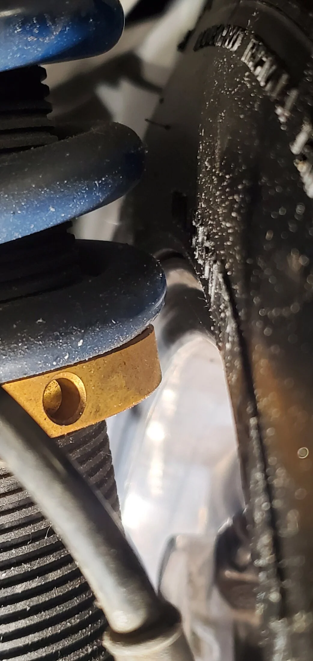

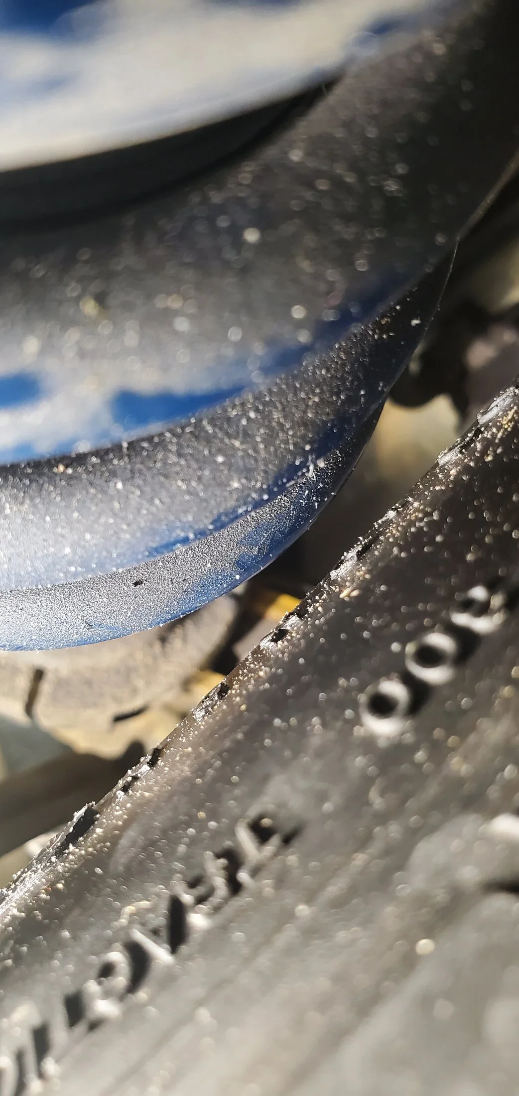

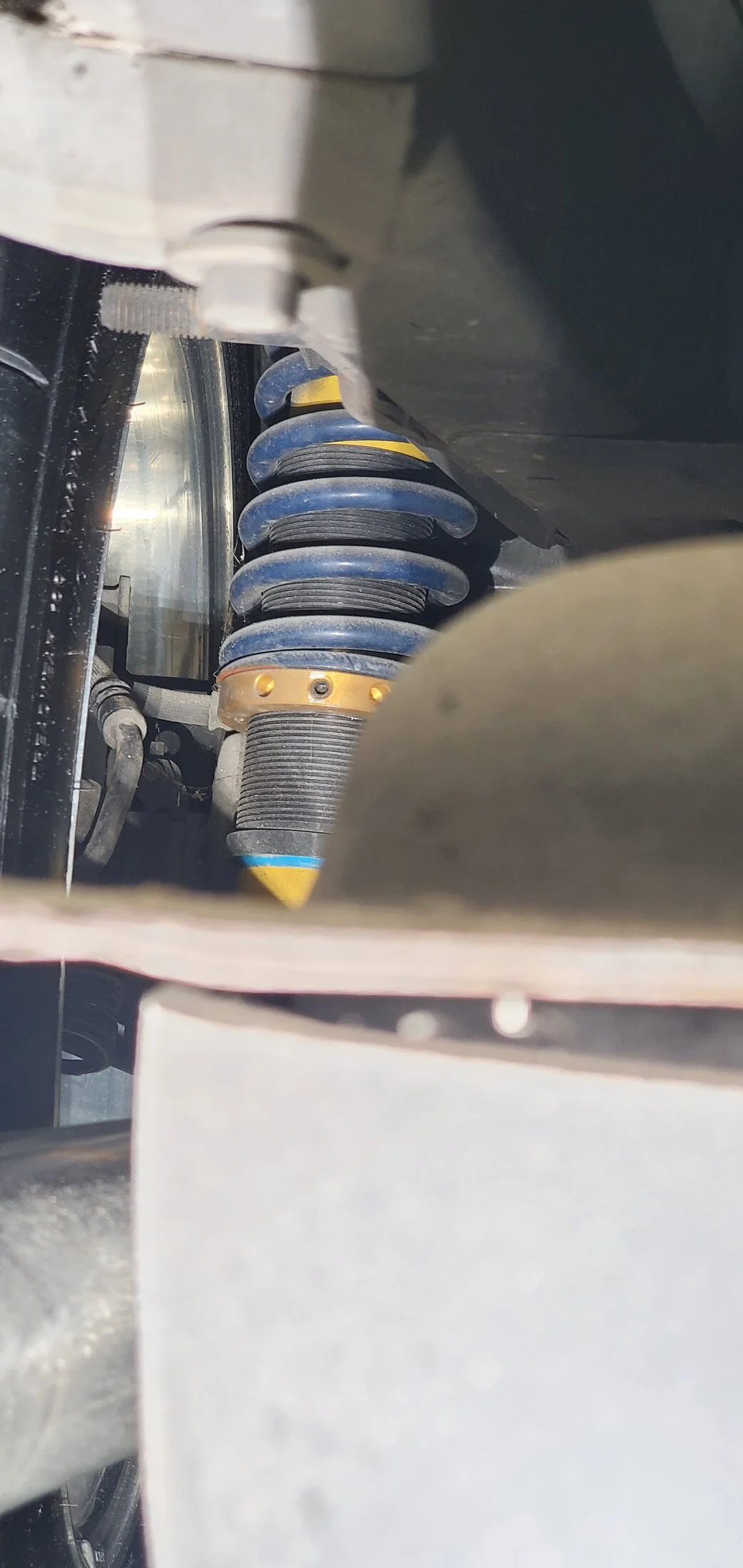

I went with the Maximum motorsport coil over kit and control arms like I mentioned initially. For everyone who helped in 2024 and anyone in the futures information I'll post my current setup and a pic of the clearance
-88Gt mustang
-Stock K member
-Maximum motorsports standard offset from control arms
-stock 88 spindles
-Koni DA sport struts
-MM coilover kit with 10" 325lb spring
-MM CC plates
-LMR 4-bolt 03 cobra wheels 17x9 +18mm offset with 235 tire. pic with no spacers
I have the height set around what an eibach pro kit looks like I think
I also haven't gotten an alignment yet, so not sure how much that could change the clearance.
thanks again for all your help!
