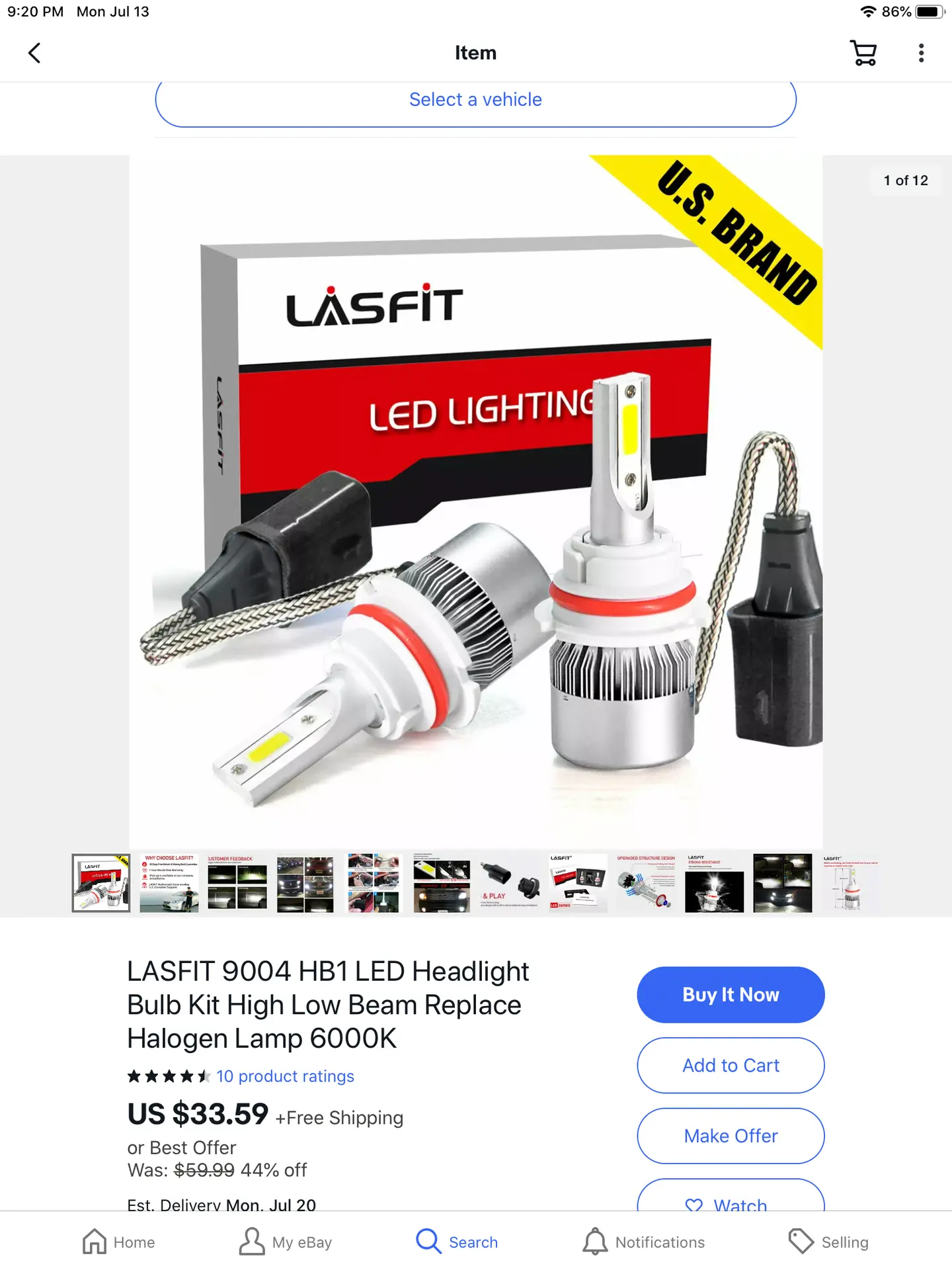

This is the led kit I installed
Those are headlights. Having LED headlights has no effect on blinker operation. If you don’t have LED bulbs in your turn signals, still try replacing the relay flasher. Also look at the hazard switch. The turn signal wiring goes through it, and it’s not uncommon for the wires to come loose.
Exactly. In your 1st post I think it said that you can’t run LED headlight bulbs without also using an LED flasher, which made no sense to me. Simply because my headlights worked perfectly since I installed them and I haven’t done anything with the flasher relay yet. Thanks for the tip on the flasher/relay. I’m gonna swap it out and see what happens.
