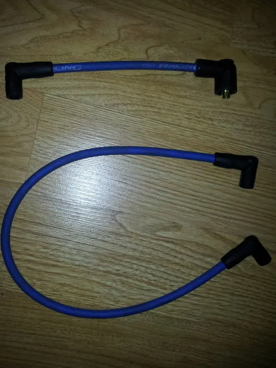

Sorry if this is a dumb question but today when I was installing my new wires, I noticed the set came with two different types of wires that connect the distributer to the coil. They both are a little different from the wire that was being replaced. I dont have any kind of aftermarket coil either. Which wire am I supposed to use? I think it is the longer one but I just want to make sure.

The shorter one is for a different type of ignition coil. The longer one is the one you use. It's longer so that it can also be used on a Foxbody, which has the coil mounted on the inner fender. All of the FRPP wires are actually longer, because they are also cut to fit on a 351.

The FRPP 9MM for 5.0's are universal for 86-95 engines. The longer coil wire is for a FOX body and the shorty coil wire is used for 94-95's. You'll need to get new wire looms since the stock wires are 8MM and so are the looms. I made mine from zip ties. I couldn't find ones I liked so I got creative. BlackVert has some extremely nice ones.

I wasn't able to hook the short wire up since it has a different kind of connector boot on one end. What am I doing wrong? I'm going to go to oreillys after work and see what they have for wire looms.

You didn't do anything wrong....as stated those wires are universal for 86-95 engines.....not specific for a 94-95 Mustang. They're nice, I used them for a while, but as you're now experiencing...they don't fit all that well, a bit long as they're used on the bigger 351 as well. The zip tie method is great for tidy-ing up the wires....looks alright too. Might be your best bet...give it a shot.

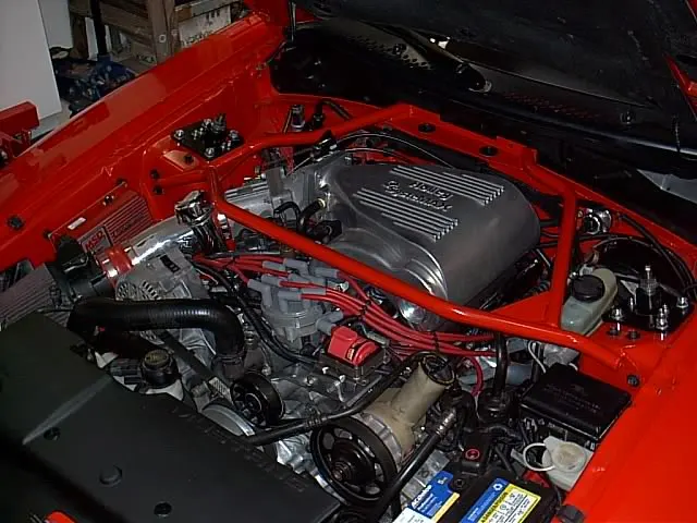

The stock wires are adequate. Honestly I ran stock wires for a few thousand miles. I have a LiveWires set (excellent but pricey) then went with FRPP and in the picture I posted above, those are MSD 9MM. I bought the MSD6AL ignition box, wires, coil, cap & rotor all at the same time.

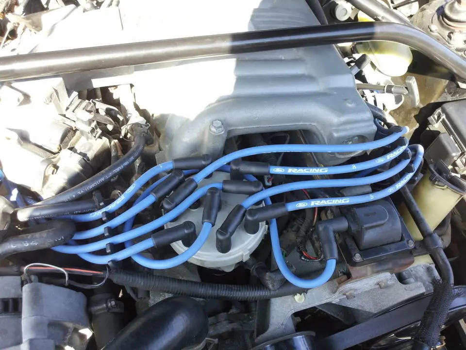

Here is how they turned out with the Moroso seperators I used:
Doesn't look as nice as some of yours do but it did help clean it up a bit.

Looks pretty good.
I have a suggestion for the coil bracket. Mine was as rusty as yours. Some clean them and paint them black. I polished mine. I know you shouldn't polish steel but that was the theme when I had a blower. What I did so it wouldn't rust again was sprayed 2 coats of clear on it. I used clear from a rattle can I got for $6 at my local parts store. I used 400 grit, 600 grit, wet sanded 1500 & 2500 and it was shiny. Or you can just clean it, scuff it up, spray primer then spray it in black. Also spray the two 10MM bolt heads holding the bracket as well.
