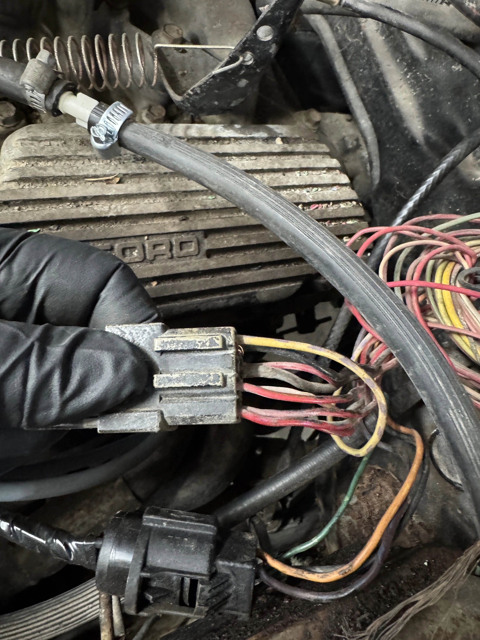

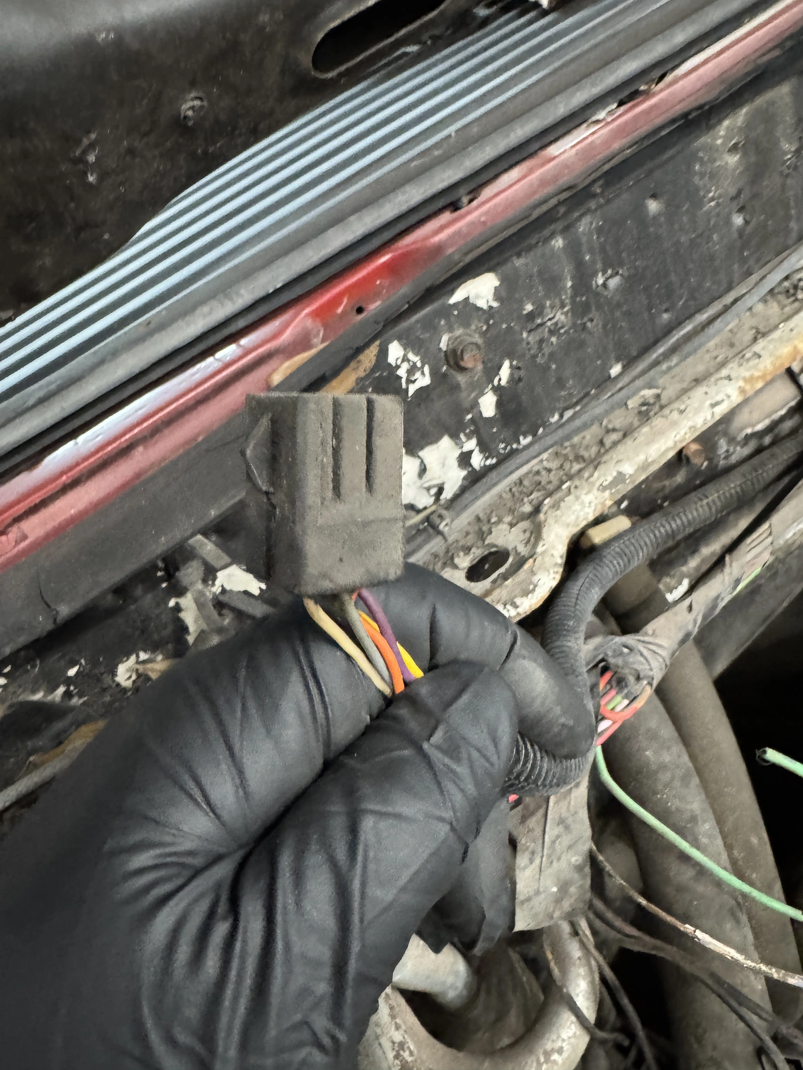

This first picture is of connector 135 according to the Ford electrical and vacuum manual. This is a connector that goes to the ignition coil and AC clutch and oil pressure sensor and coolant temperature sensor. My question is this yellow/purple wire had a second wire connected to the same pin but the insulation has melted and I don’t know what color it is supposed to be. I’m hoping it is the green/purple wire that comes from the switch on the air conditioner dryer/accumulator because that wire burnt up and I don’t know where it is supposed to go. The second picture is of a six pin connector that goes into the firewall right in the middle of the engine bay and it is disconnected and I have no idea where it goes. It is long enough to reach to the right side of the AC accumulator, but I have nothing in that area that it plugs into.
