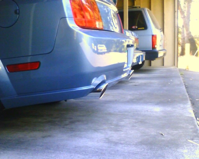

Anyhow, $60 today at the muffler shop and now they look great! :D
I LOVE them!!
They just torched the hangers and adjusted over and over until they were perfect! I also had them remove the clamps and weld 'em on :)

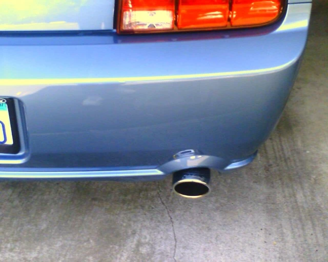

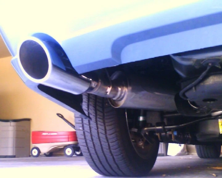

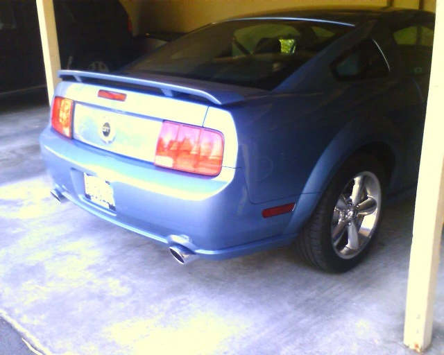

Couple more pics...

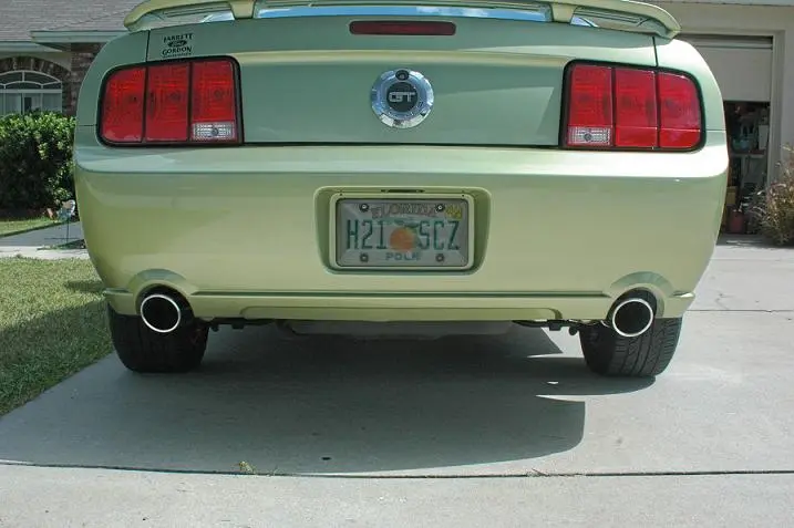

I attempted to install in the drive way, but didn't have any jacks, and could not get enough leverage to get the oem muffler dislodged from the over the axel pipe. My favorite garage made short work of it for $45.
The driver's side is perfect, but the passenger side is about 1/2" left of center. Other than that, perfection. I bet as we add more hp the deeper it's going to get. :hail2:
