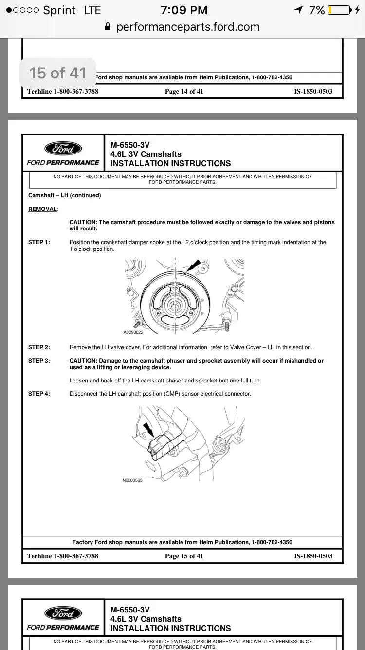

I am about to install frpp hot rod cams but I just noticed my harmonic balancer does not have the spoke and timing mark on it and it is a bit rusty :/

Do you not have a factory balancer? It should still have a timing mark on it.
Regardless you can find TDC with the valve covers off. I have underdrives on mine so I didn't have the spoke, but I did have a timing mark. I used that to roughly locate it, but when you take the valve covers off you can look at the position of the cam lobes to make sure it's right (the illustrations in that guide are very helpful and show exactly how it should look)

Thanks for your input man but I'm pretty sure it is the factory balance. I'm going to try and take the valve covers off and check the cam lobes. I'm a newbie haha but I refuse to take my car to a mechanic or a performance shop for this. I will update with pics if I run into any other complications.

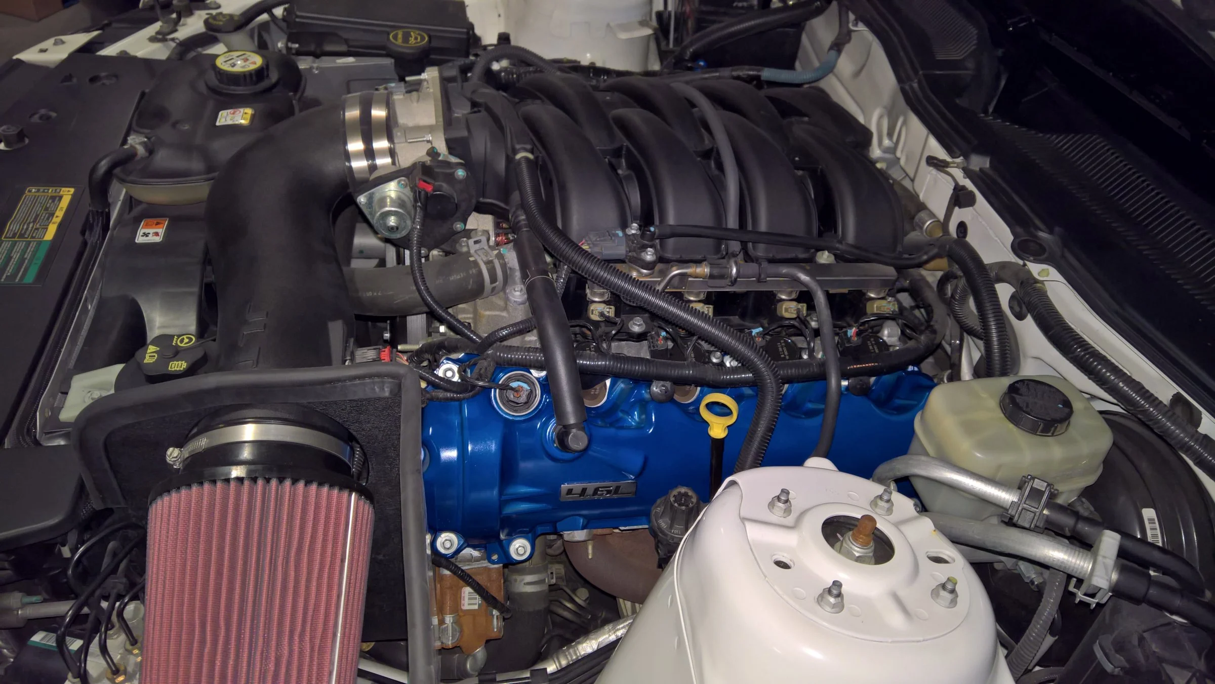

Great writeup on the how-to. There are also some great videos on this. I have been tempted myself - so what's stopping me? I have already had the covers off and done a bunch of stuff...just hate the disconnecting and maneuvering process (especially on the passenger side) I know, call me lazy ...LOL - Painted the covers while I had them over..MUCH nicer than flat aluminum
