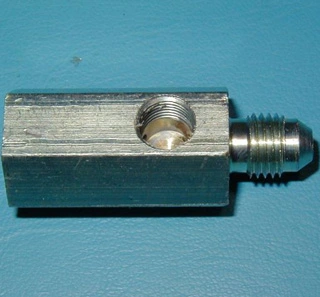

im installing a nx wet system which requires me to use the fuel port on the fuel rail..now i had a guage there before the install...is there a way to keep that guage and run the line for the nozzle??

The adaptor screws on your fuel fitting on the fuel rail. It has a 1/8 hole on the side that you can screw your gauge onto.
so it just screws on the fuel port and the the hole would be for the gauge right? thanx for the link expensive litte piece
Yup
