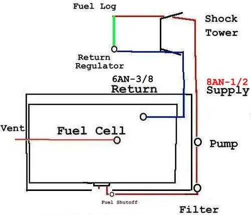

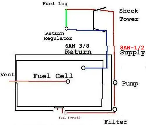

I would swap out the spacer for a non metal one. Aluminum conducts heat very good, thats why they switched to non aluminum windows for houses. If putting in a non metalic one does not cure the problem, you may have to set up your fuel system like mine...
Here is my full fuel system.
http://www.qsl.net/wd4ngb/birdwork5.htm
Good luck
