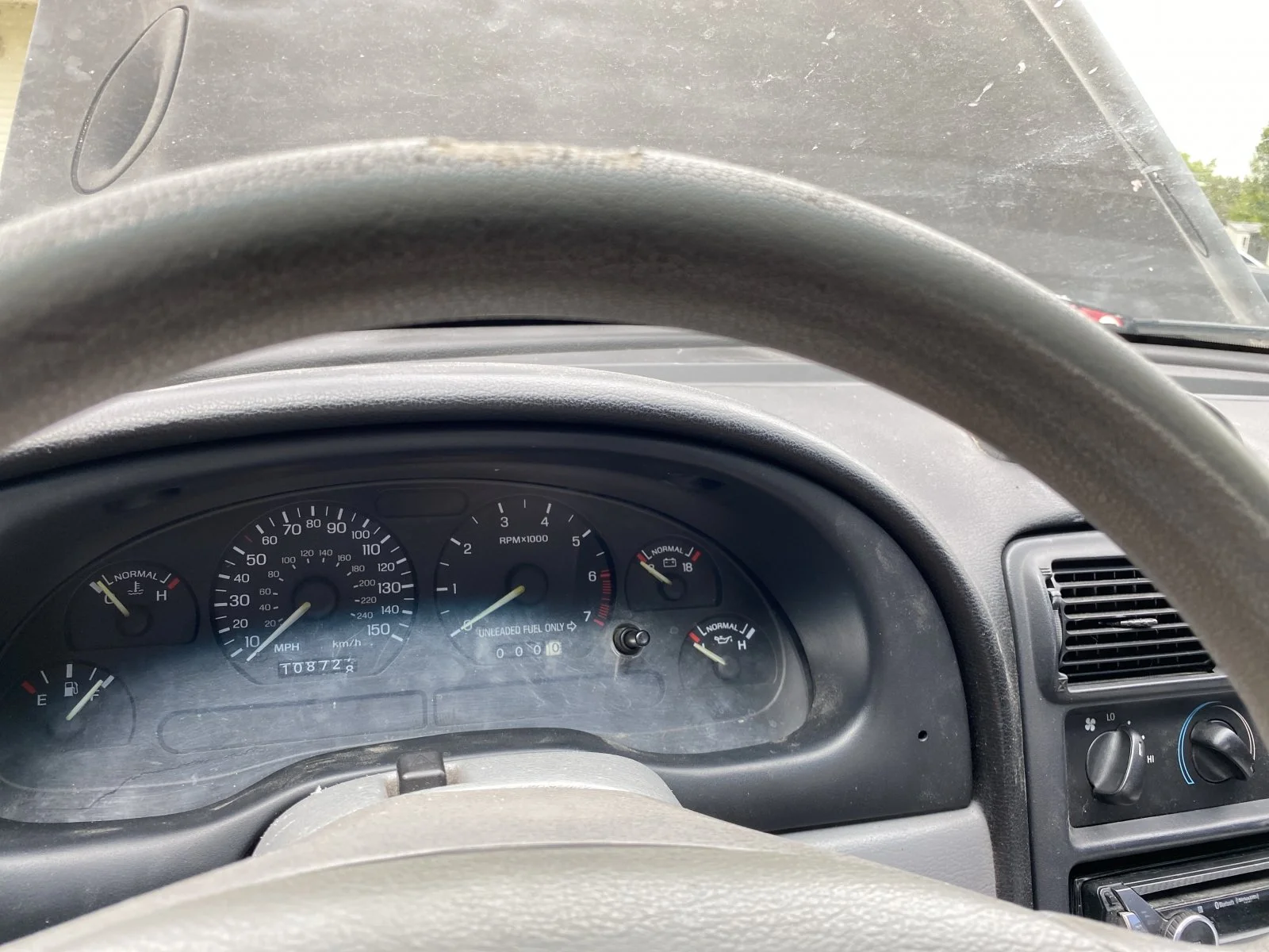

So I drove the car for maybe an hour and a half in total yesterday, and the temp gauge moved, I think it got to about the “O” in normal, but I’m not sure if it’s reading accurately. The fan has a toggle switch hooked up to it, so I usually run it whenever I’m driving. That could be why it isn’t getting any warmer than that, but again, I don’t know if it’s accurate.
Oh and just a little side note, my tachometer “works sometimes”, the odometer doesn’t work, and the oil pressure gauge doesn’t either. I was thinking about buying an intellitronix digital gauge cluster, which would include all new sending units for it. I just want to make sure the car is going to be reliable before I start spending that kind of money on it.
The gauge on the dash being fubar will never throw a code. The eec doesn’t even know it exists. The coolant temp sensor sends info directly to the eec and is located on the metal heater tube.
My temp gauge is working fine now. I probably just thought it was borked from just looking at it for a few minutes while idling, with the electric fan on, not letting it get hotter. It’s hooked up to a manual switch so I usually flip it on after a few minutes of driving.
