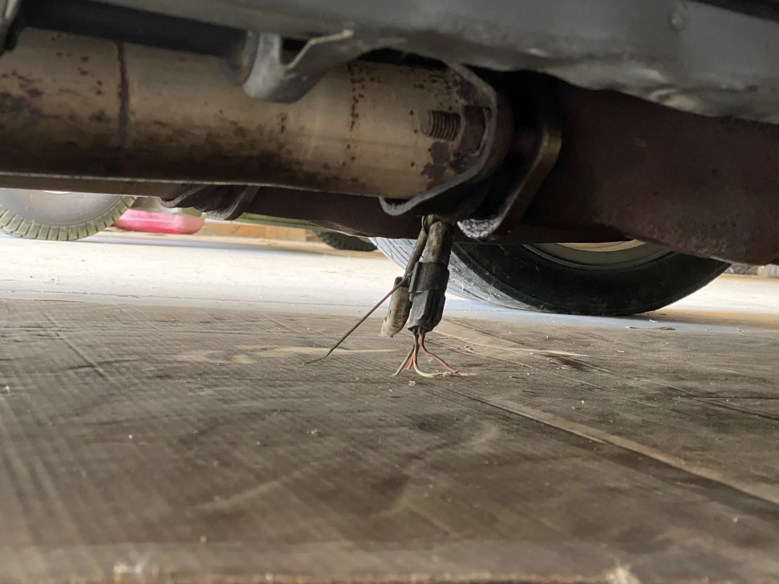

Hello All! This is my first (re)post here on StangNet and I was hoping to find some guidance. I’ve got a 95* Mustang GT with the 5.0 V8. I just recently got the car and knew it needed some work. Just a quick look over the car I saw a few things. AC lines are all cut, some wires are janky, O2 sensor wires are cut and hanging from the bottom of the car, Etc. When I first drove the car, it was running rich and smelling strongly of fuel. I read I could change the fuel pressure regulator and that can help, so I did. The richness cleared up immediately (no more smoke) and the gas smell faded. Then one day as I was about to leave work, I started it up, and it was back. And really strong. I got the car home and noticed there was fuel coming out from the inside of the exhaust, right below my door. ( I made sure it wasn’t just dripping down anywhere by getting under the car with a flashlight). I’m really stumped as to what it could be. My guess would be a stuck injector, as it’s only on the passenger side. My dad said it could be a vacuum leak as well, which I hope isn’t the case, I’d have no idea where to start to track it down. Any help would be appreciated, I really want to drive my car! Thanks in advance.

First order of business is to fix what you know is broke. If the O2 sensors are dangling out the bottom of the car, then the fuel pressure isn't likely the problem. Get the O2 sensors installed properly, and then we can start looking at the janky wiring.

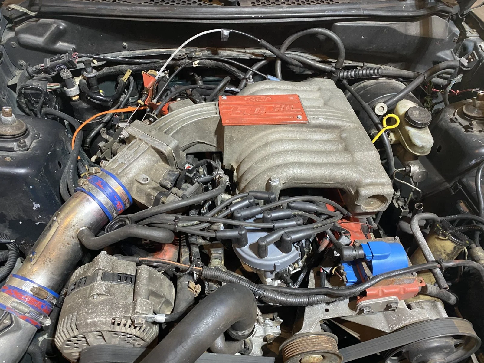

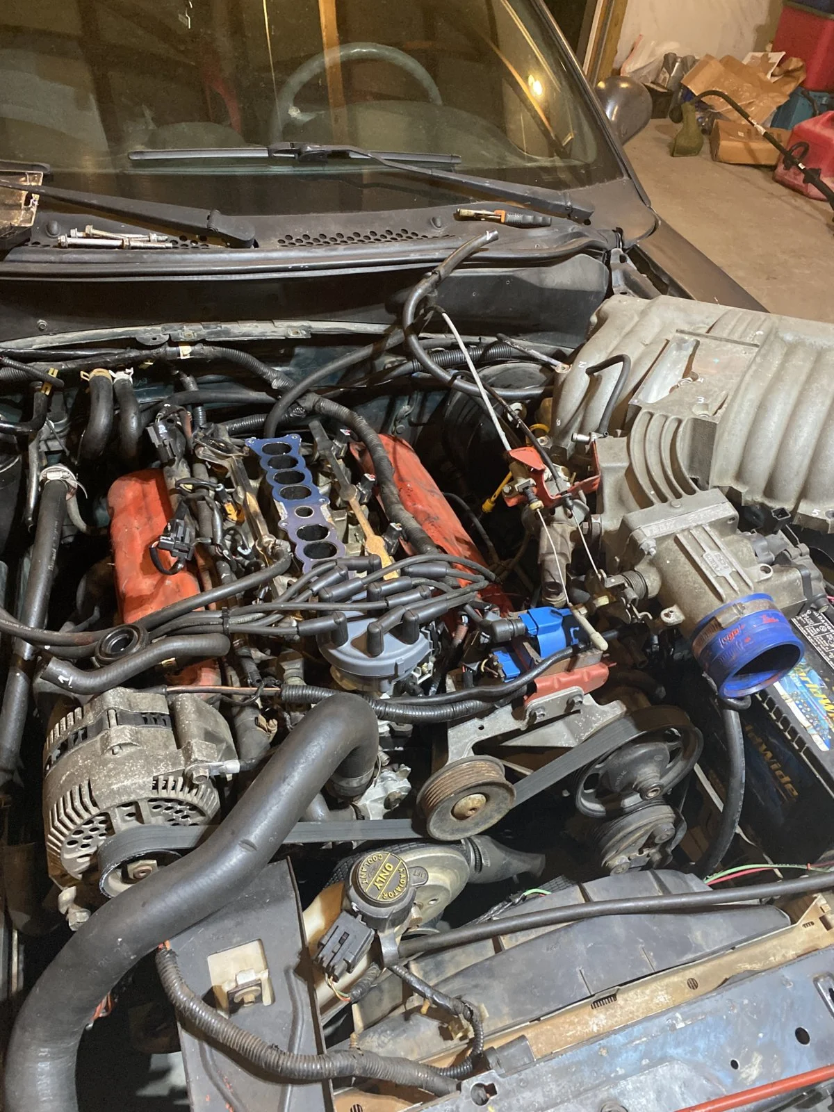

Here’s before and after I took the intake off

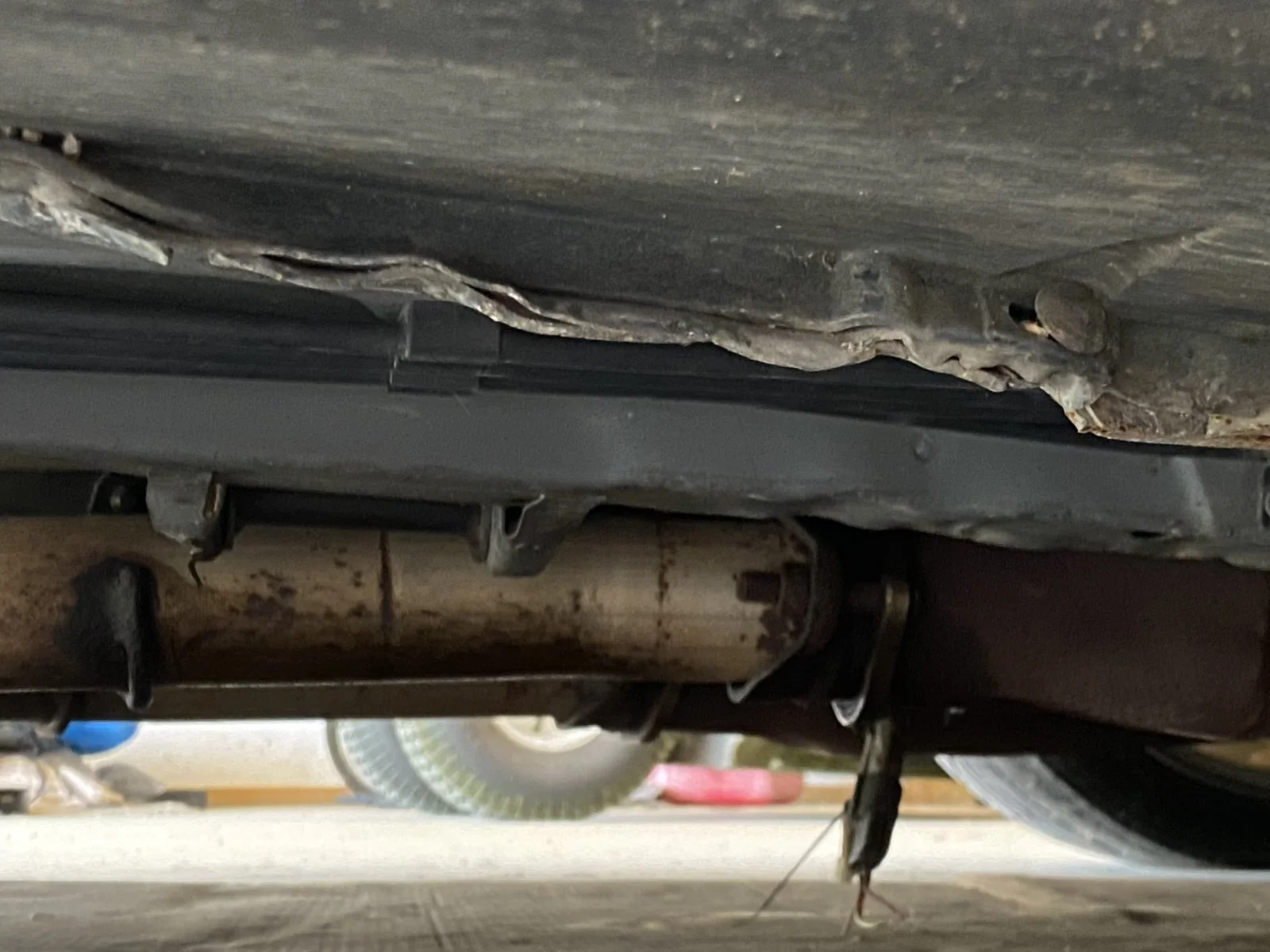

So I drained all the oil, and swapped it with some used oil just to test and see if the oil pan was still filling up with gas. We reassembled everything, and I replaced the fuel regulator which was covered by a lifetime warranty. Ran a NOID light on all the injector connectors and everything checked out. So I started it up, and checked for dripping. There were 2 drops, then it stopped. Looked at the dipstick and it was in a good spot, then I ran it for a while and checked the dipstick again. It didn’t change so there wasn’t anything pouring into it. Checked for more drips, no more came out. I took it for a test drive and it seems to be doing quite well, although I went ahead and ordered the o2 sensors and the connectors I needed to fit to the wiring harness. That’ll be here tomorrow, and I’ll install them.

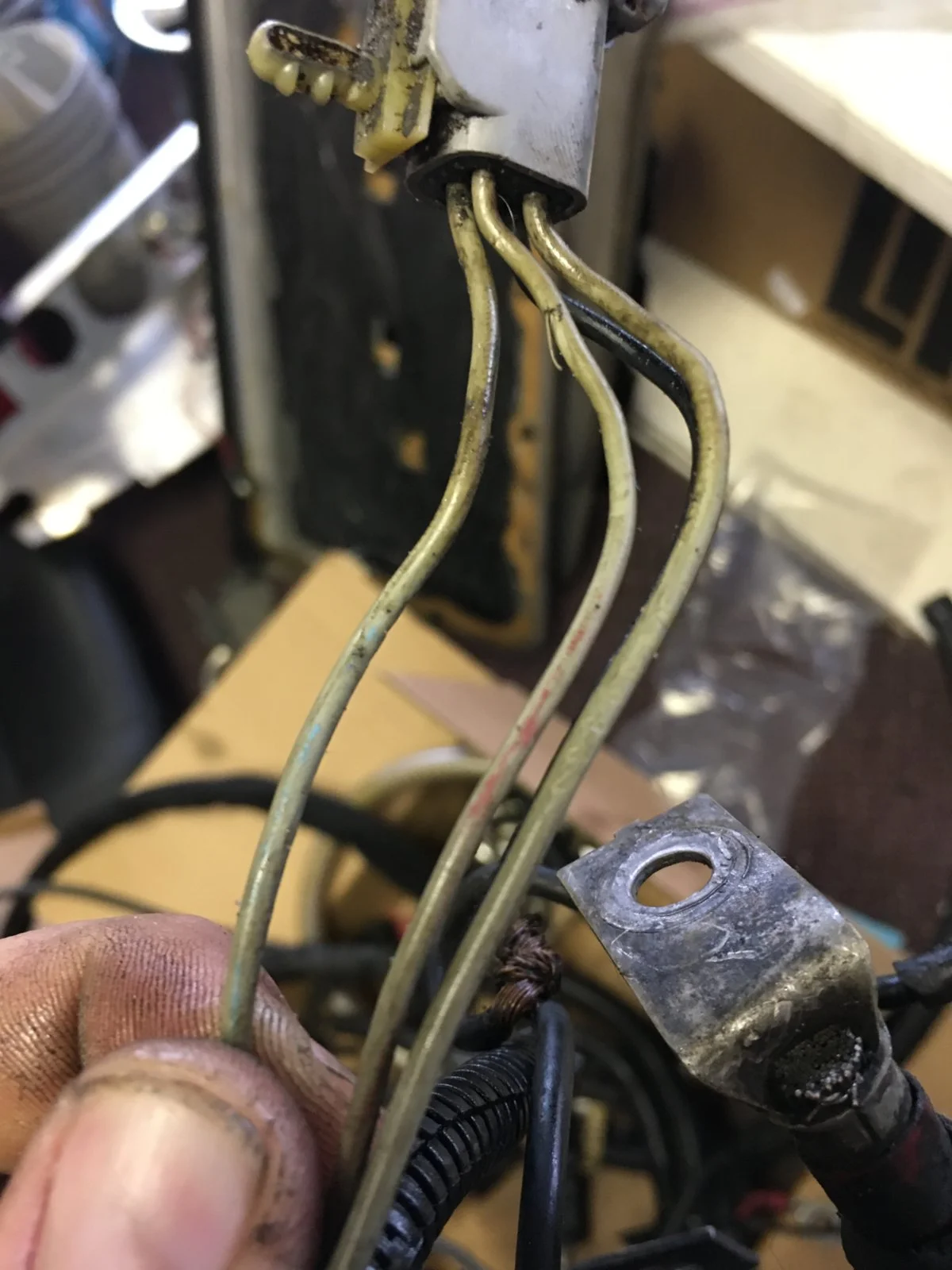

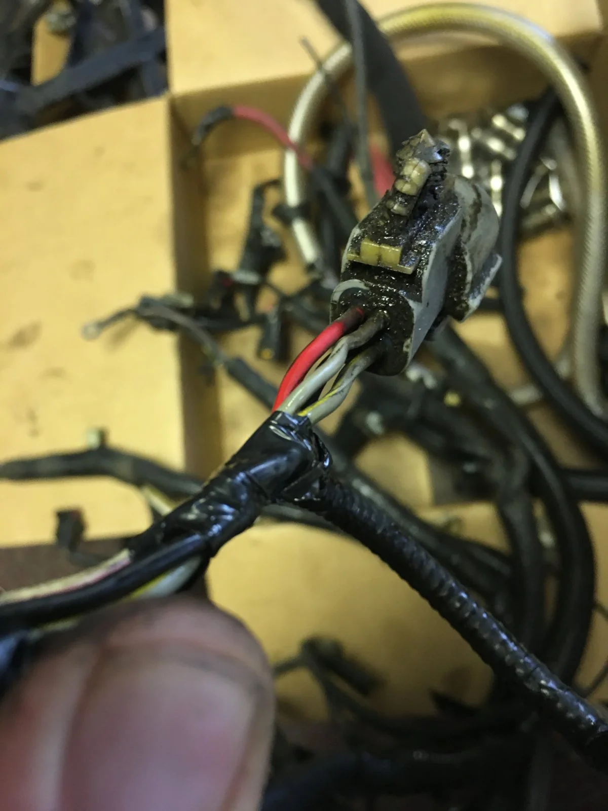

It’s very tough to see but if you’re looking at the back of the connector on the passenger side it goes: light blue/gray - red/gray - yellow/gray - black. That’s starting from top left and working clockwise.
