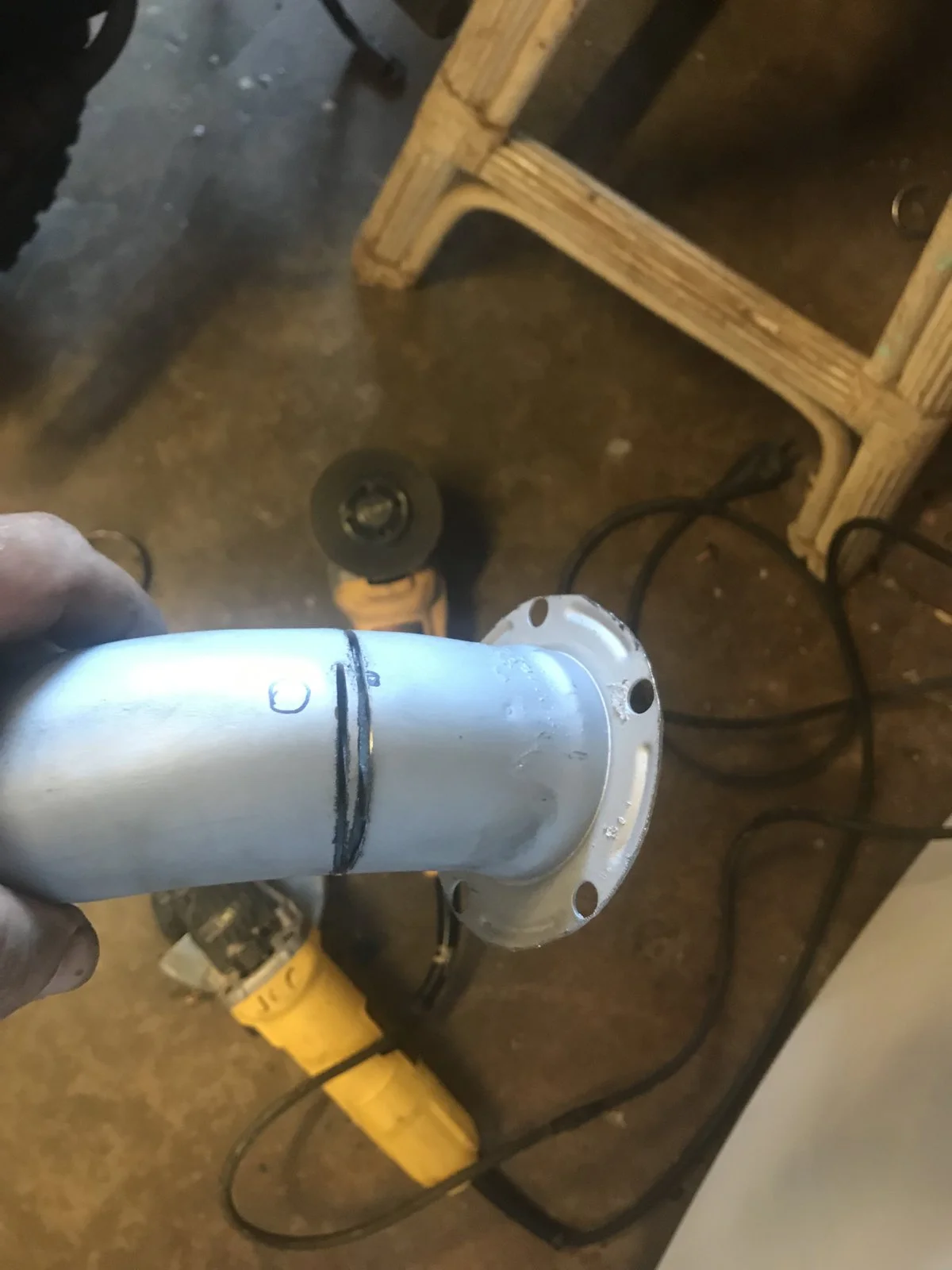

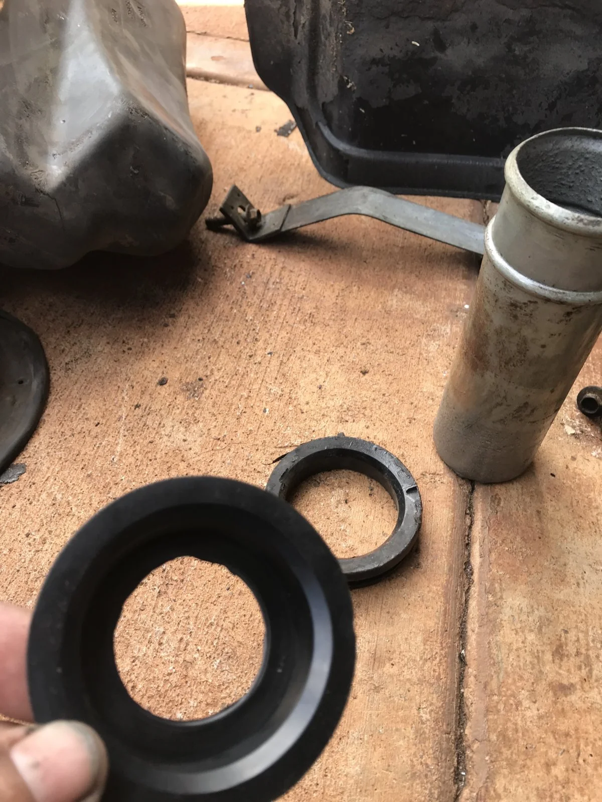

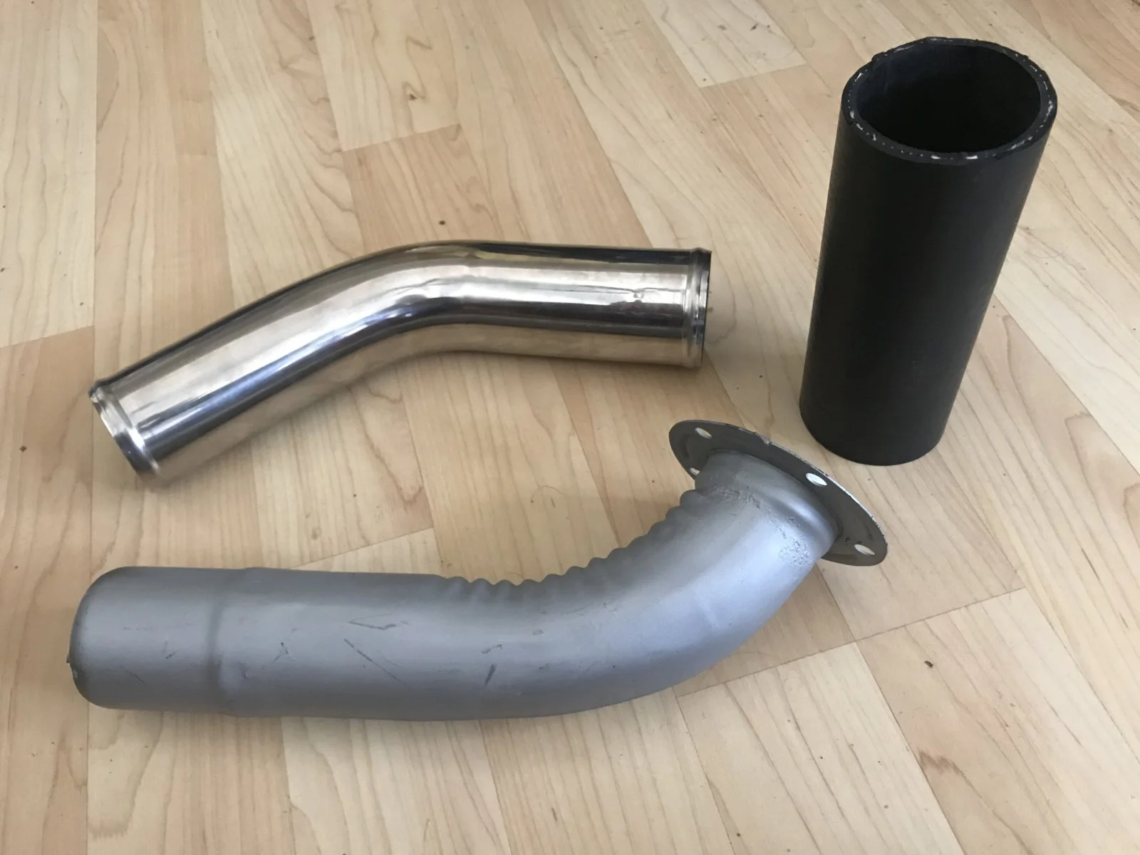

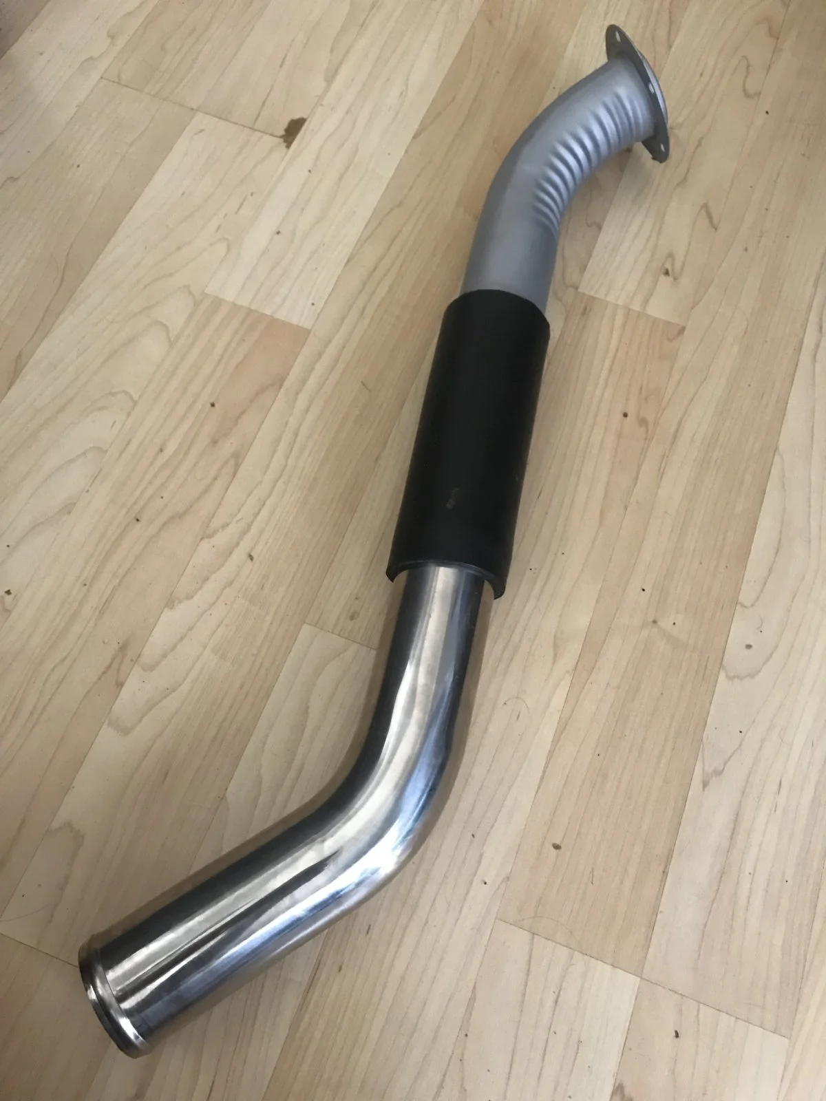

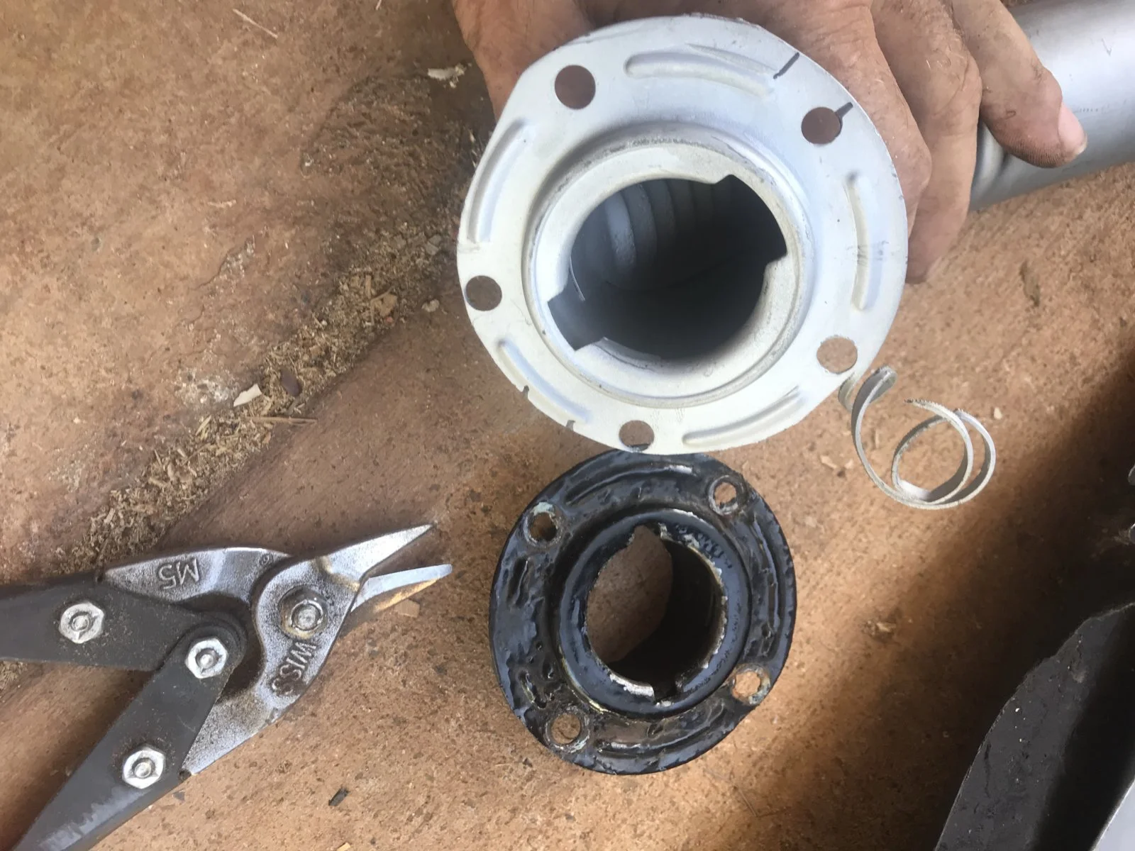

I did a 73 filler and the write up is in my thread here under 2blue2's driveway party.
Used a tank seal from Classic auto Reproductions.
Had to modify the filler a bit and did away with the accessory tank.
Napa had the right hose in stock, make sure its rated for gas and not just air handling or it will melt and leak.
