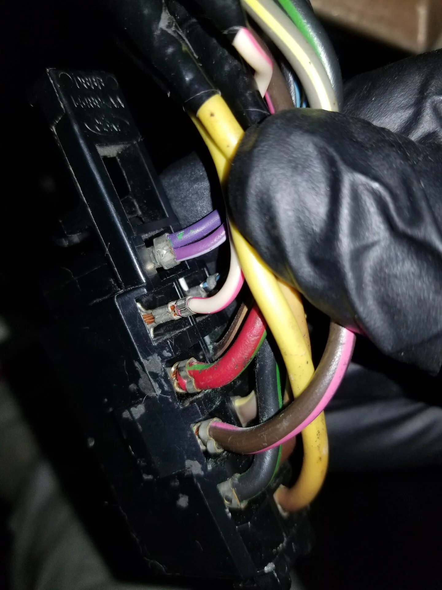

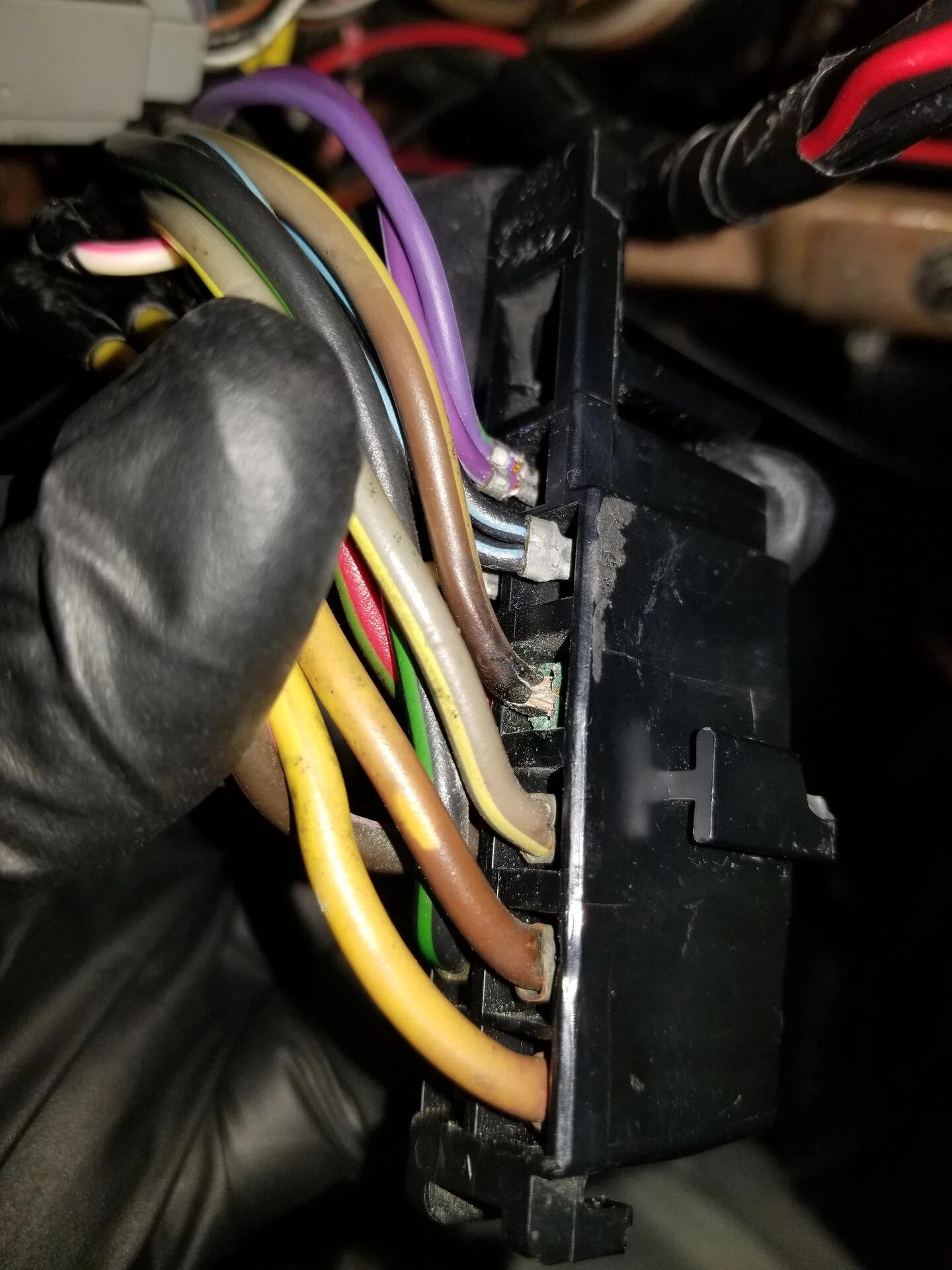

Check the ignition switch under the dash on the column for the intermittent shut down/no start condition.
My ignition switch had corroded wires and was melted in some places I could not depin those wires so I put a new a switch and new wires kit from LMR and my car feels like it picked up 20 hp and the dash lights up like a Christmas tree so awesome. I changed the ignition key switch to it was loose.

I think I've had a couple different issues happening at the same time. I replaced the slosh module and fixed several different problems. But the random dying thing turned into a random cut out, but not dying completely.
Last night, I was driving it and it cut out completely again, I grabbed the key to hit the starter before I rolled to stop and it came back to life instantly.
I think I just figured it out. Switch. I ordered a new one. I also got a handful of new bulbs for the dash. It'd be nice if that was lit all the way around again, too.

can you take a pic of what you ignition switch looks like when you unplug it?
