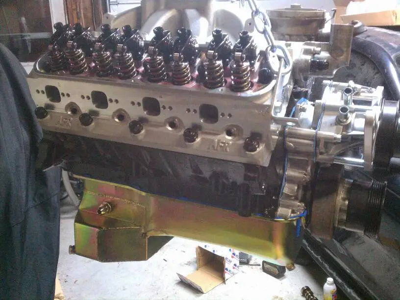

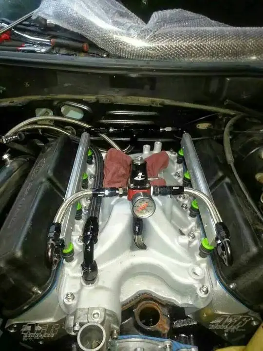

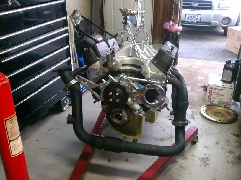

addermk2
5 Year Member
Aug 25, 2009
308
87
49
Dec 10, 2014
  • Dec 10, 2014
Here's my 351.
