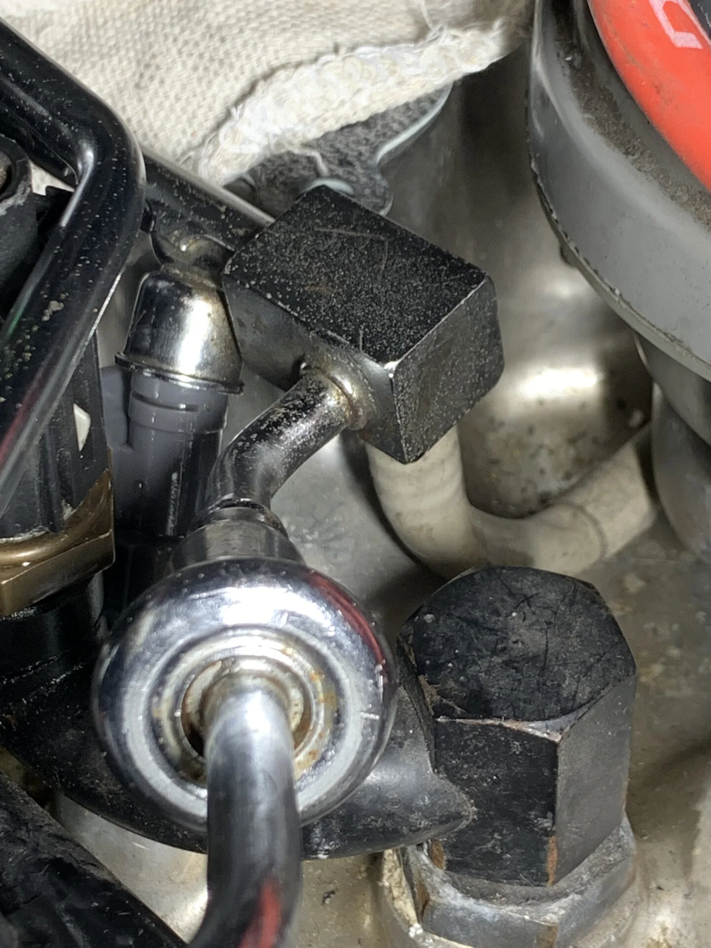

Last night while I was doing a final check for leaks before the first start on the new engine I notice that cylinder #1 injector is leaking from the fuel rail. I put a new o-ring on it and it’s still leaking. I also noticed that the fuel rail hat sits slightly more tilted on this injector compared to the others. I tried adjusting it but it’s refusing to sit flush with the rail like the other ones. I’m kinda lost on what to do. There wasn’t any leaks when I pulled the engine out a few months ago. Any suggestions would be appreciated

Do you have the 2 screws that hold the fuel rail in position installed?
Ae there any dents or damage to the fuel injector rail cap for the fuel injector? Any scratches or nicks in the injector cup? Are the pintle cap, O ring that seals the injector, and washer that goes between the injector body and O ring present and in good condition? Some Teflon pipe dope available from Home Depot or Lowes are the best choices to seal the injector to the lower intake manifold.
Yea the screws that hold the fuel rail is installed tight. The o rings and pintle cap is in good shape. I oiled it when I put the injector back in. The rail cap didn’t look damage as far as I can tell
That orientation doesn’t look correct. It’s not sitting correctly. Is the rail bent?
I do not recommend starting the car until you fix this. The rain needs to sit evenly on the injector. Running it with it cocked could leak to a failure down the road that might cause a fire
SmokeyTheFox,
The rail is not all the way down on that injector
I doubt the rail is bent unless a gorilla pulled it off
Use some engine oil on the o rings and try reinstalling the rail again starting with that problem injector first

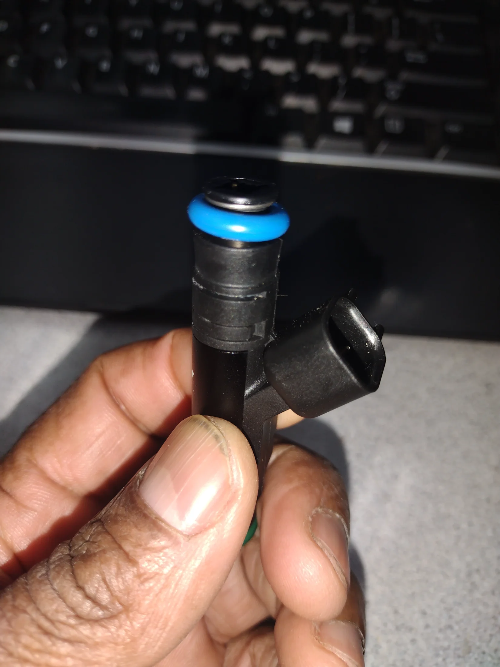

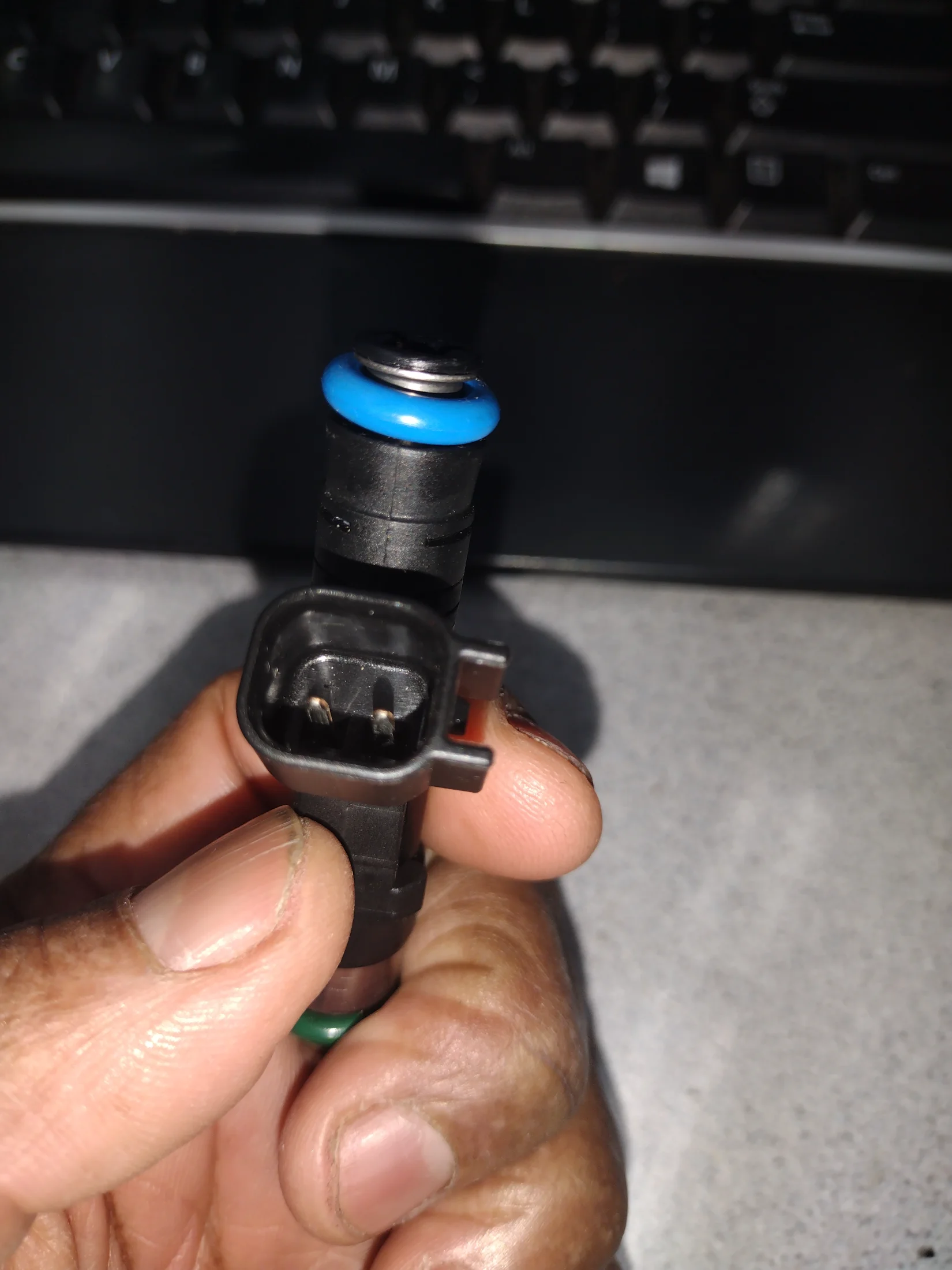

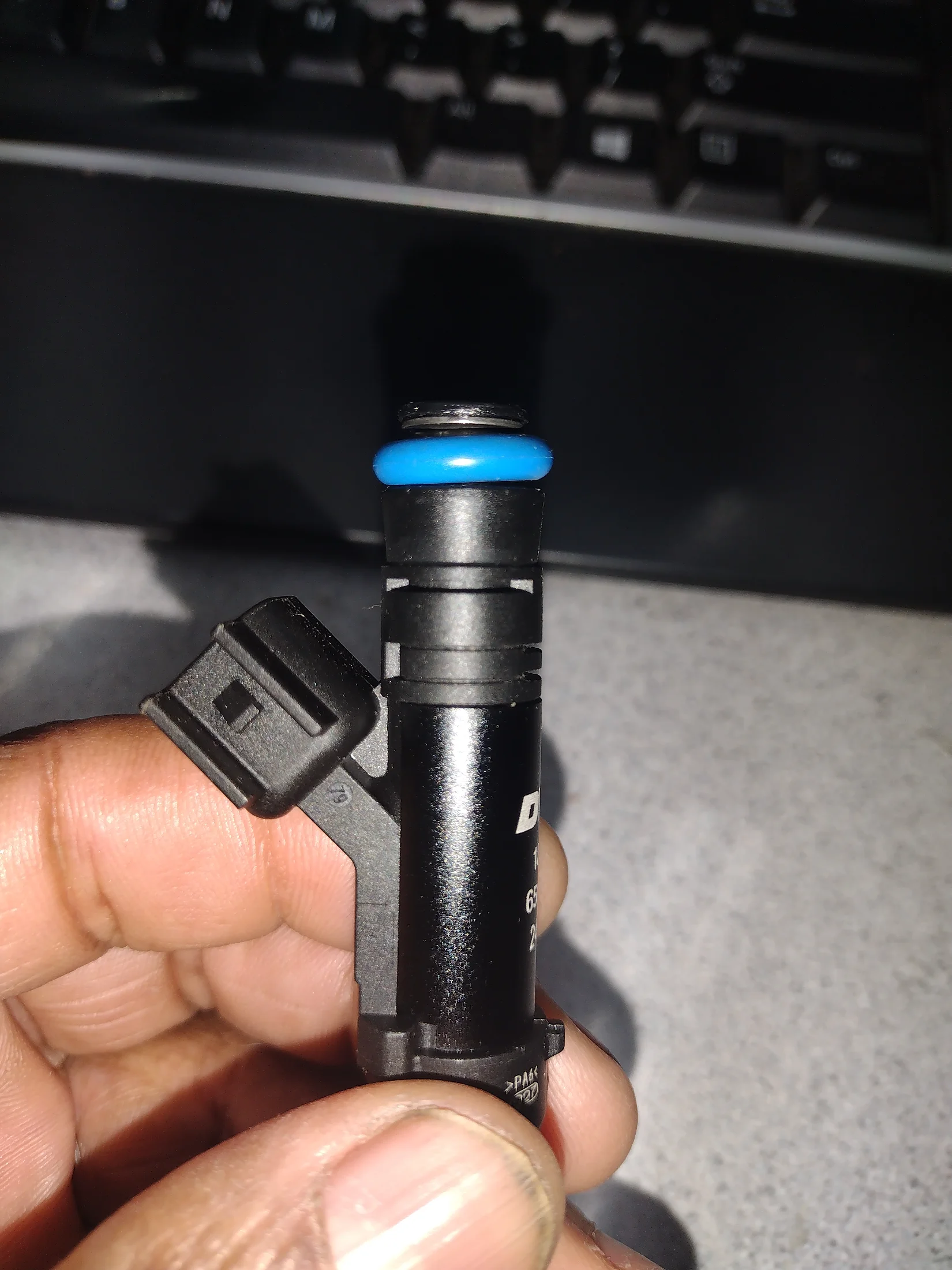

I looked over the o-ring with a flashlight as well as a magnifying glass and I don't see any evidence of any Nick I mean I don't I really don't since I greased them I don't know how it could have gotten a nick but you know I might just change it anyway to be safe. It's possible that the that side of the fuel injector rail I might have tightened it the other side all the way even though all injectors were in the intake and maybe that put that number five injector at a weird little angle or something. So maybe even though it did not start leaking initially when I fired the car up maybe the pressure on the rail or something caused it to eventually start leaking.
I definitely will make sure both sides are good and even and fasten each boat a little bit at a time and make sure things are still even. But I've never had an issue in the past with any injectors leaking

After looking over that o-ring on that injector very carefully with a magnifying glass and a flashlight, I swapped the injector from that spot to number six and it's not the injector itself it's that spot in the fuel rail. But that's crazy because and I just changed from 24 to 60s with the supercharger install and I never had an issue with the fuel rail. So yeah that particular spot right there I don't know what happened but none of the other ones are leaking so I need to research and see what's going on and why all of a sudden started leaking at that spot.
I know it was fully seated because I removed them all re-lubed and made sure everything was good to go. So in that particular spot whenever it starts leaking when I go and look at the injector I can see part of the blue o-ring so for some reason I think it's kind of popping out a tad.
