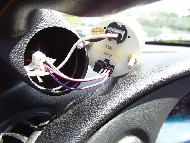

Is there anyway someone can look at the back of an autometer fuel pressure gauge and tell me which color wires go where in the harness? I somehow dislodged some of the wires from the harness and now have a constant reading of 100 psi......:bang: ..and I have no idea where they plug into the harness.
I have the ultra-lite version..but I'm sure there can't be a difference....but who knows
thank you :SNSign:
Hope this works, haven't posted a pic in a long time.
Looking at the back of the gage with the plug, plugged in, from top to bottom, right to left it should go, red black black empty empty
purple gray empty empty empty
