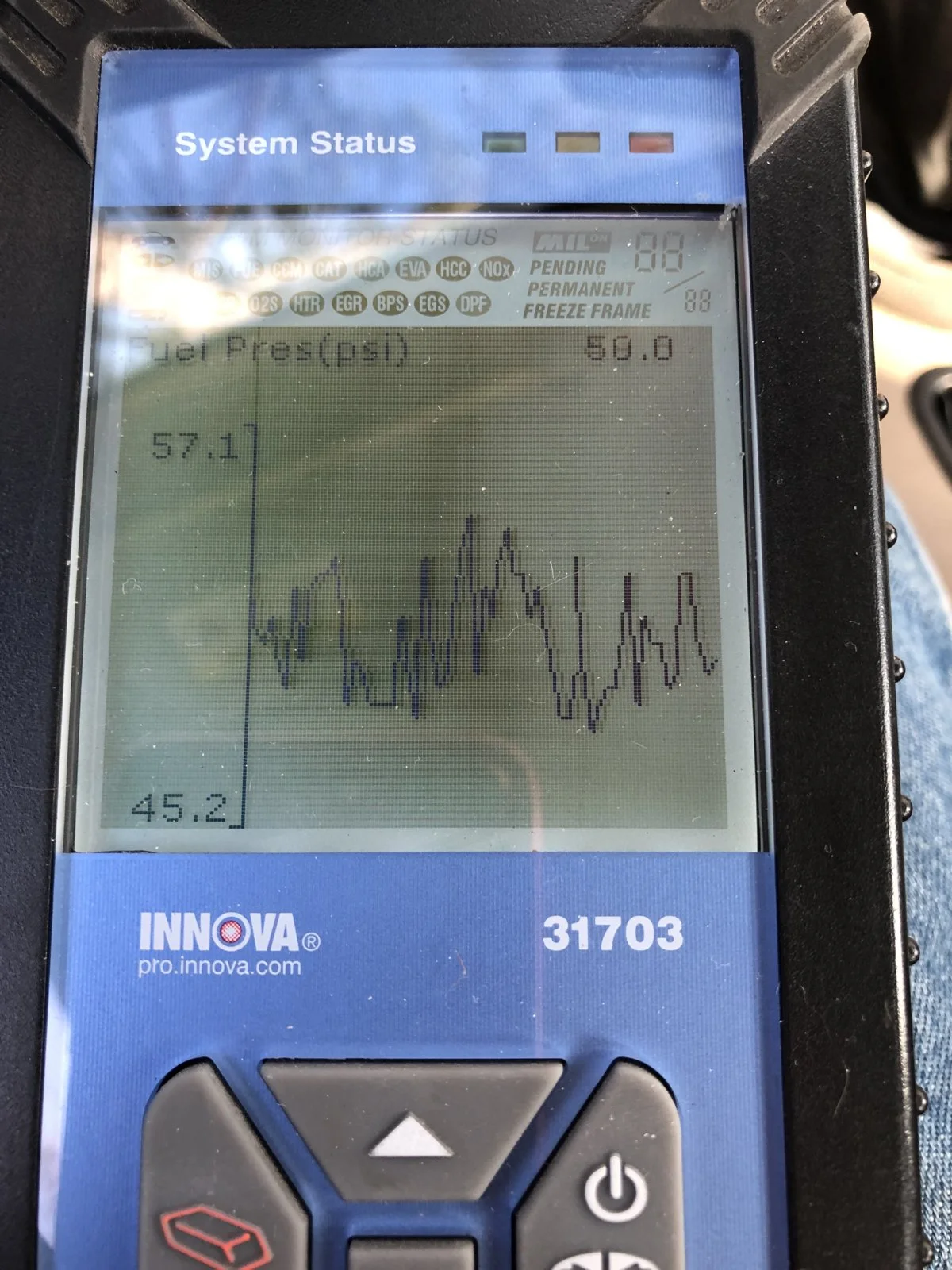

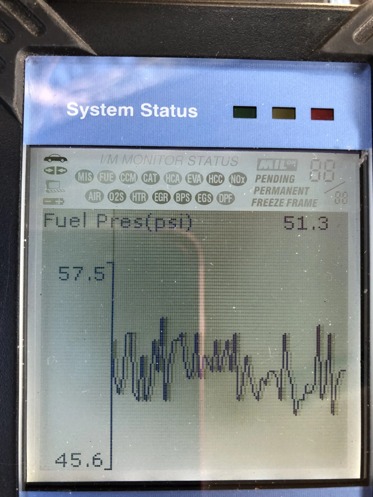

I used the graphing mode on my scanner today monitoring fuel pressure. Here are some pictures. The first one is at start up. The others are at idle. Of coarse the problem was not happening. I turned the car off and started it back up 7 times but could not create the problem.
I have gone out every day and started the car actually hoping it would act up so I may be able to trace the problem. The car starts right up and runs great. I even took it around the block yesterday but I am afraid to drive the car anywhere . I am scared it will shut off and not start back up. I don't think it would do any good to run any test since the problem is not there right now. I am very tempted to buy a new fuel pump and install it in hopes that will end the sometimes problem but hate to waste the money if the fuel pump is not the problem. A fuel pump is $200. I really do miss driving the car though.
