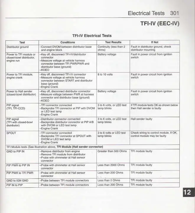

Sometimes a failing PIP sensor will set code 14. This is really a "sometimes" thing and you can't count on it.
If you had access to a distributor test machine , a hair dryer and an automotive oscilloscope, you probably heat the distributor while testing it and watch the oscilloscope for missing pulses. Unfortunately, that is a scenario beyond most of us ordinary people.

Ok looks like I need a distributor thanks for all the help.
