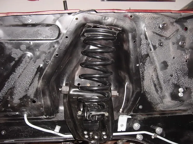

Do you have any picture? I still don't understand how to go around tower and how to be far enough (i.e. at least 3") from the exhaust. Am I near close as shown on the attached picture (black or pink line)? I can't find any picture on the Internet showing this area in detail.
The factory ran the fuel line on the outside of the fuel rail. Not sure about early 70's Stangs.
