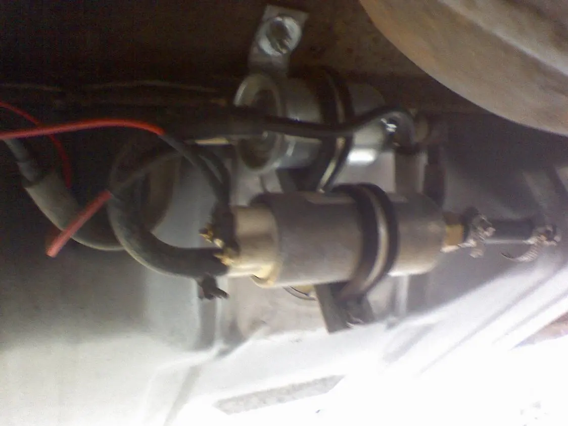

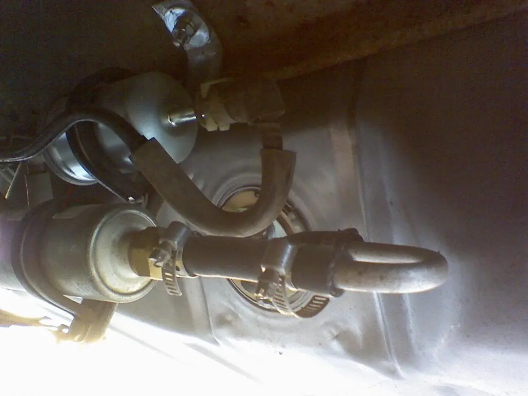

heres what i did
i made a bracket in a L shape it hangs down just in front of the tank and behind the rear end. it is mounted as low as the lowest part of the tank. also my pre fuel filter is mounted just above the pump. mabey i can get a pic for you.
also a relay is much safer than sucking 10 or so amps of current through a switch. so to me a relay is a must.

pics
this is on my 68 coupe it is a efi setup though.
That is almost exactly how I mounted the Holley red pump on my '68. Don't get a Holley red or blue pump, BTW; they are loud.
Yes, it should be relayed. It should also have an inline fuse on the high current side.

also i forgot
i used pieces of rubber beetween the bracket and the body of the car that kept the noise down alot more.
you can use a old sway bar end link bushing cut in half thats what i did.
