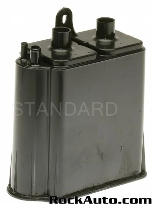

So, the cars seems to be running ok, nothing leaking from the fuel system. I've only been able to put about 20 miles on it though (work, weather, kids...) so I haven't run codes yet, hopefully this weekend. I have noticed an insanely strong smell that seems to be a combination of exhaust fumes and raw gasoline. The exhaust fumes seem more likely a leak than just normal exhaust re-entering the car and my guess is said leak is more towards the front end as I was driving with windows down and was still getting a face full. What concerns me more is the accompanying strong smell of raw gas (Especially under acceleration). Is this normal for these cars? As I said, other than a short test drive prior to buying this thing I've put very few miles on it and never owned one before. I could understand the raw gas smell if it were a carburetor car but not an FI car. Along with the new tank, fuel pump and sending unit, I also put in a new vapor valve and grommet. As I understand it, this vapor line runs all the way to the engine bay and dumps into a charcoal canister? Is it possible that this thing is no longer functioning and somehow releasing fumes? Any thoughts or ideas are welcome, Thanx.
