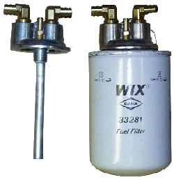

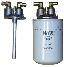

Check out the fuel accumulator from http://www.bcbroncos.com/. It runs about $80 and designed to use a low pressure pump to keep the resevoir full and a high pressure pump to the EFI. It also acs as a filter.

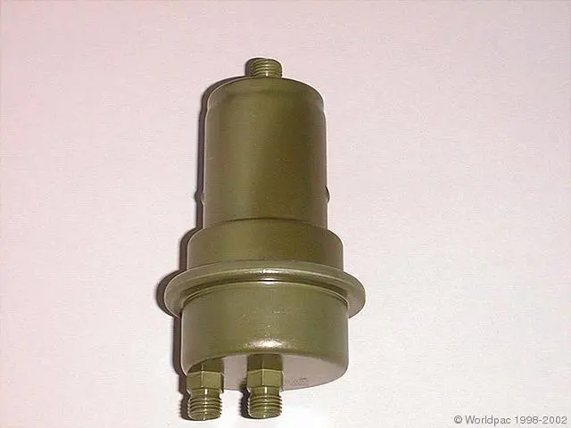

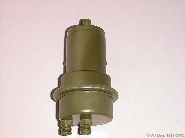

There is also an accumulator made for Porsche 911s for ~$150 that looks up to the job as well. The resevoir is a little smaller and you will have to run an external filter. I'll dig up a link later.
I sort of like this idea.
It is a good idea but I still am not fond of the 2 electric fuel pump idea, both being externally mounted, due to the noise and under carriage clutter issue. I think this is a great solution for those wanting something quick and easy if they are willing to deal with two pumps.
Many years ago when I first designed my system I played around with the idea of an external sump and 2 pumps but I wanted something cleaner and QUIETER but I think this type of solution is much better for most people with fewer tools and less experience in fabricating.

Here is the unit from a Porsche 911 Turbo. The fitting on the top is for a return line. The two on the bottom is an In/Out after the high pressure EFI fuel pump. This system only uses one fuel pump. Diagrams below.
You can purchase it for $115 here

Ah, I see....that is sweet using the EFI high pressure pump before the accumulator. That might work with the above filter/accumulator also as it is all a matter of positioning it and plumbing it correctly. If an external pump is acceptable then this setup looks very promising, easy, and relatively cheap.
BUT...THE CAVEAT!!!....it still does not exclude the need for a baffle in the tank to prevent the pump from starvation during turns and low tank situations so this is only part of the solution.
True. There is still risk of a pressure drop if air travels from the tank to the pump (cavitation). I was thinking of it backwards (accumulator before the pump) as in the BC Bronco solution.
The diagram details page does not discuss the design of the Porsche fuel tank. One can only assume baffeling exists. My gut says it does.
