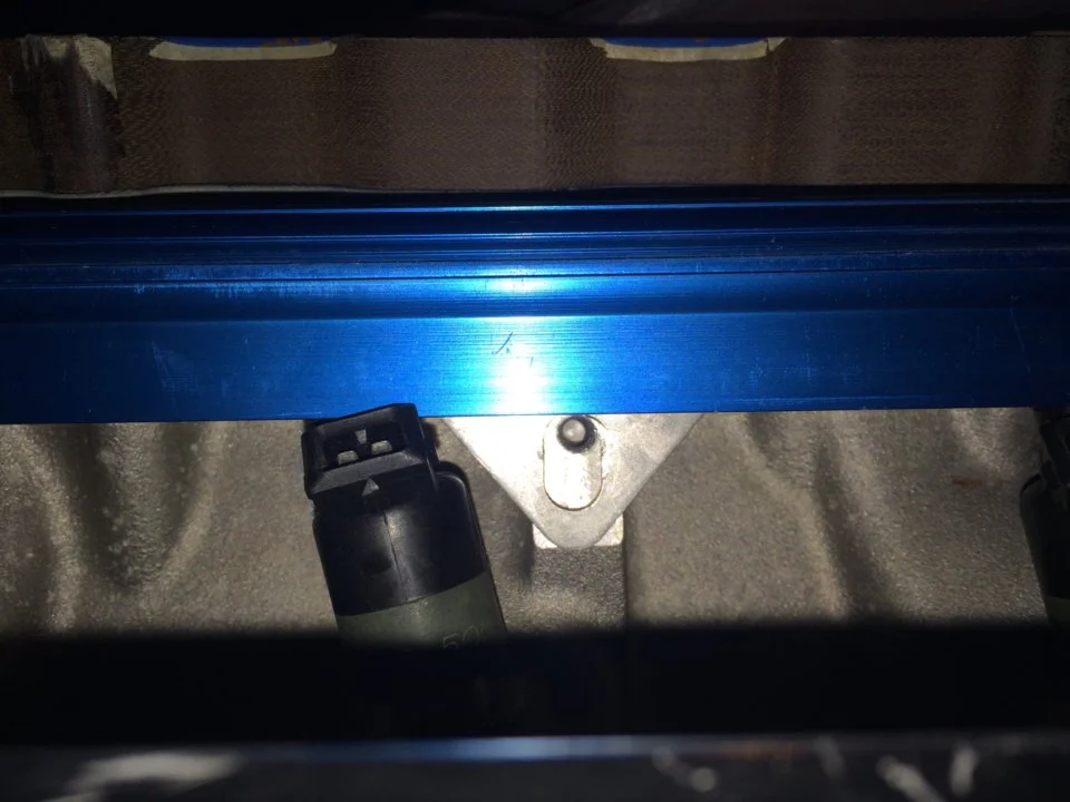

any suggestions would be appreciated. I got these aftermarket rails. Unknown brand. They were on a fox mustang 5.0 so i dont know why the bolt holes hug the rails so close.
A standard bolt wont turn because the 5 point part of the bolt head hits the rail. What should i do?
A small head machine screw with a round, cylindrical head and a hole for a hex wrench. I can not remember the name, but any hardware store with a good selection of bolts has them. They are usually black and the outside of the head is often knurled.
