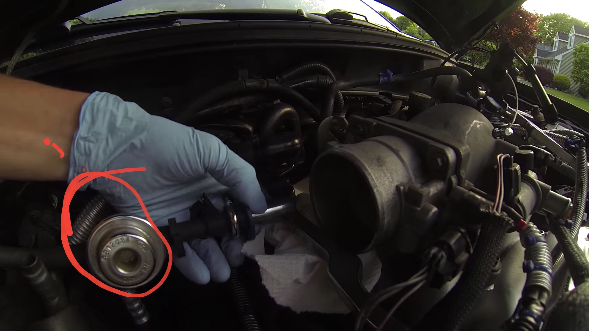

Having issues with the car (99 mustang gt) not wanting to start, have to prime the fuel rail multiple times to get it going and sometimes have to shoot some starting fluid into intake. Thought fuel pump was bad but car will run longer than the amount of starting fluid I used sould burn off so must be getting fuel. Getting p0193 fuel pressure rail sensors code and car dies if I rev the motor to fast. Is this in the pic the fuel pressure sensor? If not what is this and why is it in the fuel line? And could it be my issue? Car sat for a couple years without being run, have replaced gas in tank, fuel filter, oil change, air filter, and spark plugs to rule that out.

Thats actually a damper which means it acts like a shock absorber for the fuel system, reducing pulsations through the fuel line caused by the pulsing of injectors. Your Fuel Rail Pressure Sensor is on the driver side fuel rail. its a small box with a vacuum line and a wire conection.
Looks Like This:

I can sometimes start it by turning the key on and off 3 or 4 times, and when I do get it started if I don't press the accelerator to hard it will run for a bit, sometimes only a few minutes others times it has ran for 20-30 minutes. Will see if I can get hands on a pressure guage, the fuel switch in the back I did ensure was pressed in. Can't say for sure if I hear the fuel pump run, always working by myself and all the stupid dings and bells when you turn the key drowns it out, will need to find a helper. Thanks for the info on what that is attached to my fuel line and the pic of what the sensor I was looking for is.
