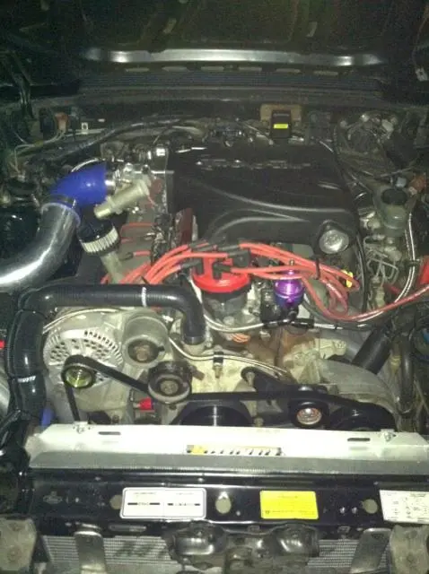

Hi guys, I used to own a built 93 LX, but sold it about 10 years ago. This week I purchased a nearly identical looking 91 LX hatch. It has a B&G 70mm Turbo on it and a host of other upgrades. For the price, I couldn't pass up a car this clean.
Anyway, it has a serious fuel system on it that looks something like this. (Aeromotive A-1000 Stealth System (Complete) 86-95 5.0 Mustang)
Fuel Complete Kit
Since I parked it in my garage I can smell a little bit of fuel coming from the car. I don't see any fuel leaks. Is it possible the smell is coming from the braided lines? I could smell the odor near the gas cap too so I have a new one of those on the way, but I smell it under the hood too.
Since my garage is attached, the fuel smell is making it's way in the garage.
I plan on taking it to a local Mustang shop, but right now he's booked up for a few weeks. Any help on where to look would be great.
Attached are some pics of the new ride.
