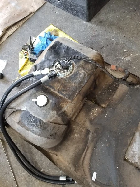

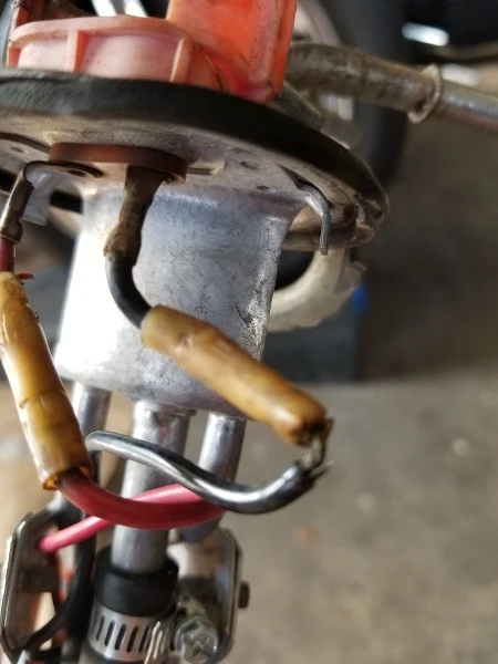

Every time I filled up my coupe full I could smell raw gas from the back. So today I dropped the tank, changed the vent, vent seal, fuel pump, and fuel filler neck seal. It wasn't that bad of a job. I used two floor jacks. I am glad I did this as someone previously had swapped the pump and did a crappy job installing it with questionable wiring.

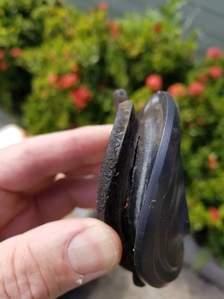

The fuel filler neck seal was toast.
I also put on new lines and a new filter. Just for piece of mind.
