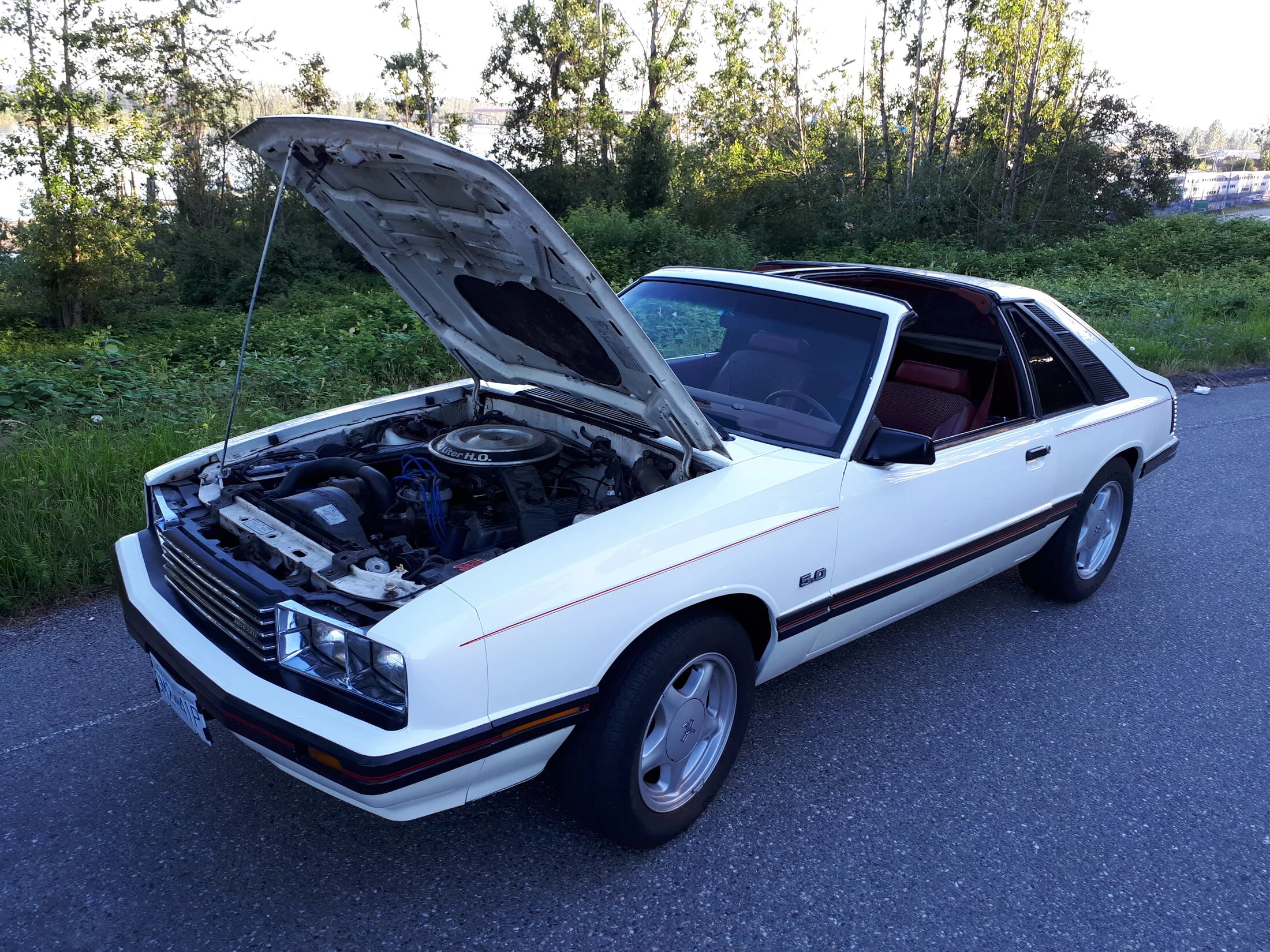

82 Capri, 5.0 tank is original and has a pickup problem. New Holly Snyper pump needs to be intank. Will a EFI tank from 83 Mustang or Capri fit? HELP.
