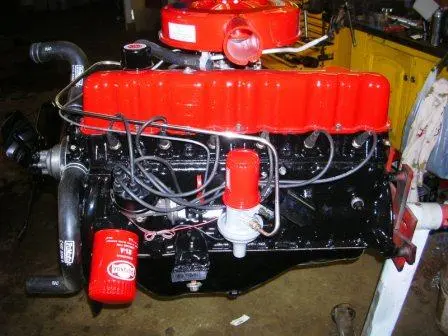

It's the big cylinder on top of the fuel pump.
