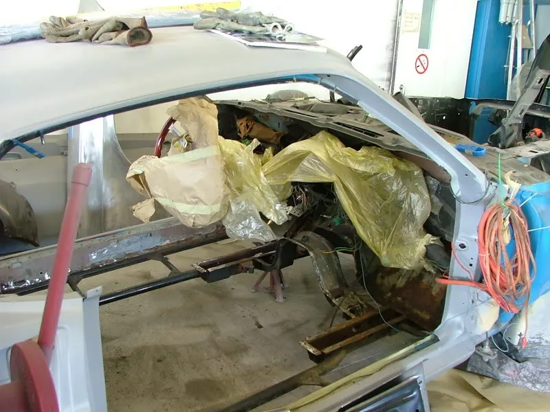

Here is a pic with the floor out

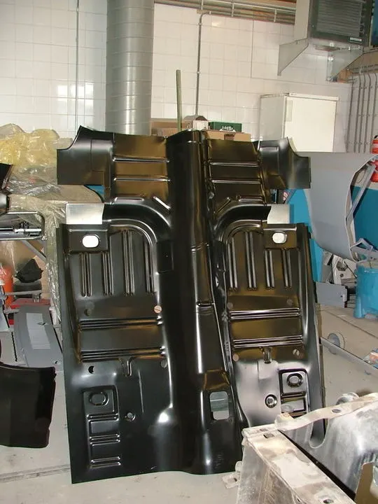

the floor pan that had to go in

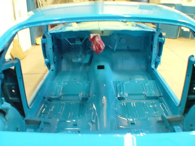

and the finished product
