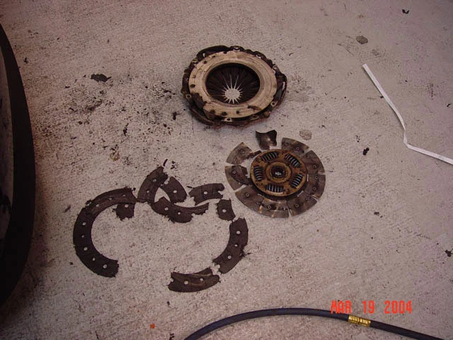

...one gear on an 80 shot did this... the clutch did have 85k on it though, i cant complain :D

here is the crazy thing, this was on the test run of the nitrous kit. 2nd gear, floored it, squeezed at 3200 or so...the car snapped my neck so damn hard, i saw the tach race up, i went for 3rd gear, and the clutch just went to the floor and didnt come back up lol. i knew instantly what it was, i had kinda expected it, squeezing on a stock clutch and all. i replaced it with a SPEC Racing Stage 1 clutch, and a Quadrant Cable adjuster w/ firewall adjustment (stock cable doesnt work for SPEC Clutches)

depends on your mileage bro, if ur pushing 60k or more on a stock clutch, squeezing will shorten its life fast. SPEC Racing clutch is cheap, good for 400+ rwhp, and partsshopper has them. the quadrant is a must, but its really not that bad of an install, but note this if u do buy it. mid way along the cable, there is a brass mounting bracket that goes where the stock mounting bracket was, along the left side of your engine bay. pry the crimp apart, and throw it away. take some big zip ties, and just make sure the cable isnt near the exhaust. this bracket is poorly made, and binds the cable up in the shaft, giving the illusion that you have a VERY stiff clutch, when you dont.
