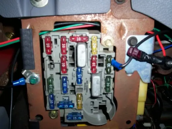

I'm installing a water temp and oil pressure gauge in my '87. I'm going to tap my backlights into my headlight fuse. How do you get around to the back of the fuse box? I can't seem to pull it through or twist it around.
if you are wanting to tap into the fusebox just buy a fuse adapter and install as i did in picture below...

I tapped into the wire coming from the dimmer for my gauge lighting so that I can control it along with the dash lights. Not sure if you can do that with tapping directly into the fuse box. either or should get your lights on though.
My dimmer has 4 wires coming from the back. Which one do I use?
EZMachN said:
I just checked and it is a 10amp in the #13 slot. I bought a 5amp fuse. Should I leave the 10amp or put the 5amp in?
I wouldnt even consider using more than the stock rated fuse. If there's an issue, I'd hunt it down.
