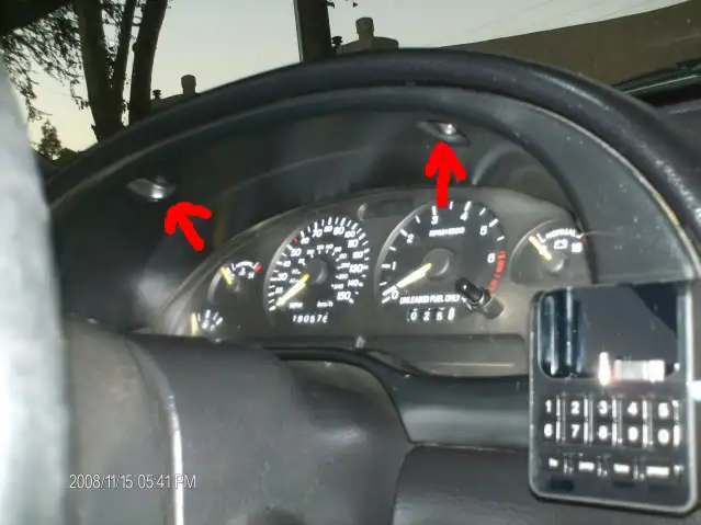

here's a mini-how to.not very complete,i was a little busy today:)

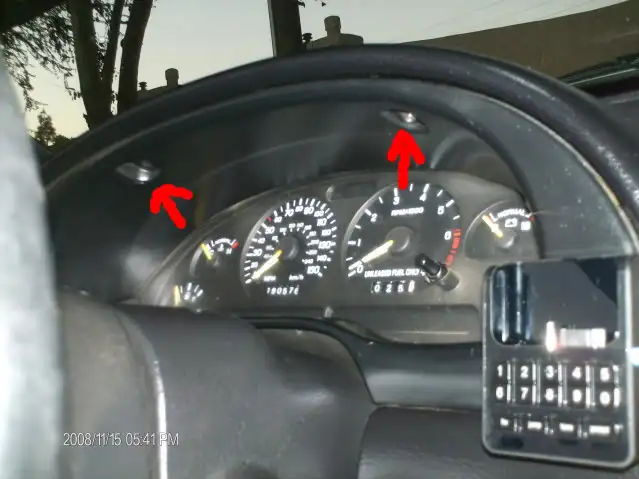

1.turn headlight's on.using a pick or small sloted screwdriver,release the little tab on the knob.push shaft back in to shut headlights off.
2.with a torx t-20 bit,remove the two screw's that hold the cluster bezal in place.
pull out.

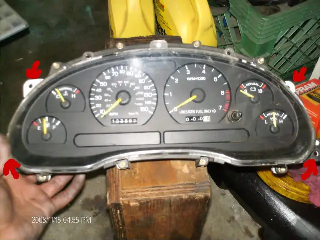

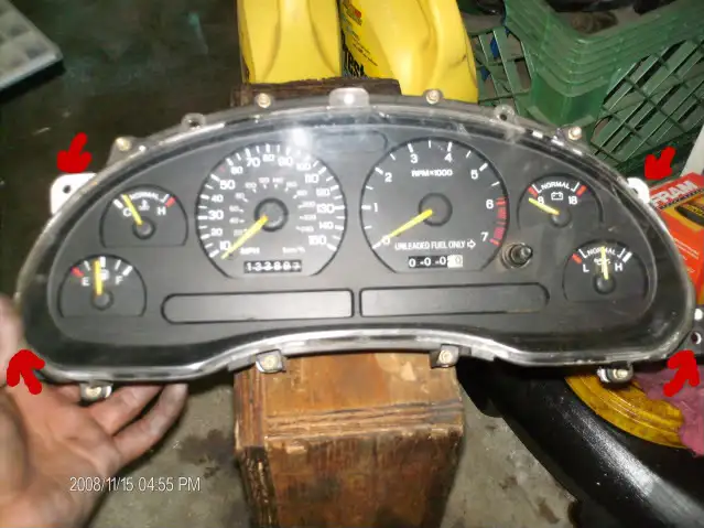

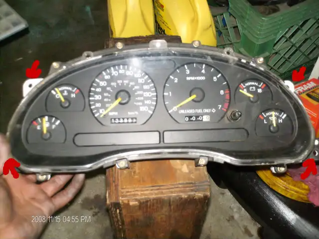

3.(imagine cluster in the dash,did not have time to disassemble mine:))
at arrows,remove the four bolts that hold the cluster in dash,can't remember the size,sorry.
next,pull forward a little,from bottom tilt upward and disconect the two electrical connectors in the back.

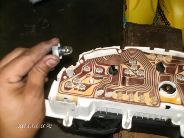

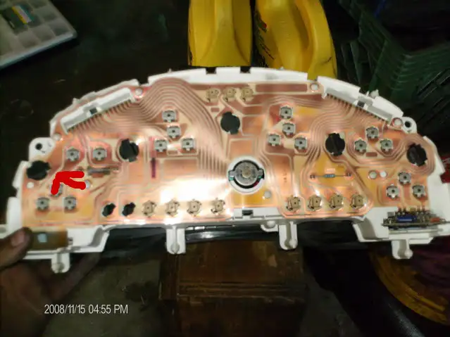

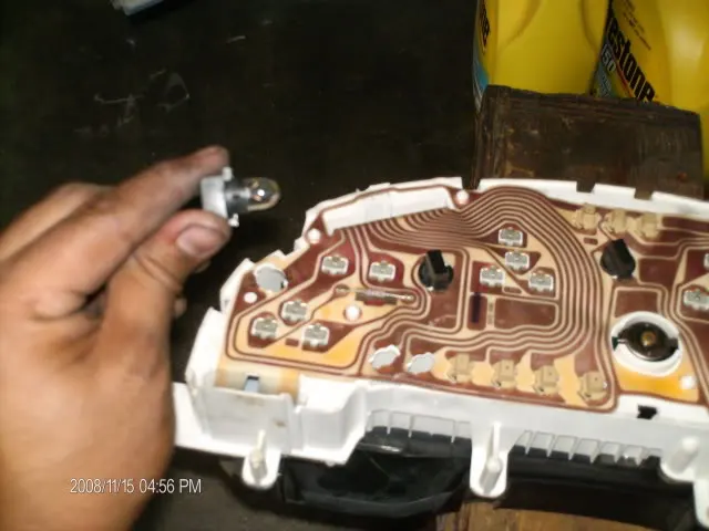

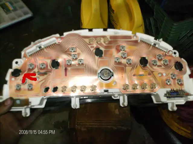

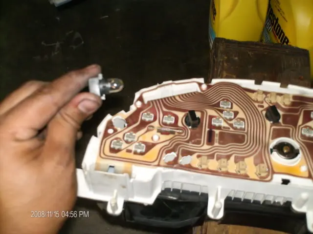

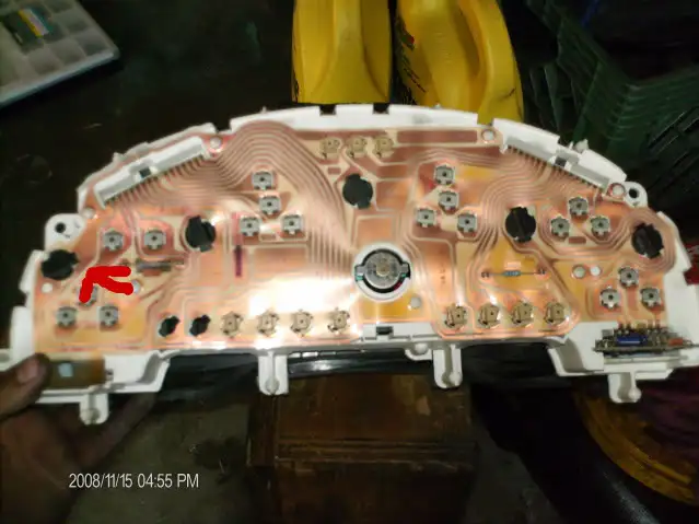

4.with cluster out,on the backside,turn the black (or blue) bulb holders and pull out.
pull bulb straight out of socket to replace.
i think the bulb size is 195.
install is reverse of removal :nice:

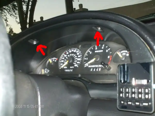

pull out.
