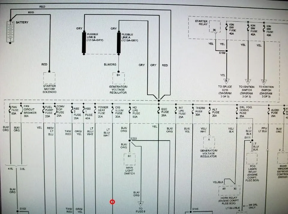

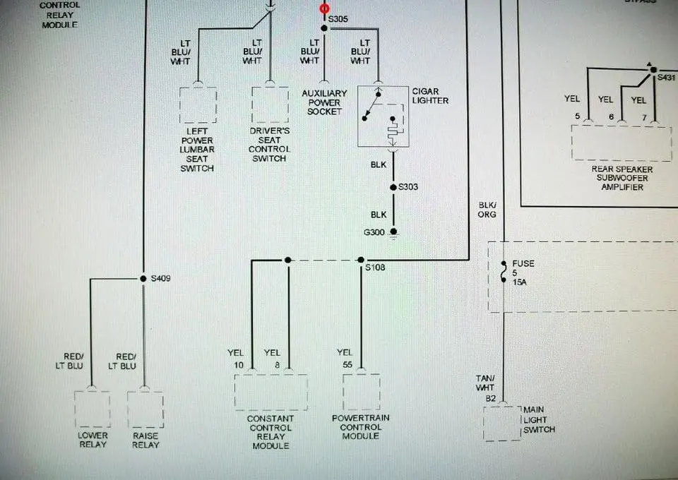

My lighter fuse keeps blowing as soon as I put it in the socket. The wiring diagram in the haynes manual does not show the lighter. What color wire is it I'm I looking for. The fuse box is located under the hood, driver side, on top of wheel well, 25 amp. Now that I have the PI Swap done I can address some of the smaller issues.
