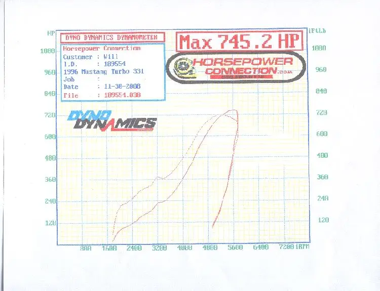

Let's see, where to start...... lol. Well we just dyno'd the car two weekend's ago and made some pretty solid numbers. After 5 pull's we ended up at 748 rwhp and around 730 +/- rwtq @ 20-21 PSI, This was done on 92 Octane pump gas and a little meth injection, A/F was 9.9 to 1 and air temps were at 80* with very little timing :hail2: (Side note: It took C16 + Tons of timing to get to the 700rwhp mark with the T76, Pump gas tune with the T76 was 550 rwhp at 13 PSI) So needless to say I was very excited, and then it happened.............................
After the 5th Pull and when we saw the 9.9 to 1 A/F my Tuner was going to lean it out by taking some fuel out and then we where going to call it good, I was thinking like 10.5 to 1 A/F with about 760 rwhp :nice: Anyways as soon as he started the car back up there came a knocking sound from the engine, Cylinder #8 to be exact, well after some investigation, checking Rockers and such and also using a micro bore scope camera (or whatever its called) to look at the Pistons and valves we saw that number 8 has a folded up mystery piece of metal sitting on top of the piston Everything looks perfect in the cylinder except for the piece of metal sitting on the piston :mad:

On a good note, here is the Dyno graph from the last pull, still need to lean it out more :D :
DART 331
AFR 185's
Trickflow R Box intake
F.A.S.T.
Bullseye S380R
3.5" Downpipe
92 Octane pump gas
AIS Meth injection
20 PSI
9.9 : 1 A/F ratio
Intake air temp @ 80 deg.
