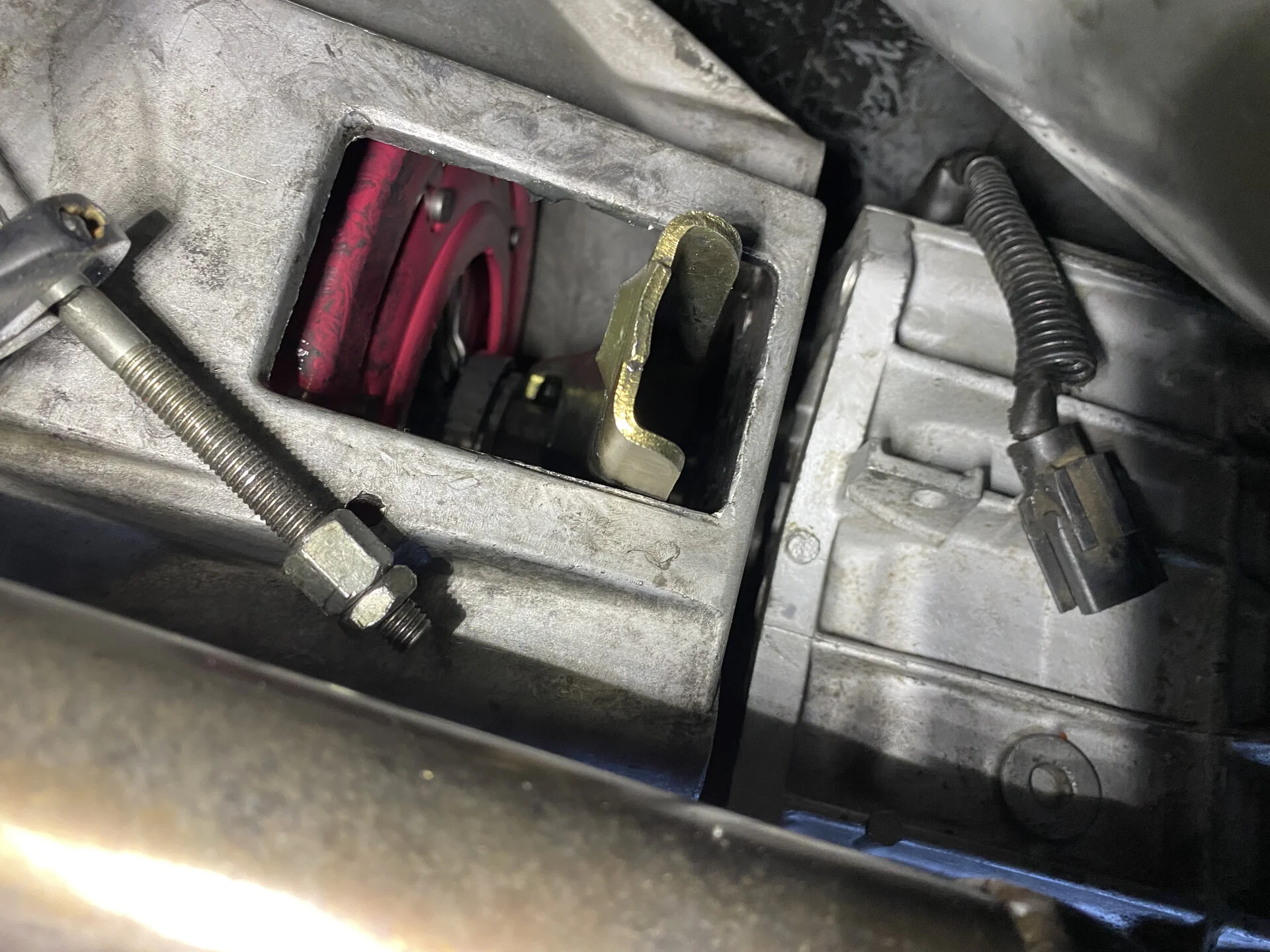

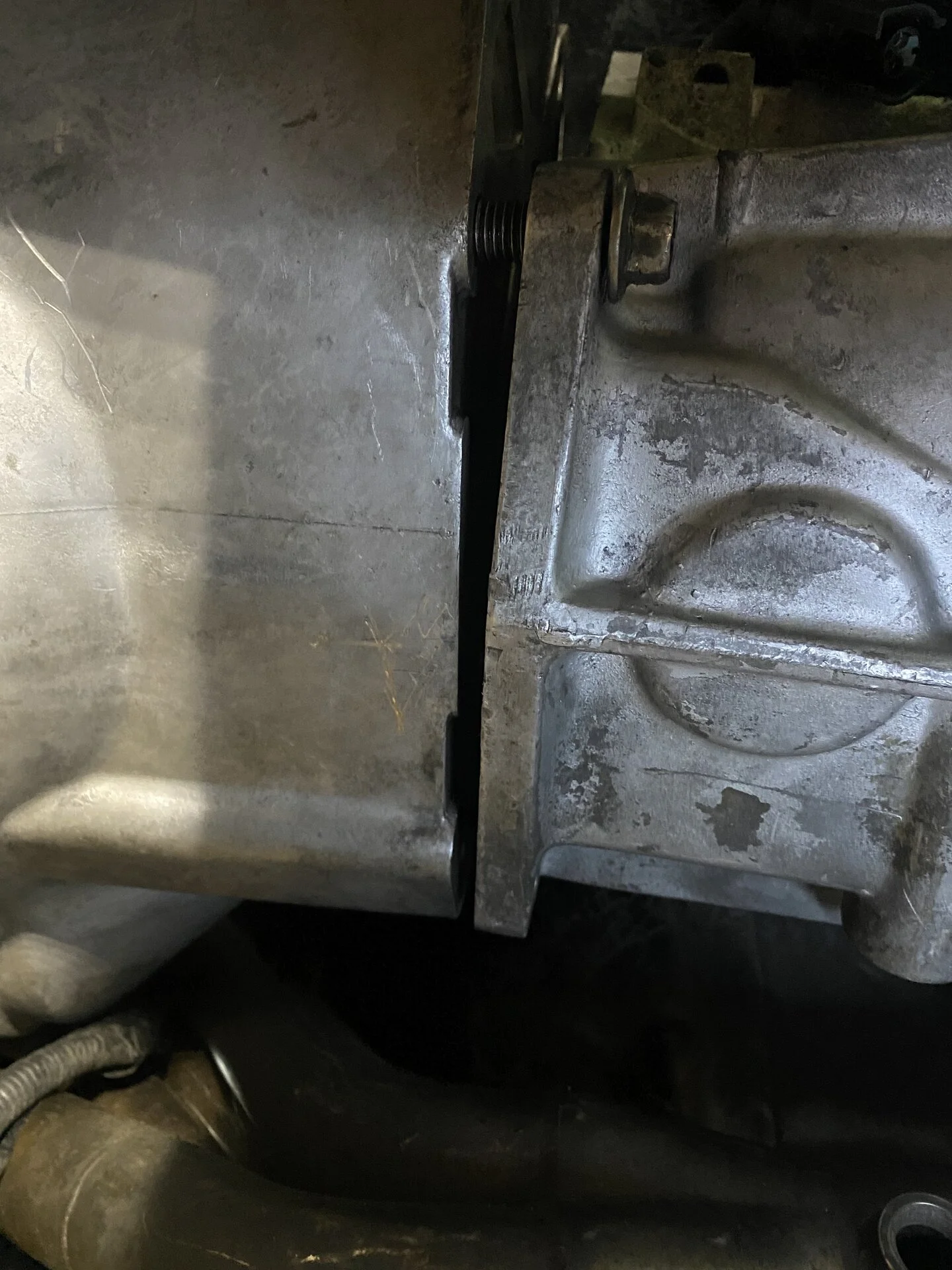

Had the G Force kit installed in my T5 case… I have the correct 26 spline clutch disc but can’t get trans to go “home” all the way.. I don’t have much experience except changing the clutch 2 other times in this same car… I can’t “feel” any interference when turning shaft while its seemingly positioned correctly..?? Any advice welcome. Tried it for over an hour and never had this much trouble with stock deal.. am I doing anything wrong??
Thanks gentlemen!
(2nd pic is misleading, view from bottom) … bolt is in bottom, and just there so it doesn’t fall out no forcing going on
