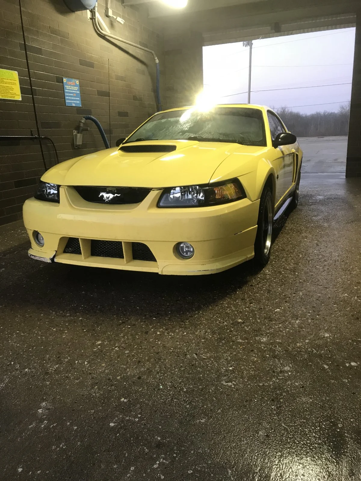

Hey guys, I have an 01 GT and The only mods I have under the hood are a BBK throttle body and a Roush Cold Air Intake. I also have a Terminator 6 Speed Tranny in the car. I am only being able to get about 120 miles in a full tank of gas. I am going to have to sell my dream car and get something better on gas if i cannot get decent gas mileage out of mine. if anyone can help me i’d appreciate it !!
