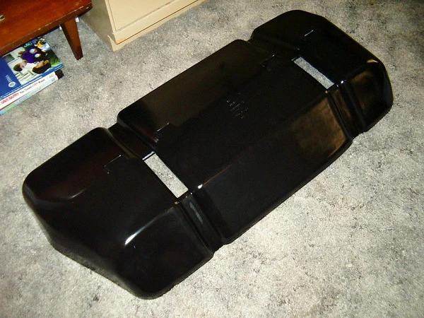

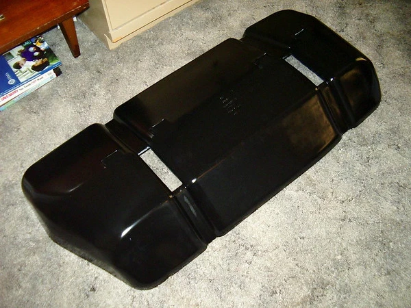

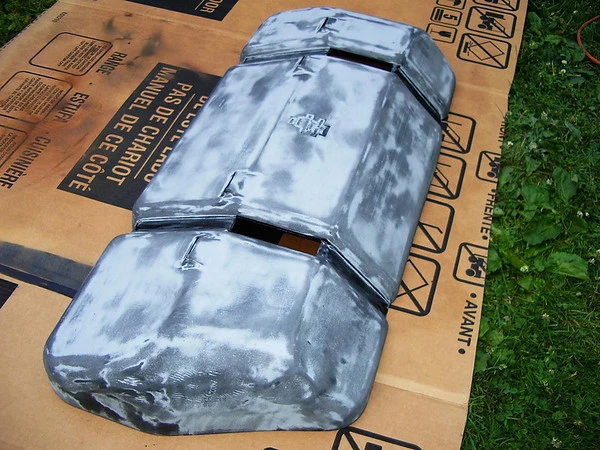

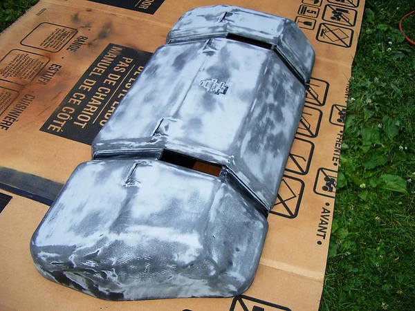

I sanded mine down to get it smooth and then used filler primer and wet sanded it to make it like glass.
Then I painted it gloss black.

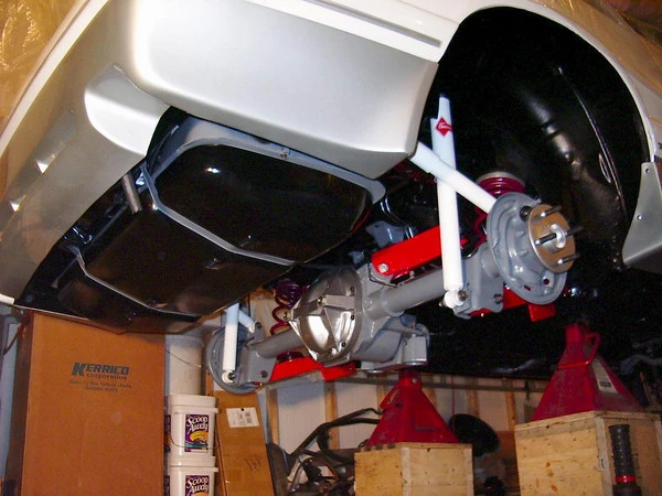

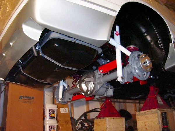

Here it is installed over a new gas tank... turned out pretty good I think.
