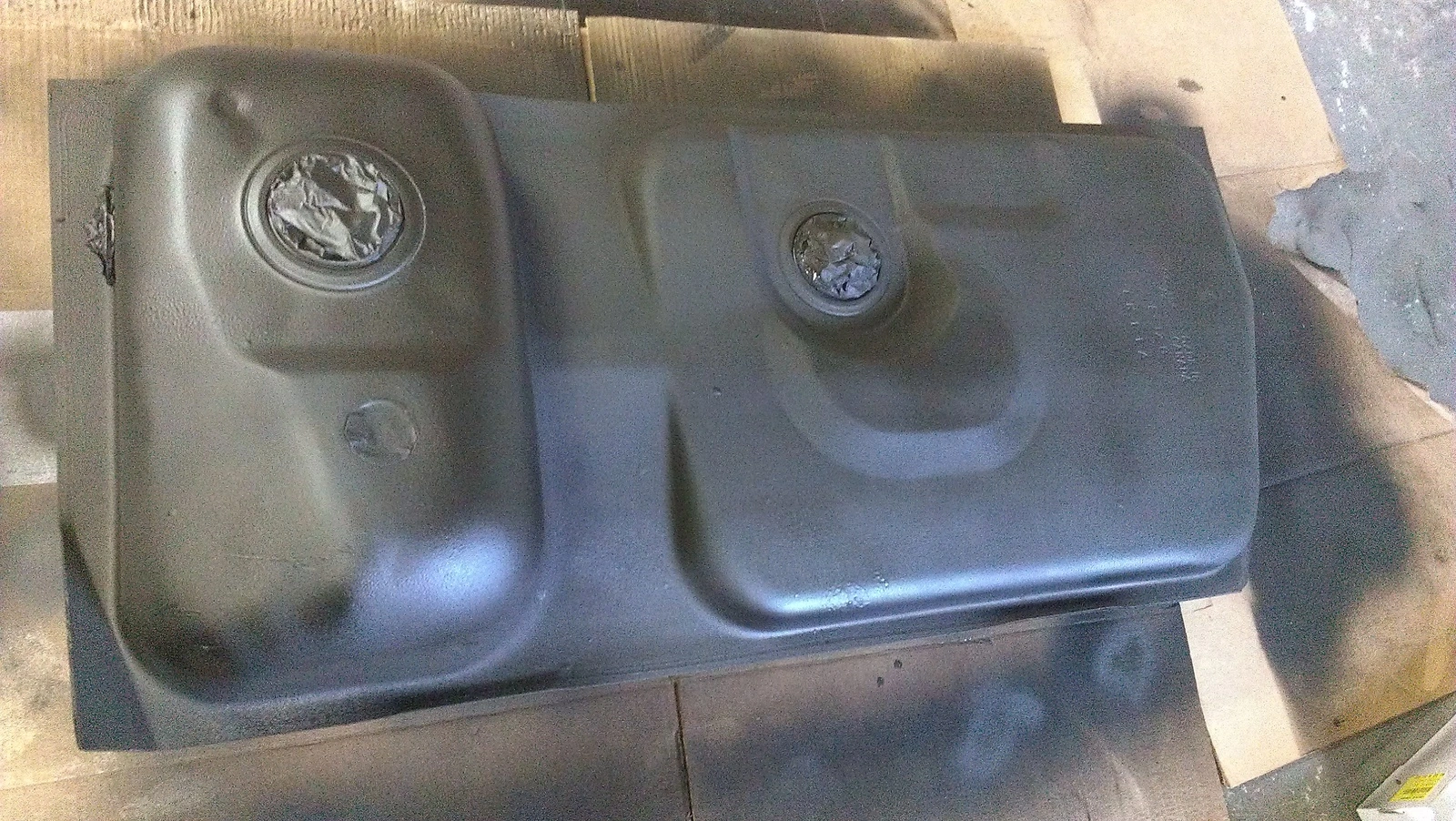

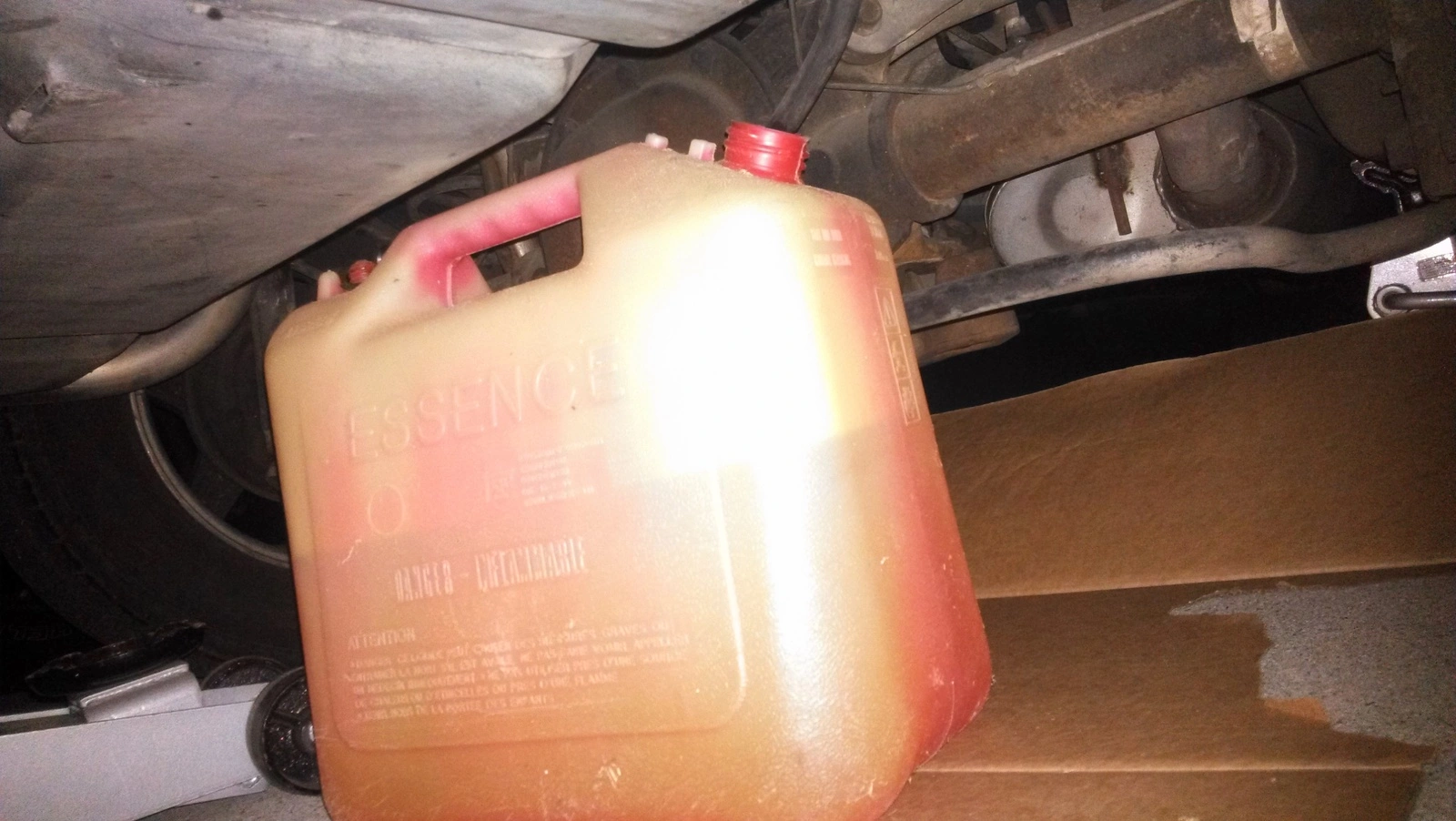

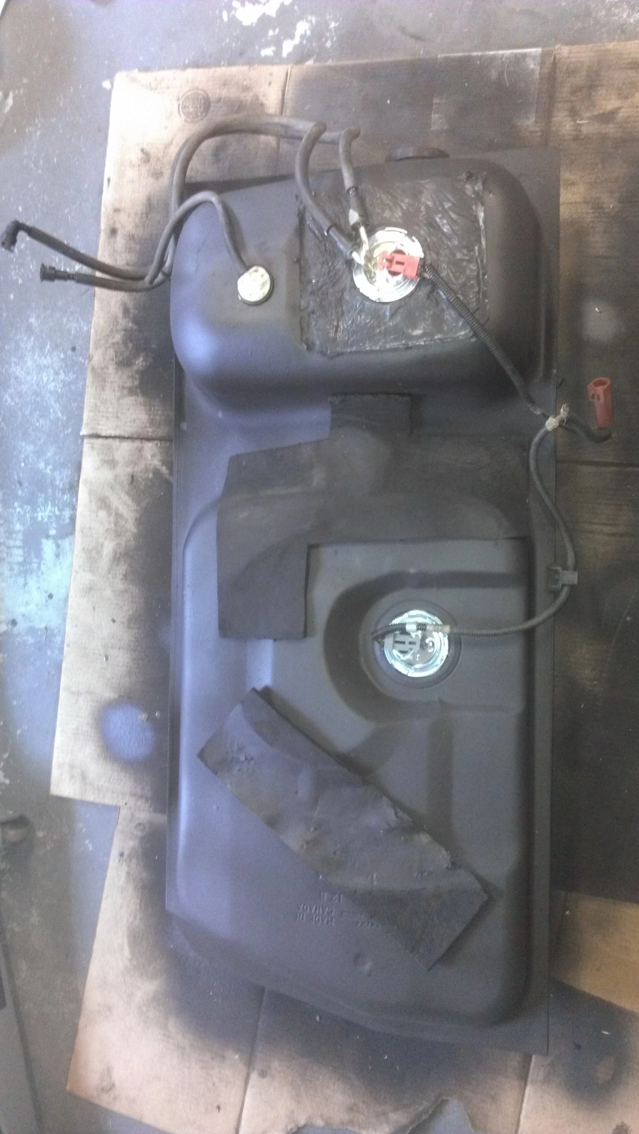

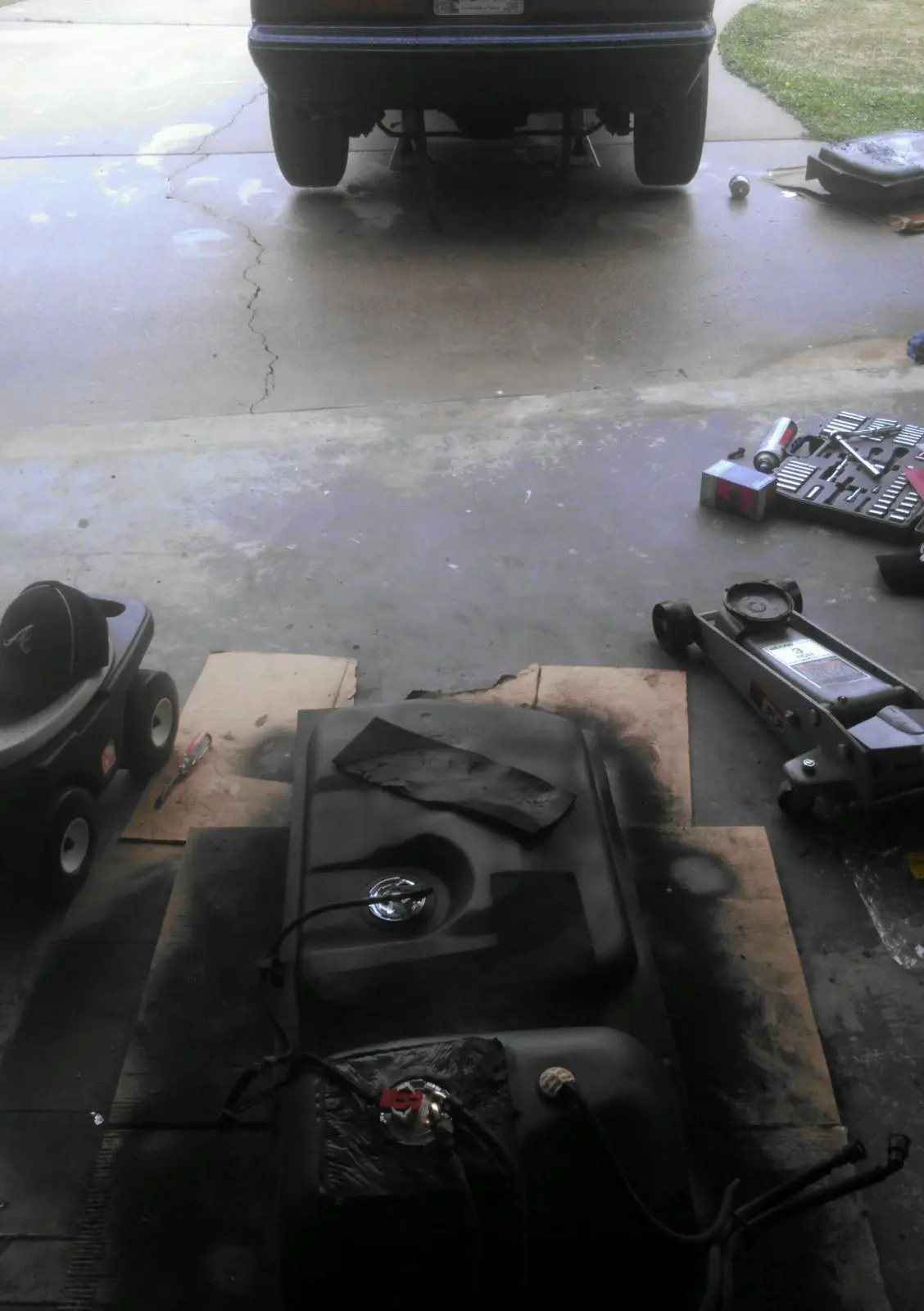

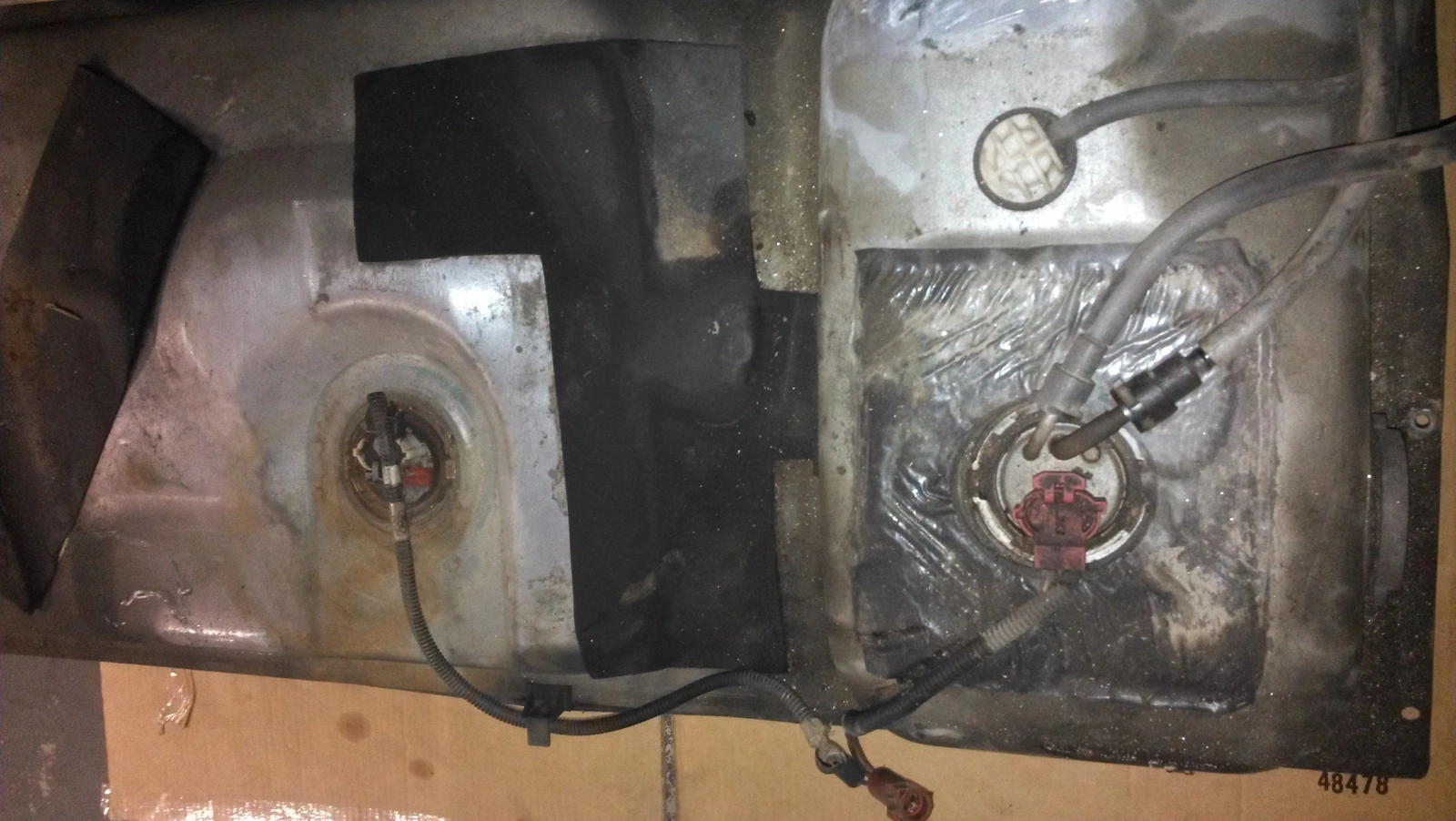

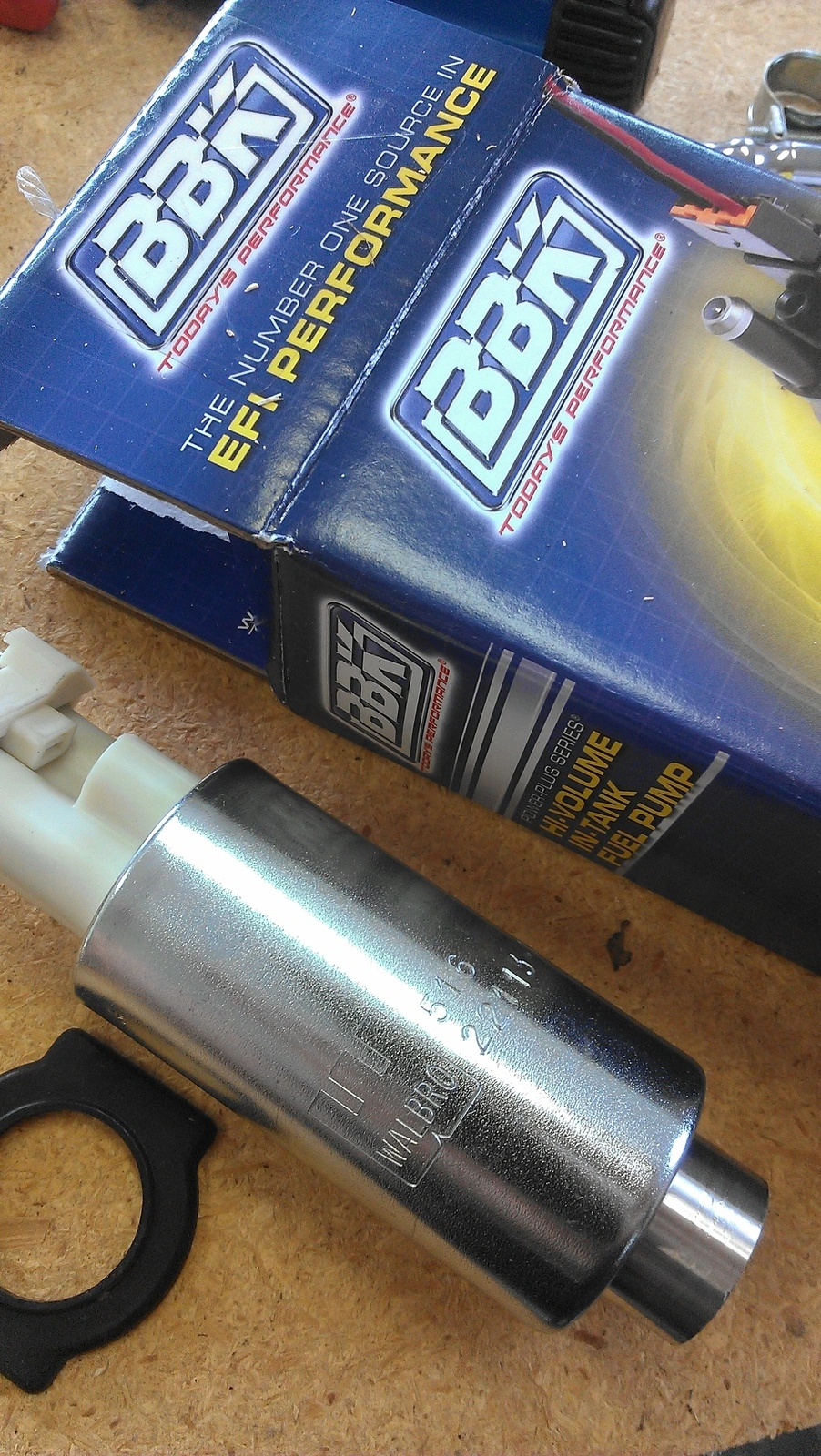

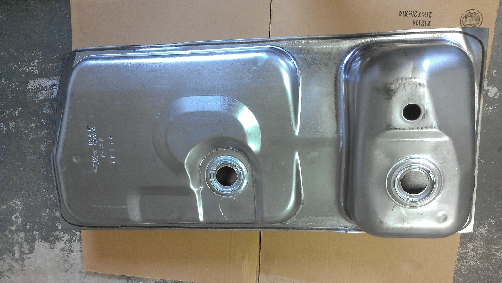

So i been having a intermitant fuel pump issues and my gas tank was leaking from a couple spots. Also had more gas in the take than i wanted too when i started the swap. So i removed the fuel feed line from the fuel filter, placed it in a container and just cycled the key forward in the ignition until it was pretty low on the gauge. Think you can cycle it from the jumper wire in the test port also but i just felt like doing it this way. Here are a few pics of old stuff and new stuff, also have a pic if the new BBK 155lph fuel pump, notice who's name is on it and it says Made in the USA :nice:

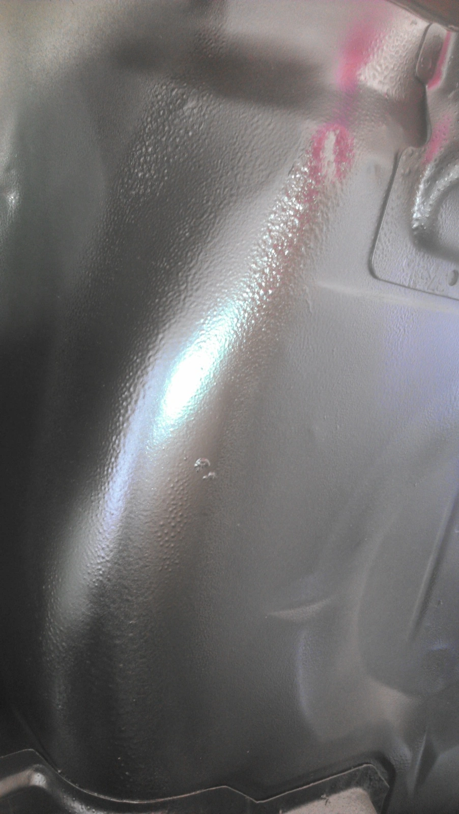

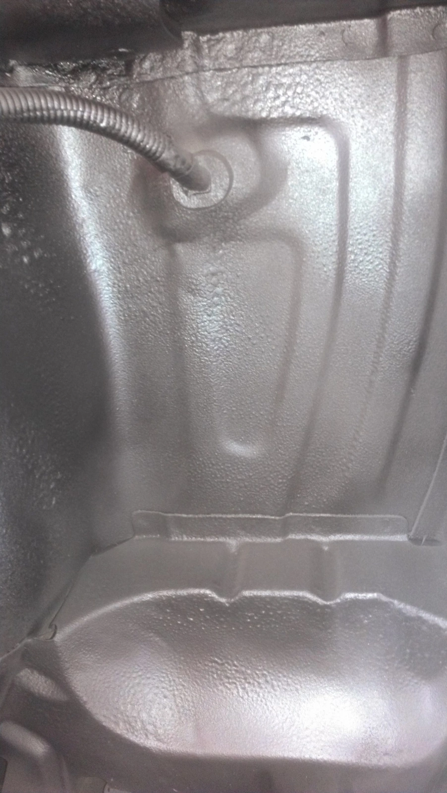

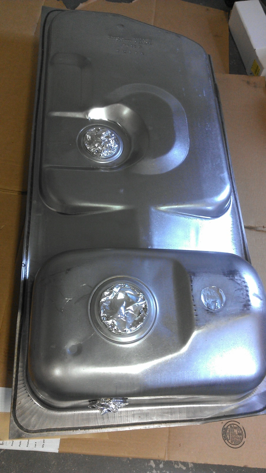

Also coating the new tank with some rubberized sh!t, says it deadens sound too.

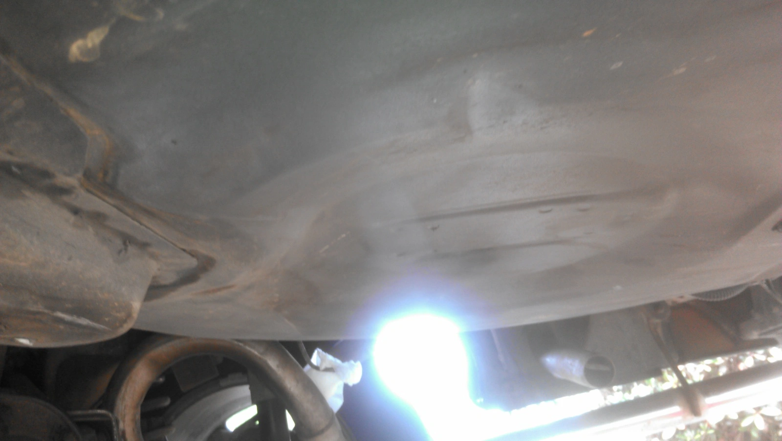

Here she is all back together, really like how the rubber coating spray sound deadend the gas tank, went ahead and cleaned and sprayed the under side too, couldn't hurt adding more sound deadning under the spare tire area to help with road noise.

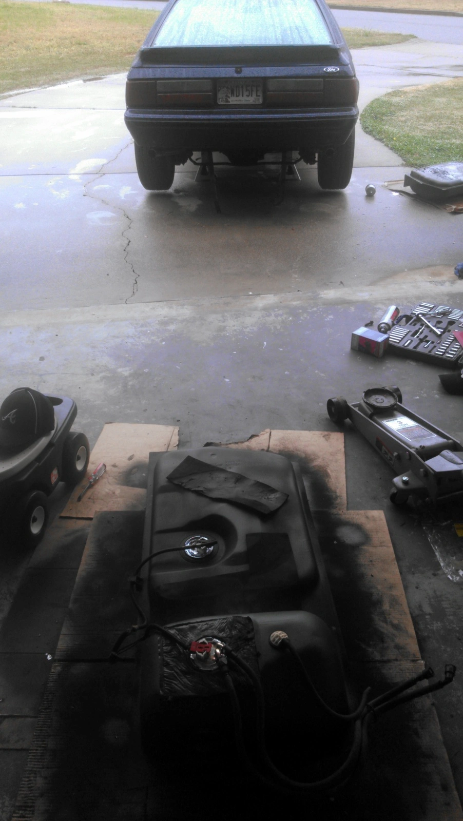

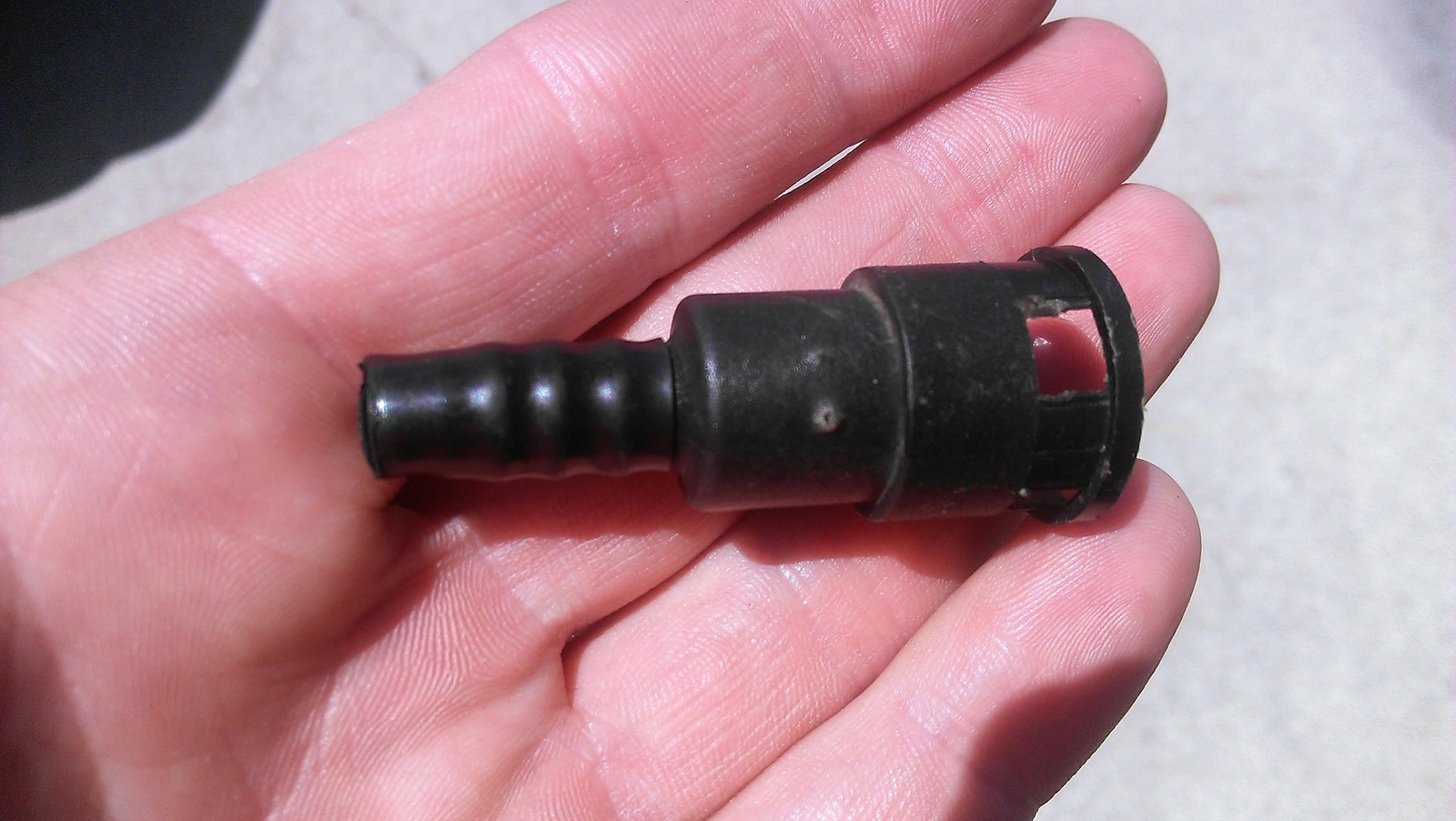

So I waited the rain out and then slid the tank underneath to hook up the lines, went to check the fuel pressure with a couple key forward cycles and wouldn't ya know my fuel pressure feed line had a couple pin hole leaks in the plastic coupling at the housing on the tank ....FML:bang:
So that means my old tank probably isn't leaking like i thought :nonono:
Still needed the fuel pump so while i was there, thought I'd just add more money :rolleyes:
This is the part that screwed me, it was on the underside so i didn't see it. Had a small fountain stream when i slid it one way or another, ...Lord watching over me when it was on my old tank that i thought was leaking ....Wheeeew!!!

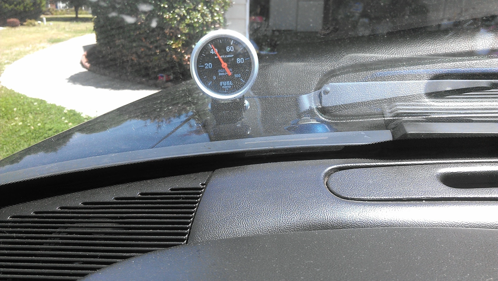

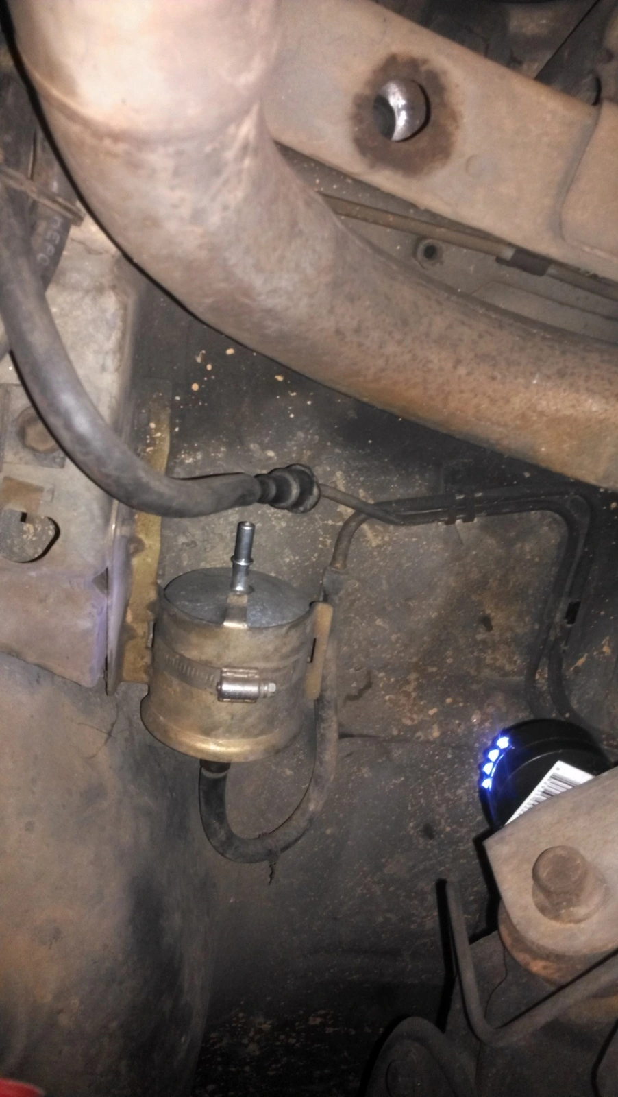

Just went and got some new fuel line and just ran a hard line from the tank to the filter. Psi is at 39-40 but when i shut it off it raises a hair.
