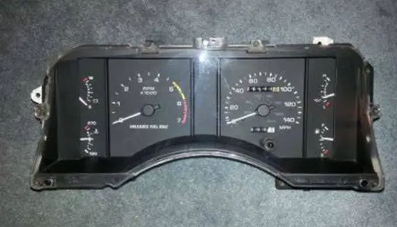

Z Zeke1995 Member Jun 15, 2025 15 2 13 North Carolina Jul 14, 2025 #1 Jul 14, 2025 #1 question y’all. My speedo is broke in my 91 LX 5.0. I have AOD. Can I put a 5 speed 91 LX 5.0 cluster in mine for a replacement? Any difference ?

AeroCoupe lube between the nut and the face. I know my lubes Founding Member Oct 28, 2001 6,239 4,333 183 Claremore, OK Jul 15, 2025 #2 Jul 15, 2025 #2 Zero difference. Transmission has nothing to do with the cluster.

Mustang5L5 That is…until I whipped out my Bissell Mod Dude Feb 18, 2001 43,374 18,121 224 Massachusetts Jul 15, 2025 #4 Jul 15, 2025 #4 Zero difference. Any 90-93 V8 cluster will work. Reactions: General karthief
Z Zeke1995 Member Jun 15, 2025 15 2 13 North Carolina Jul 15, 2025 #5 Jul 15, 2025 #5 Thanks! Am I good with any 90-93 140 mph cluster then ?
gkomo now i can hopefully expect to receive the shaft Aug 2, 2024 2,342 1,550 133 San Diego, CA Jul 15, 2025 #6 Jul 15, 2025 #6 I think all the 90-93 clusters are 140mph clusters right?
AeroCoupe lube between the nut and the face. I know my lubes Founding Member Oct 28, 2001 6,239 4,333 183 Claremore, OK Jul 15, 2025 #7 Jul 15, 2025 #7 That is correct. The ones that are 0-85 mph are the 4 cylinder and the tach will not read right.
Mustang5L5 That is…until I whipped out my Bissell Mod Dude Feb 18, 2001 43,374 18,121 224 Massachusetts Jul 15, 2025 #8 Jul 15, 2025 #8 Make sure it has the clearance hump at the bottom for the airbag column. 87-89 clusters are flat across the bottom. There are wiring differences, so don't snag one of those. Reactions: General karthief and AeroCoupe

Mustang5L5 That is…until I whipped out my Bissell Mod Dude Feb 18, 2001 43,374 18,121 224 Massachusetts Jul 16, 2025 #9 Jul 16, 2025 #9 Just to add. Mileage can be adjusted as well pretty easy if you want to match your old cluster.
AeroCoupe lube between the nut and the face. I know my lubes Founding Member Oct 28, 2001 6,239 4,333 183 Claremore, OK Jul 16, 2025 #10 Jul 16, 2025 #10 Wait doesn’t someone here have a video on that…now who could that be? View: https://youtu.be/o42xqBCfLpA?feature=shared Reactions: General karthief and Mustang5L5
