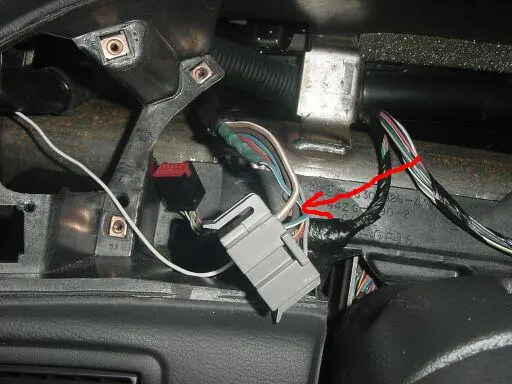

Well i just got the indiglo gauges for my car, the only thing is that i dont is know which wires do i need to splice into so the gauges light up.........any one with them have changed their gauges?? i dont wanna start just splicing all the wires until i get the right ones......
For my gauge pod, I used the blue/white wire comming out of the dimmer switch. I think it is marked on the switch too. It is the power to the factory dash lights. Double check first, I'm not sure how consistent Ford is with wire colors.
I beleive the blue/white will work as well, but on my '03 i spliced my indigloes to a Brown wire to get it to work with the inteior lights.
The black wire just gets grounded...there's a nice bolt to the right behind the cluster that you can wrap it around and tighten up for a ground.
