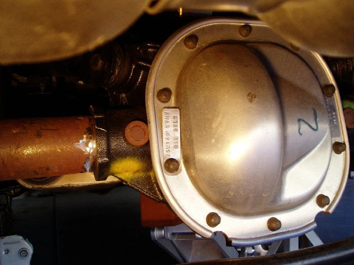

There is a tag right on the differential bolts that says "75-140 synth only". I would suggest that. Get the lube and the friction modifier from the Ford Parts counter. End of story.

BTW, I didn't see a tag on my diff. unless it was removed at some point by the previous owner or when my fluid was first changed.
