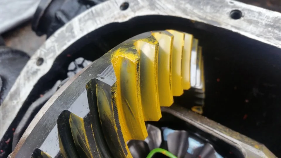

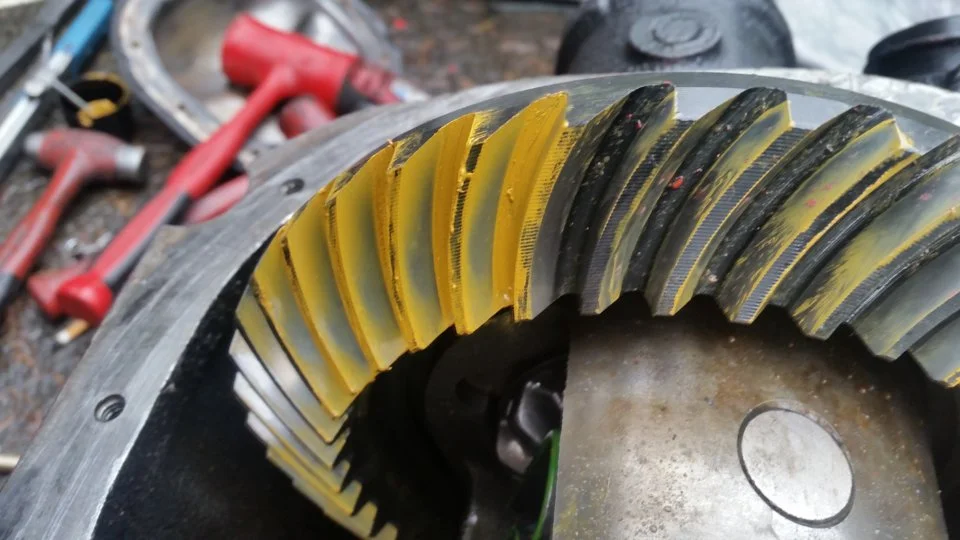

.034 shim set up

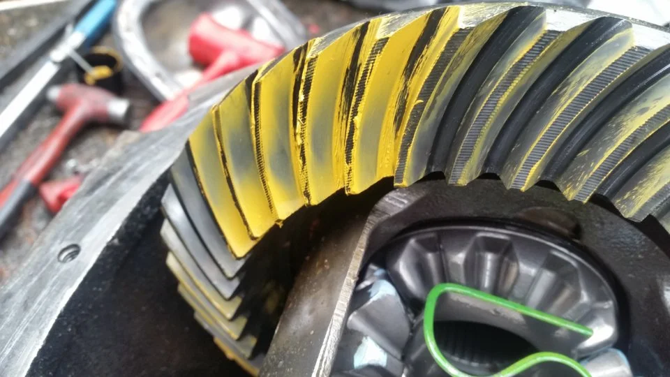

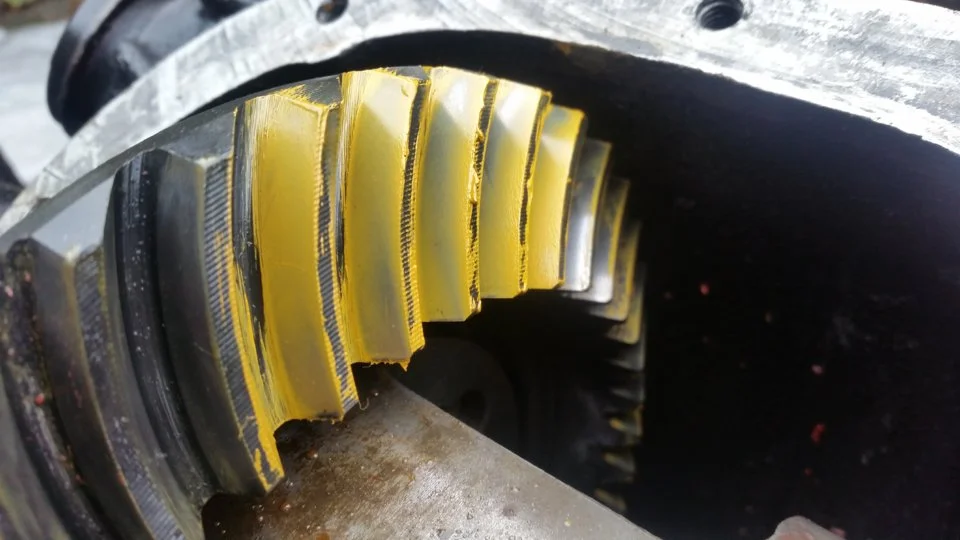

.032 shim set up
View attachment 545182 I got a set of used gears 3.73 that have 3-400 miles and I'm setting them up. Need a little help on the pattern. Here are a couple pics. The first two I have .034 for pinion shim. The second two pics are with a .032 shim. What would you guys recommend. Also the seller said he had minor deceleration whine with these gears.
