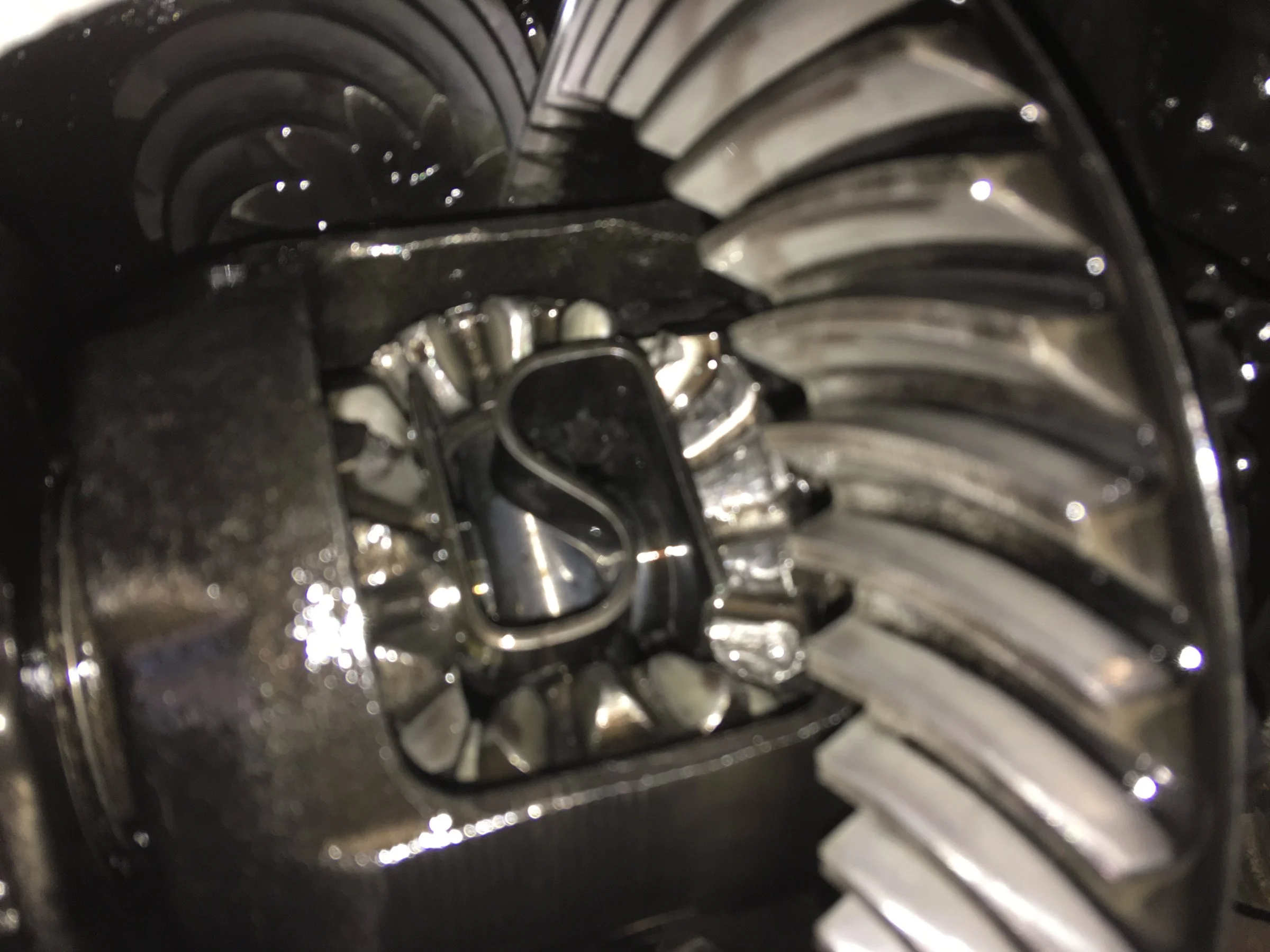

I also have a 2005 GT and mine is a manual it came stock with the 355 I switched them out right away for 373 I really liked them for dd kinda fun in the city driving but on the highway @ 70 mph the RPMs would be right at 1,800 in 5th gear used those gears for about 4 years but I wanted more pep in my step around town so I just installed 410s yesterday just because my spyder gears just stripped out from all the hard launches at the track so I decide to also upgrade the ring and pinion one more time

Those spiders are chewed up lol did you install the 4.10 gears yourself how do they compare to the 3.73?

Nitto nt05 drag radials 305/45r18 are the tires And yes they are quiet if they are shimmed correctly and they are the Ford racing gears both sets and the 410 gears are around 2300 RPM at 70mph
