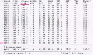

While it's apart, install a C9OZ-6250-C cam, Performer RPM manifold, 600 cfm carb (I like the Summit) and have your distributor recurved to BOSS 302 specs.
All low-buck upgrades, but this is what you might expect:
