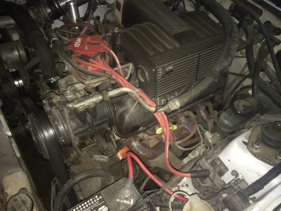

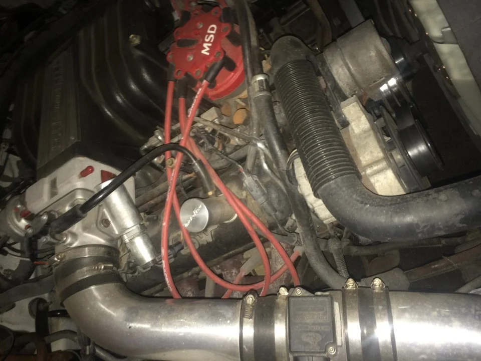

Ok here's a pic.. sorry it's getting dark out..
Man, those are terrible pics. I can't tell you if those are TFS heads- pre 2001 do not have any markings on the front - after 2001 it will say TFS or Twisted Wedge. You have a non EGR Explorer/Cobra/Gt40 intake. It flows much better than the stock Mustang inake. You have aftermarket headers not stock. You have a cold air intake, MSD cap, and wire . I can't telll what injectors you have. It looks like an aftermarket throttle body and EGR but I can't make it out. Take a close up picture of the heads, top of the throttle body and the injectors. It also appears your smog pump is gone. We don't know what ratio rocker arms you have. Do you have a chip on the EEC?
Your setupif you have TFS heads, is somewhat like mine- TFS 1 cam, explorer intake, headers, - but I have AFR heads, an E fan, pulleys, a ported Explorer intake, 70mm Throttle body. and a tune. For reference, I am making just shy of 300rwhp through an AOD which is about 350ish flywheel hp.
The throttle body is made by professional productikns. I know that much. And if you look close at the bolts on the heads, they aren't screwed in all the and makes the car tick.. But anyways, sorry about the bad pics, I was late for work!
which bolts are not torqued properly? The valve cover bolts? You cannot see the head bolts and you would know if head bolts are not tightened properly. Are you talking about the bolts on the front of the heads- the thermactor plugs?
