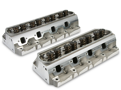

Man, those are terrible pics. I can't tell you if those are TFS heads- pre 2001 do not have any markings on the front - after 2001 it will say TFS or Twisted Wedge. p.
So what does this fella have to tear off and where and what "markings" does he need to look for to determine exactly what heads he has? I'm guessing remove upper/lower intake and valve covers aka cylinder head covers?:droll: Oh and the whole fox and Camry thing was just to give the guy something to compare to. I wasn't dissing the fox necessarily. However, it still chaps my azz that ford was kinda on the wimpy side compared to their foes until now and I need $40k to get a v8 or $30k for the girl model.

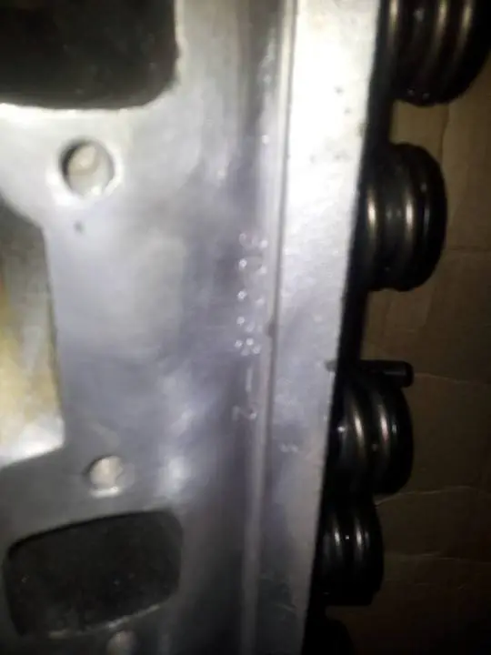

Here are some pics of early casting TFS heads. no markings. You can simply look at the ends of the heads- hopefully they say TFS, AFR, Edelbrock- somethng. Some heads also put their names by the lower head bolts. At a minimum he can see if they are aluminum or not.
TFS puts the casting #'s on their heads in the middle of the head on the exhaust side. You have to remove the header to see it.
Pre 2001 heads- no markings on the ends
After 2001 you should see that on the ends of a TFS head
